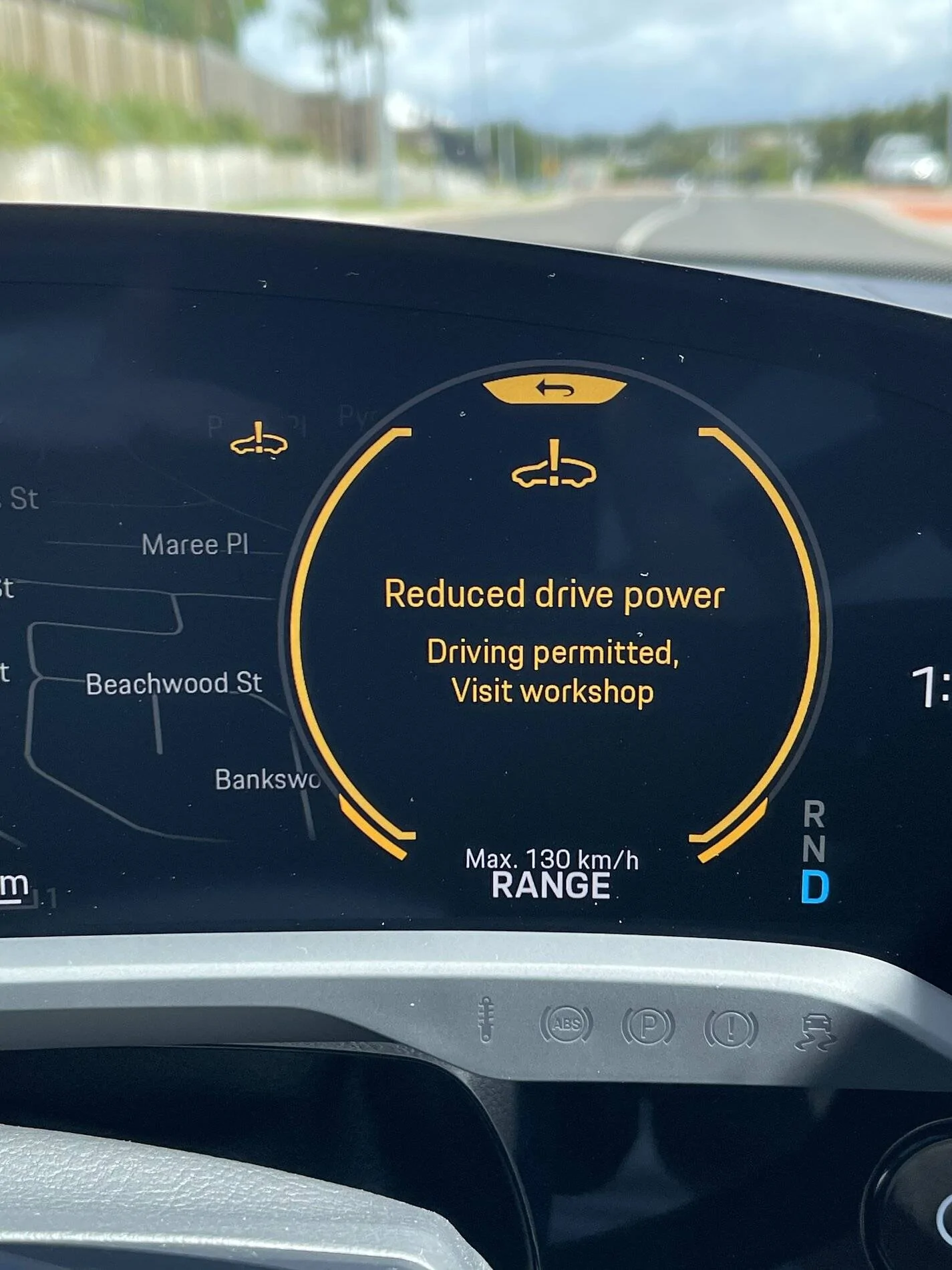

Has anyone had this issue?
tried the launch function for first time, launched ok then completely lost power and would not drive.
Showed the error Reduced Drive Power.
Was in Sports Plus however pic shows range as i tried different modes after pulling over to see what would happen.
I had to turn car off, lock and reset and then drove with no problems. error has not returned.

I believe that you need to think of the car as a computer and every once in awhile you will see the car doing wonky things. fortunately for you this appears to be one of those situations.
using my years driving teslas as a knowledge base when encountering an odd message I would restart the car, reboot the car and see if the messages cleared, then you could call into tesla and have them review the logs to see if there really is a cause for concern, I do not know if porsche offers that capability. in your case since it went away I would breath easier but I would swing by the service shop and let the porsche techs go over the car.

Thanks mate appreciate it.

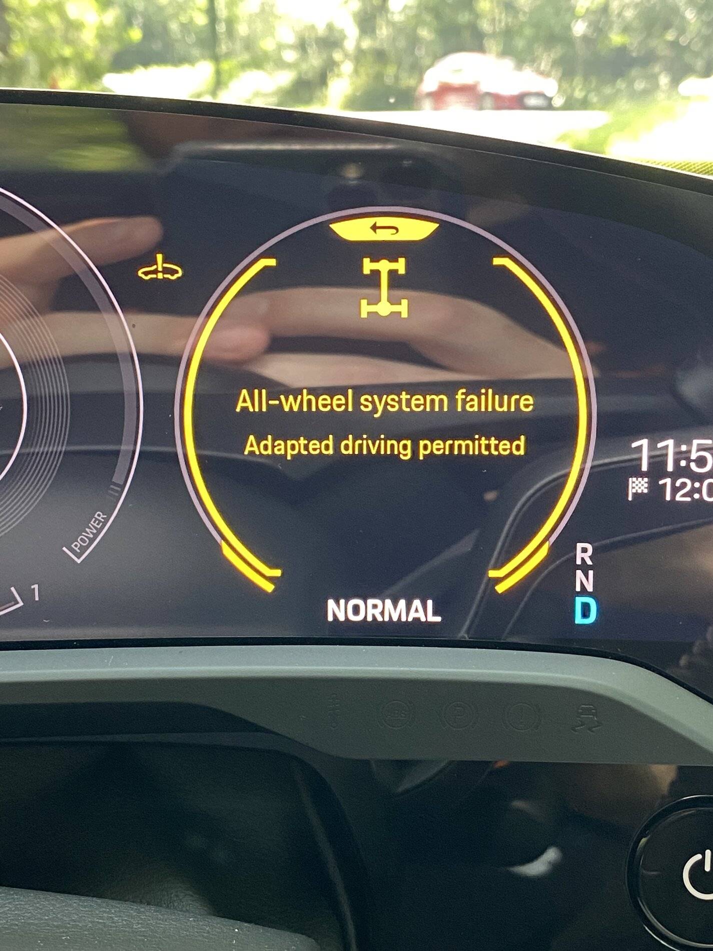

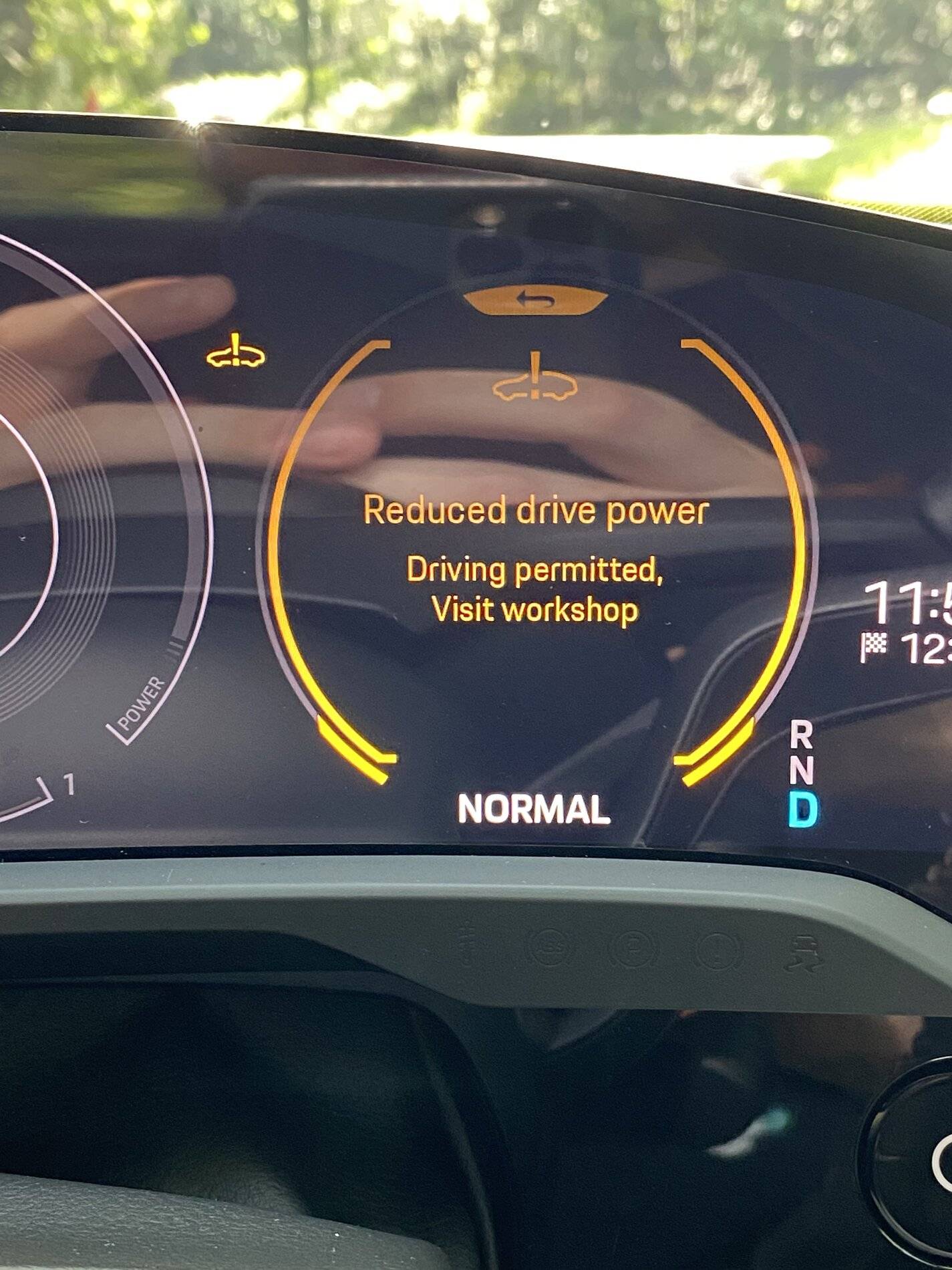

I just got the following two errors after doing a launch control, I ended up with no drive power whatsoever and as a result was stuck parked on a country lane in an unsafe position.
Car is fully updated with the latest software version.
As above a restart of the car resolved the issue and we were driving again, but I don’t feel particularly safe driving this car.
MY2021
Has anyone heard any further information about a fix from Porsche?
