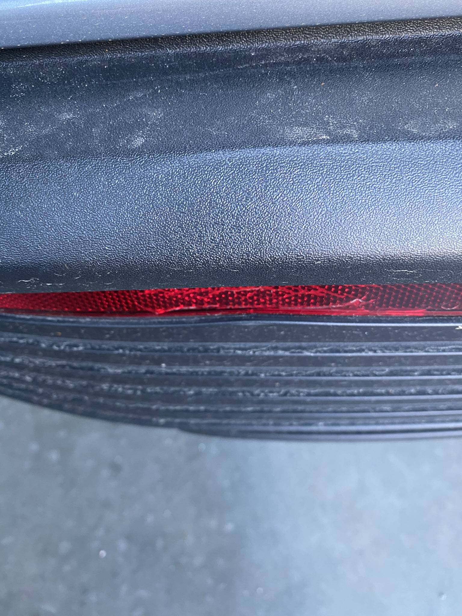

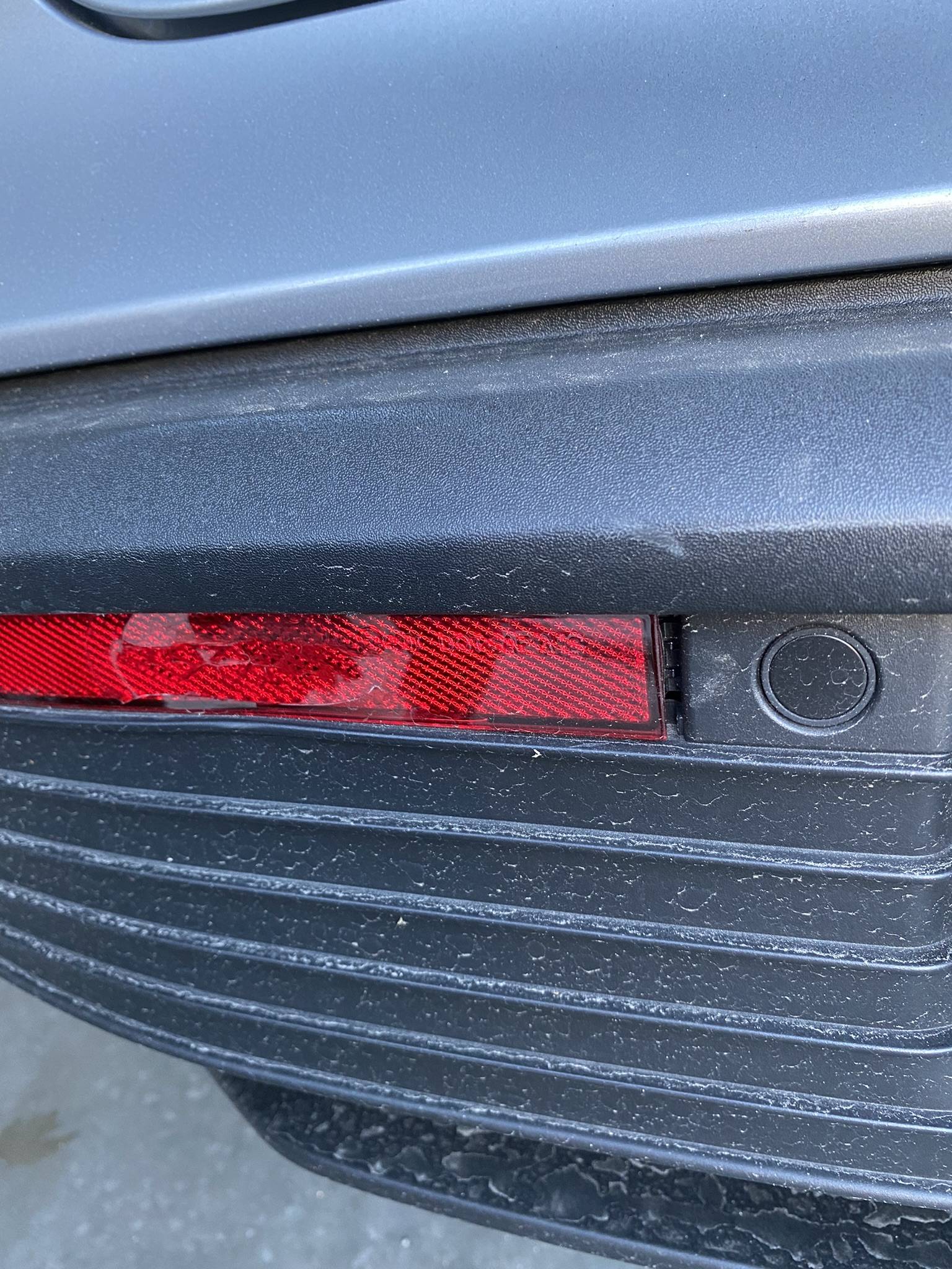

Hello! Unfortunately someone hit me at a stop sign in my 6 week old 4S. Very fortunately it felt worse than the damage. It was a Jeep Patriot and the tow ring pushed in the rear reflector. I see sun coast has them, but wondering if anyones removed these and can offer advice. I’ve seen threads about removing them, just not how to do it. Are the clipped, double sided taped, etc.
Would appreciate any insight. Thanks, Paul

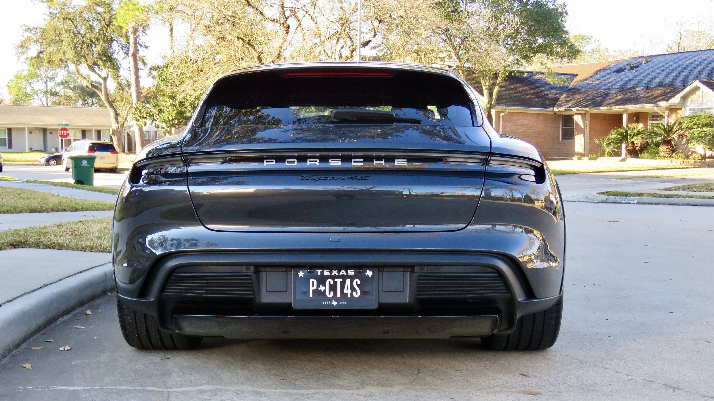

They are clipped in (unlike the side rear red reflectors which are held purely by TBH tape). You need to use a trim removal and start at the tapered end of the reflector - good idea to always tape up all around the edges before attempting should your tool slip etc. Takes a fair bit of leverage and you might think it will snap but it won't.
Here is a pic of my car where I removed rear and side rear red reflectors and replaced with painted (body color) ones I ordered from TAG Motorsports.

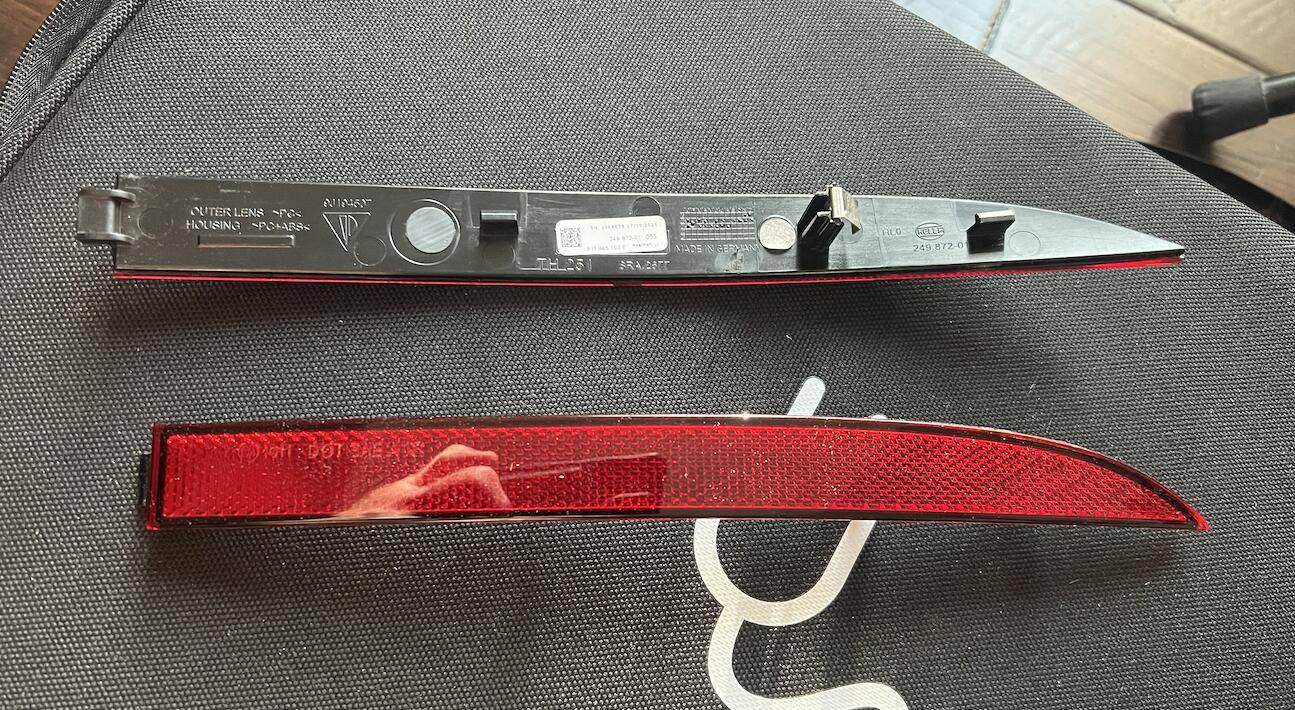

OK - here are pics of my removed rear reflectors - note the 'hinged'-like tab on the squared end of the reflector - this is why you need to start to pry it out at the opposite tapered end of the reflector. ALSO you need to rotate each piece (along it's horizontal axis) out from the vehicle because those two small tabs on the back of the piece are 'grabbing' from the bottom up - so you start by prying the tapered end off and at the same time rotate your pull so that the base pulls out first (by rotating the horizontal axis clockwise) to release the two small tabs and once released the hinged tab on the squared end just pulls out. Clear as mud right :)
Lot easier doing it than describing it!
