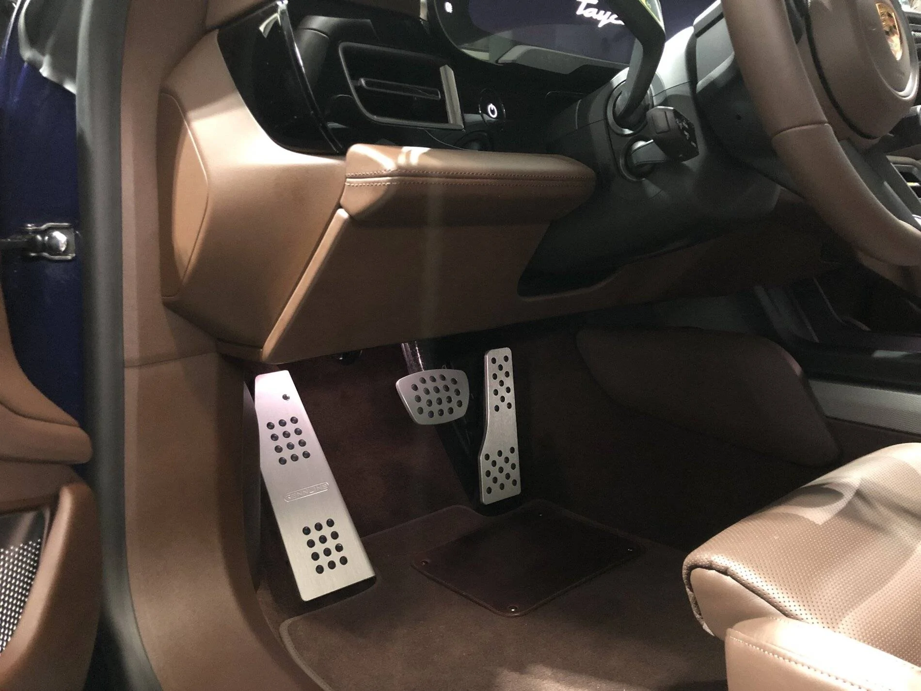

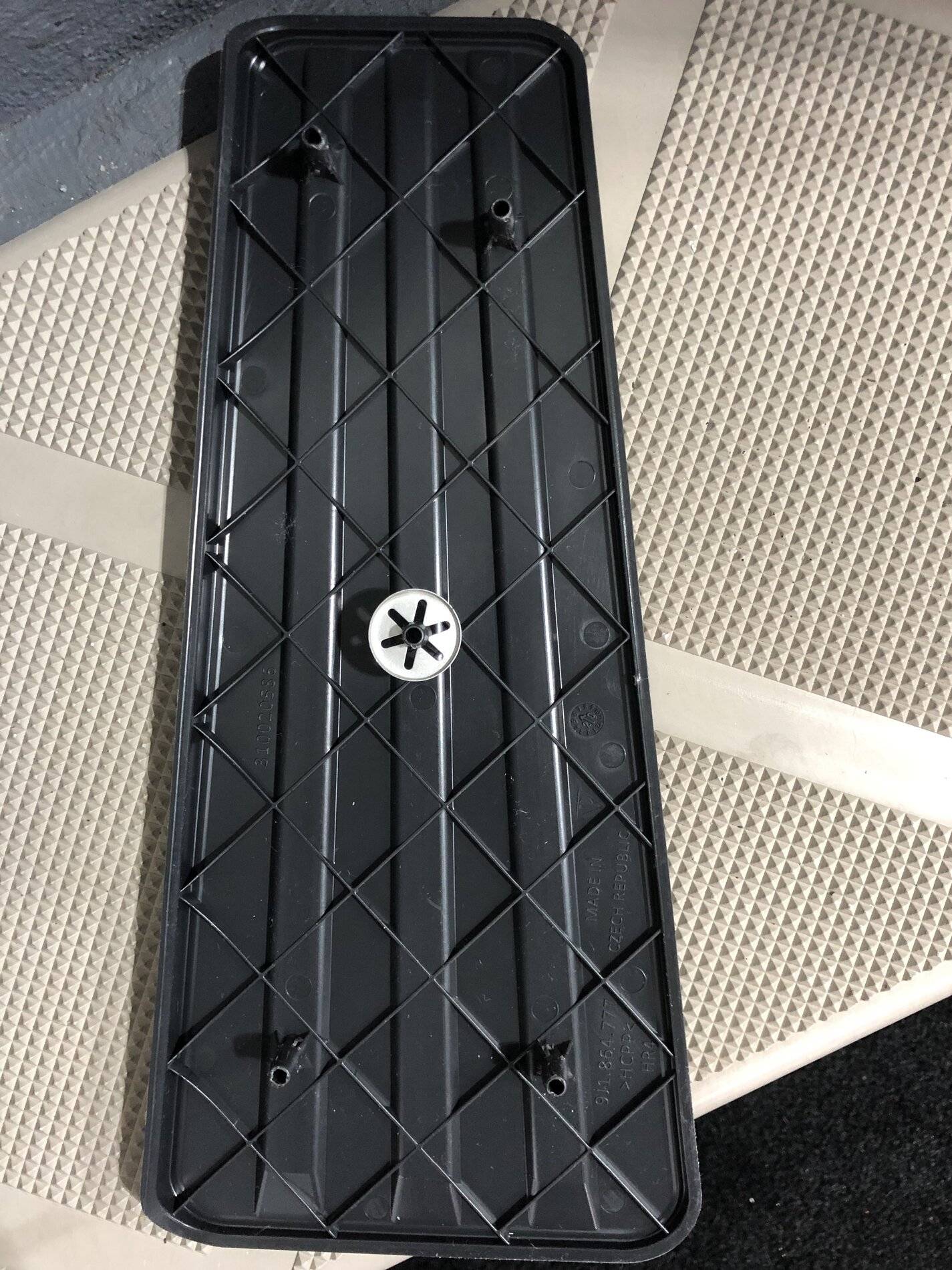

Installed some Rennline Aluminum pedals- used the Panamera set since none are available for the Taycan. The Gas and Brake pedals fit exactly, the dead pedal was not the same size and was very difficult to do. The original Porsche dead pedal was a simple piece of black plastic held on by push nuts from the back. The dead pedal support itself is a block of hard foam (3 or 4 inches thick), bonded to the carpet with deep tunnels in the foam for the original push nuts. I was able to pull it back, separate the carpet in two spots where the original holes were and used an automotive barbed retainer in reverse (head under the carpet in those two locations) and then pushed the pedal down onto the push retainers through one existing Rennline hole and one added hole towards the top. Then I trimmed the ends of the 2 push retainers flush. They are very secure! I have been using them for the last couple of months...
