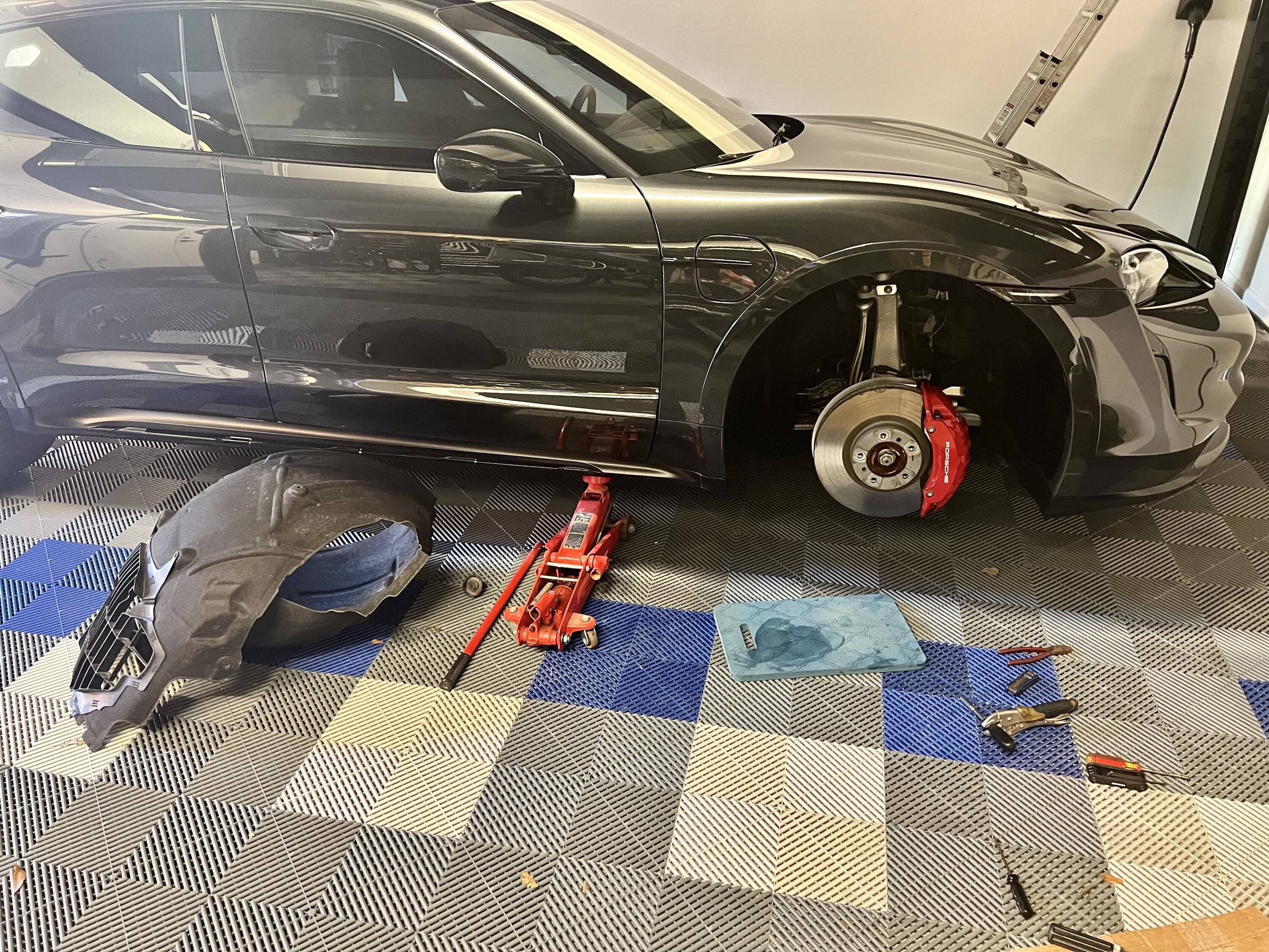

BTW, with the CT in Gravel mode and 'jack mode' on, when raised, its like working in the wheel well of a Jeep Wrangler - just tons of access :) I have a full 2-car lift in my garage but not necessary for this job:
August humidity, even at 7:30AM in Houston, not a recommended time to be crawling around in a garage! That wet mark on the knee pad from knee sweat :) - man I was dripping out there in a matter of minutes!

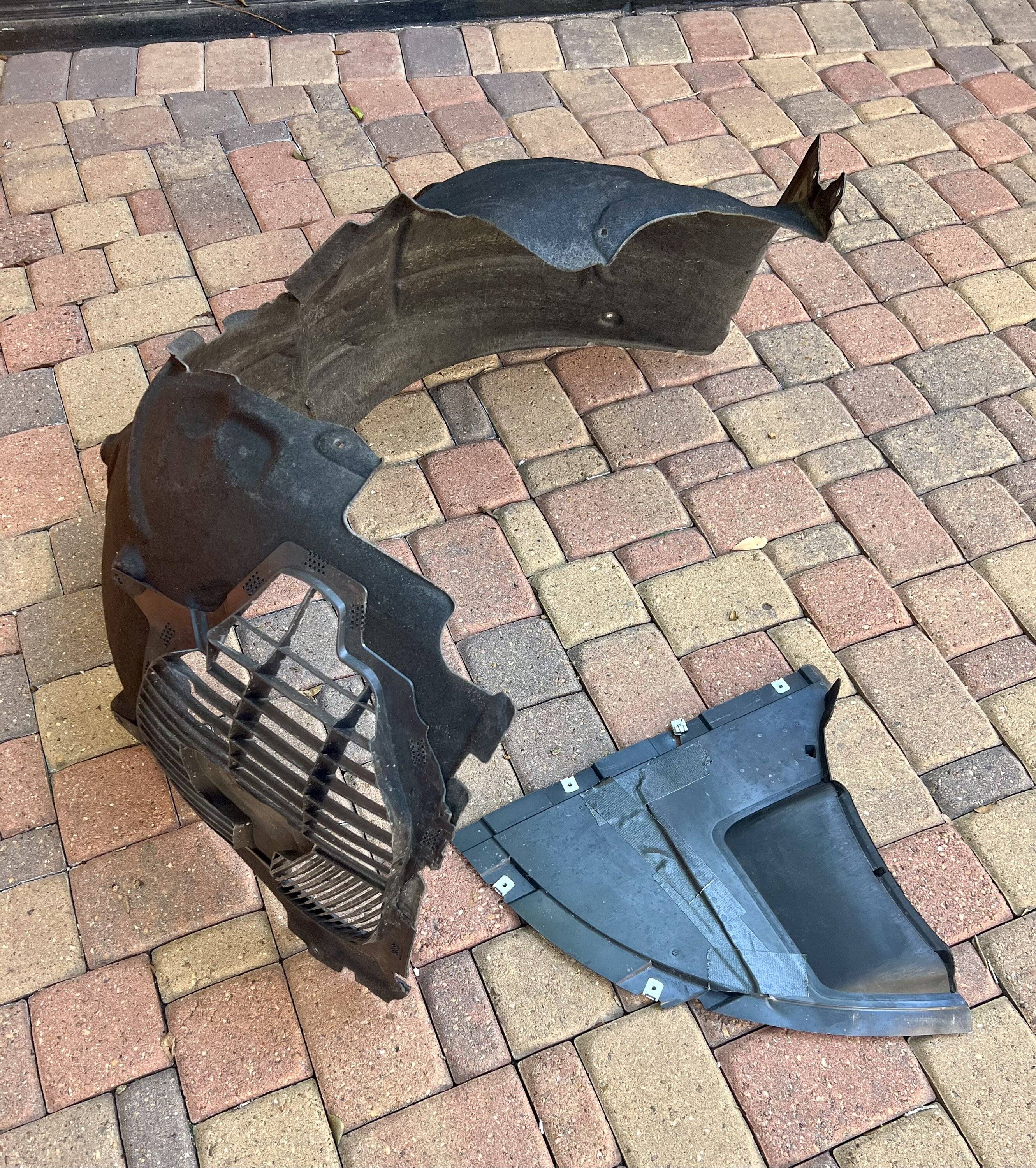

Removed parts - replacements are exact OEM parts - perfect - you can see the tabs that held screw holes are yanked off the old wheel liner - more obvious in next pics and you can see my duck tape temp fix on the smaller plastic cover which worked fine whilst waiting for parts to arrive :)

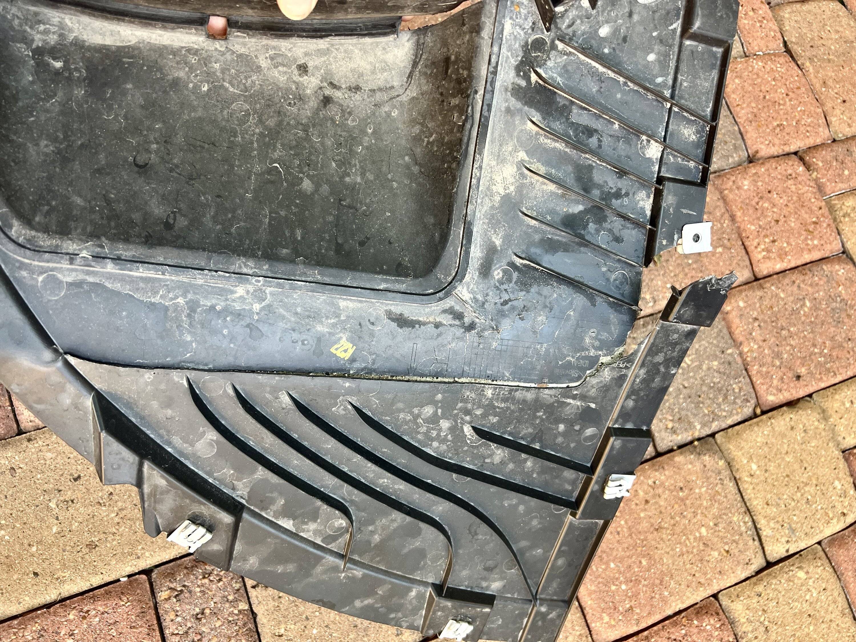

I bent the basal cover piece here to highlight where cracked - impact was on RHS (other face) of this image by the broken section, and a straight failure crack then propagated to left

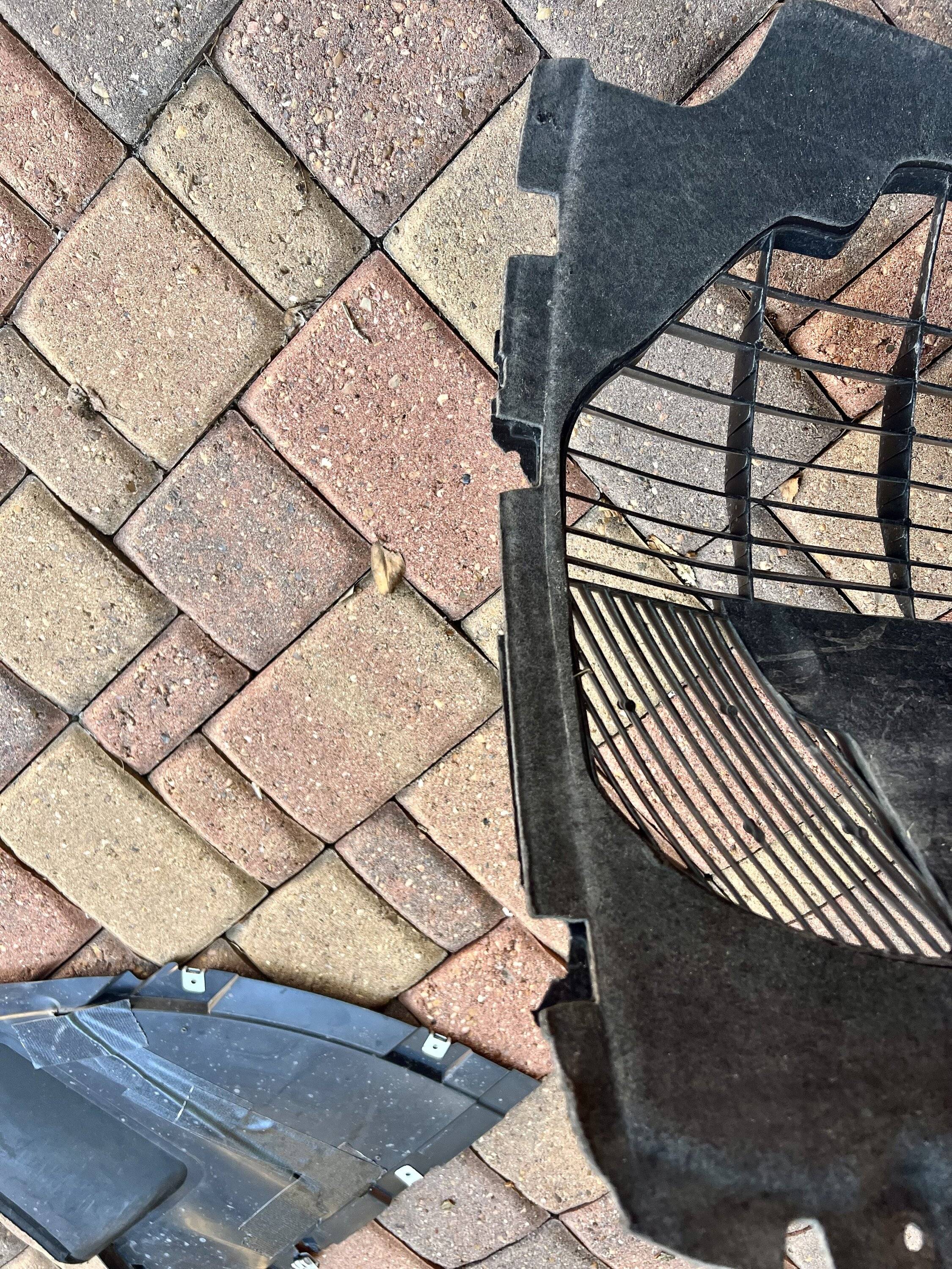

Better view of where the felt tabs were sheared off on the edge of the wheel liner - this was the only damage to this part but better to simply replace given minimal cost but primarily as the basal cover uses these tabs to be secure.

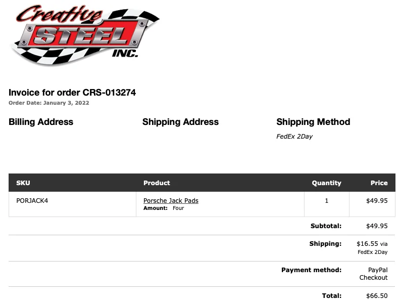

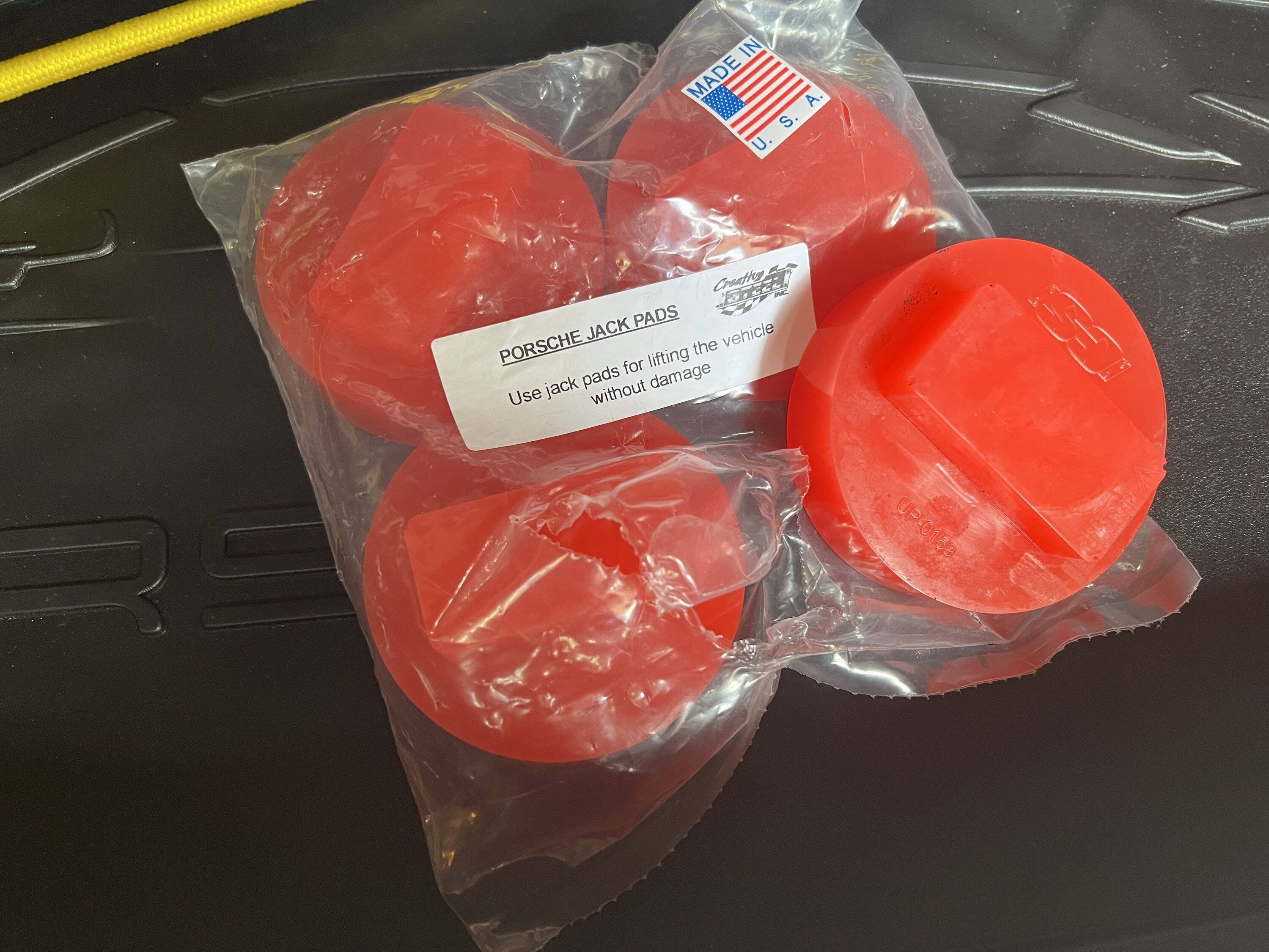

which jack pads are you using? You said custom, did you do some mod on them before using?

They were promoted here by a forum mbr. last year - company called Creative Steel makes them - bought mine Jan this year :
Pic:
