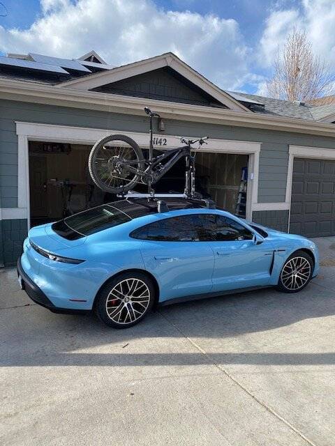

Take a look at this tread:
I decided to take thanksgiving week off, so I wanted to adventure in the Taycan. My kids are older, and have other plans, so I figured I would take the mountain bike to Vegas to ride around on the west side of town since it will be in the low 70's. I had 20' Pirelli Scorpion Winter's put on my 4s this week, so I feel more comfortable driving through the Colorado and Utah mountains in those instead of the Conti all seasons that came stock on the vehicle.
I installed the roof rack this morning - it has been gathering dust on the garage for a couple months. And, I installed the Thule ThruRide carrier to hold my electric mountain bike. I did a shake drive drive around town and hit a few more bumps in the road than I usually would to make sure the system was securely holding the bike. Tomorrow will the interesting day since I will be driving almost 800 miles through high mountains with a big mountain bike on the roof - I will keep an eye on how range is affected in the very cold higher mountain temps, and by carrying a big bike on the roof. The good thing there are plenty of Electrify America locations between Denver and Las Vegas.
Just in case no one has seen what a mountain bike looks like on top of a Taycan, because until today, I had not, I took a couple of pictures to share.
If anyone sees a big, weird guy driving a Frozen Blue 4s with a big electric mountain bike across Colorado, Utah, Arizona, or Nevada over the next week, please don't hesitate to say Howdy.
