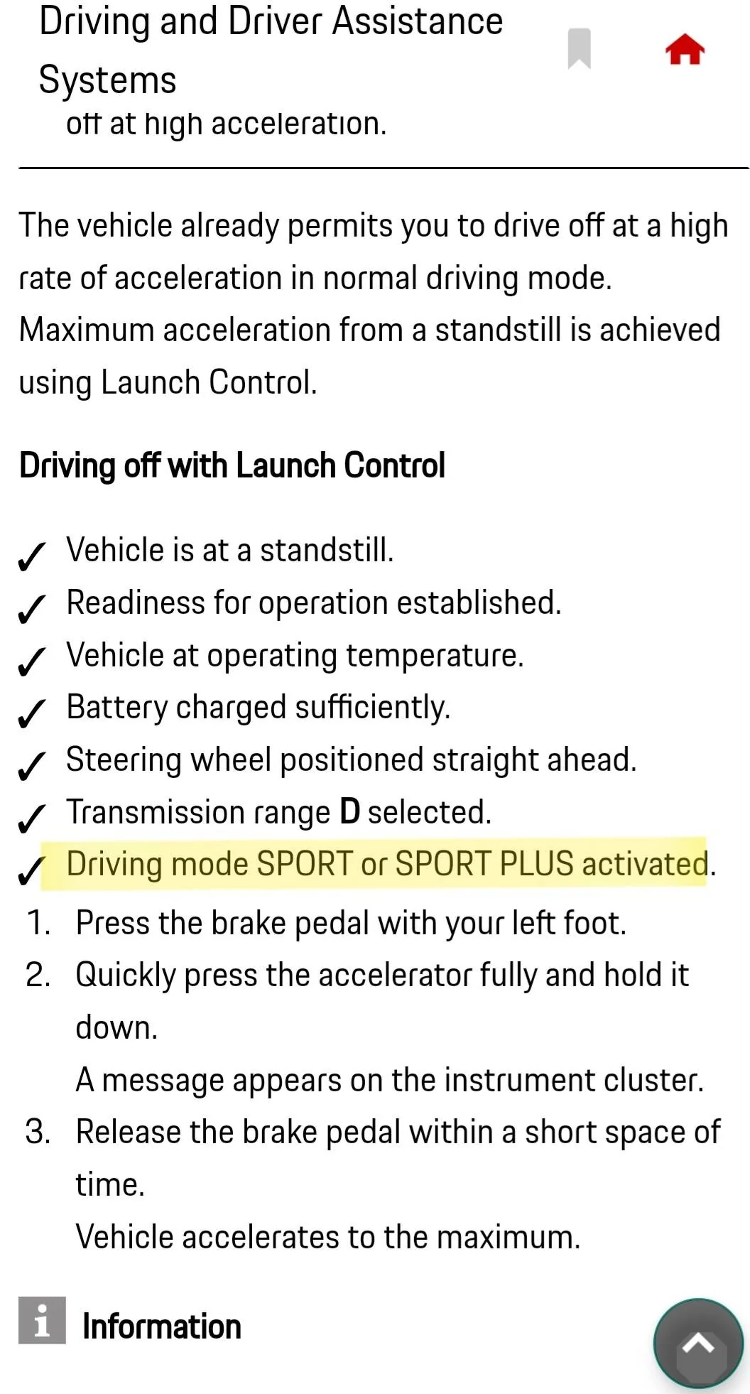

Fish Fingers
Fish Fingers
Ian
Feb 20, 2021
49
1,875
2,441
Cheshire
Taycan RWD
But sport plus has to be selected on chassis first, correct? It would be nice when you position your feet for launch control that the car automatically acknowledge that and put it in the respective sportplus mode
My car is a RWD without Sport Chrono optioned.
It therefore does not have Sport Plus mode as an option.
But it still has the Launch Control option in sport mode.
Just floor both pedals in Sport Mode at a standstill.
