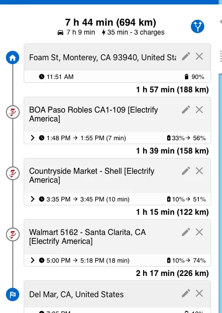

@daveo4EV can you tell me how to get an address from ABRP?
One showing in Countryside Market (Shell - EA) and one in Walmart Santa Clarita?
When I go to PlugShare I cannot find these specific locations....
I feel I am doing something wrong.
I want to plug the address into iCal then tell Siri to take me there on the way home.
Thanks!
Thanks!
no I don't know - I tend to find the charger locations from ABRp in google/app maps once ABRP has identified the general area…combination of plug-share and apple/google maps will tease out an address for navigation way points.

what city is teh Countryside Market Shell EA?
This is why I think I am doing something wrong. ABRP doesnt give me the address for Countryside Market. I am on a laptop. Is there a phone app that would be better?
show me the map route - that will get us the general area - if it's routing you to Santa Claritia I think it's taking you from Paso to I-5 and not 101 - I mean it will work - but that's not the nice drive.
Here is the route. Yes it is more I-5 but I thought on the way home we would take the fastest route. I think however it says 101 would be +9 minutes? And if so that's kinda a no-brainer for purposes of maximum value. Would you please take a look?

it's taking you here:
9741 S Enos Ln
Bakersfield, CA 93311
United States
I found the address by comparing locations visually from the ABRP map - and then just pinching and zooming the corresponding area in AppleMaps
there is an EA charger there...
9741 S Enos Ln
United States
160
5,810
8,645
here is the plug-share link
EA Shell Bakersfield
9741 South Enos Lane, Bakersfield, California, 93311, US
https://www.plugshare.com/location/209455
not a great reliablity rating - but recent checkins all seem to report it functional.
