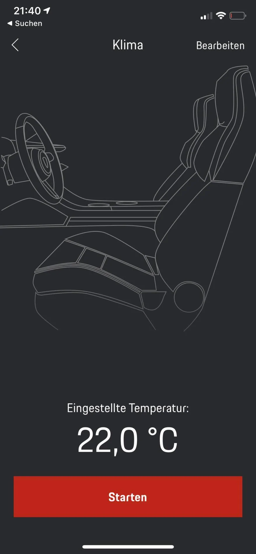

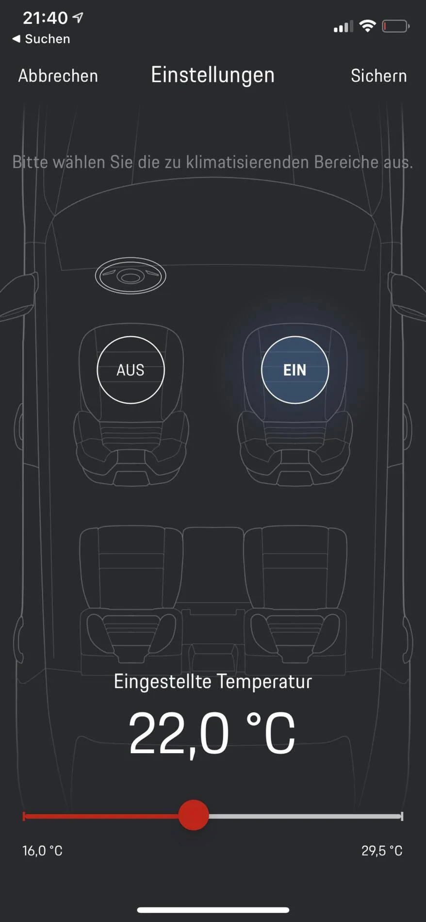

When you got to the connect app.
-> Climate
-> top Right ( in german bearbeiten)
-> then you can turn the preheating of the seats on or off individually driver and passenger

With the option turned off at the driver seat this seat does not heat up everytime I unlock the car and drive anymore.

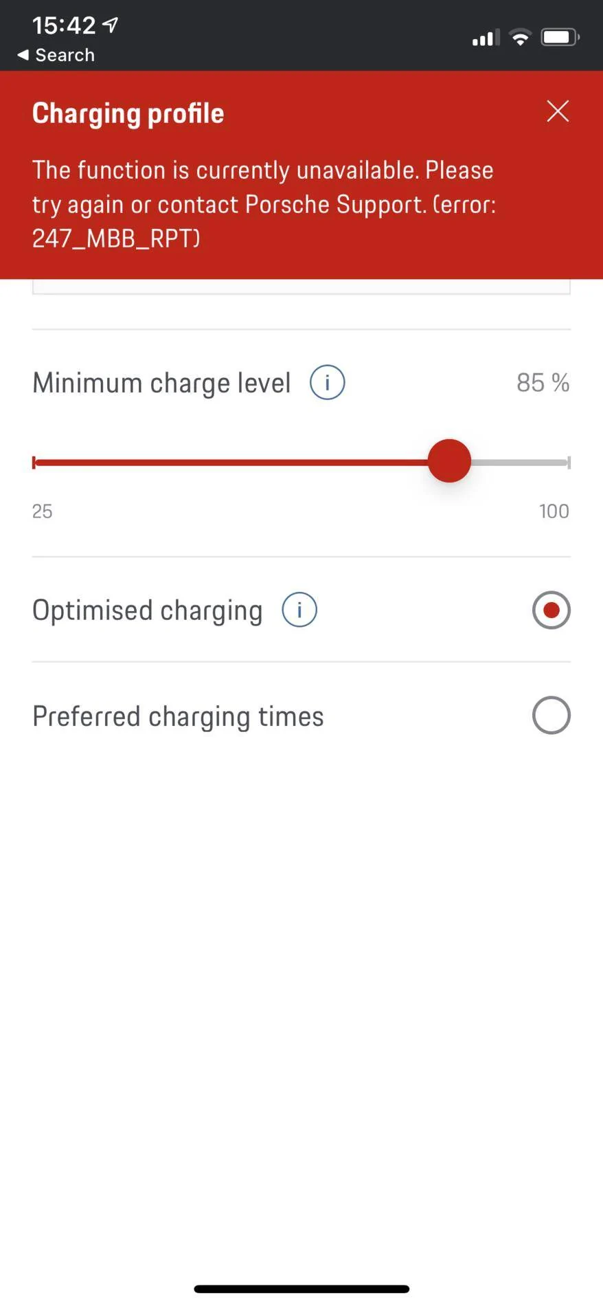

Anyone has this issue if you try and change Climate settings?
Happens each time...
I think that happens when your Connect app cannot connect to the car... I have this problem as my car is in an underground parking... There is WIFI there but oddly may car does not seem to have the option to connect to an external WIFI.
I am also having the heated seat problem and the car keeps wanting to warm up the car, despite having unchecked the boxes in the timer. As I am underground the car is never really that cold, but odd that I can not turn it off.
Hi - Did you set a PIN and load it into the car at collection? Is this the only Connect function that does not work?
I only ask because I know this aspect of setting up the car can be a bit tricky and for example the PIN needs to be set from a laptop or pc.
