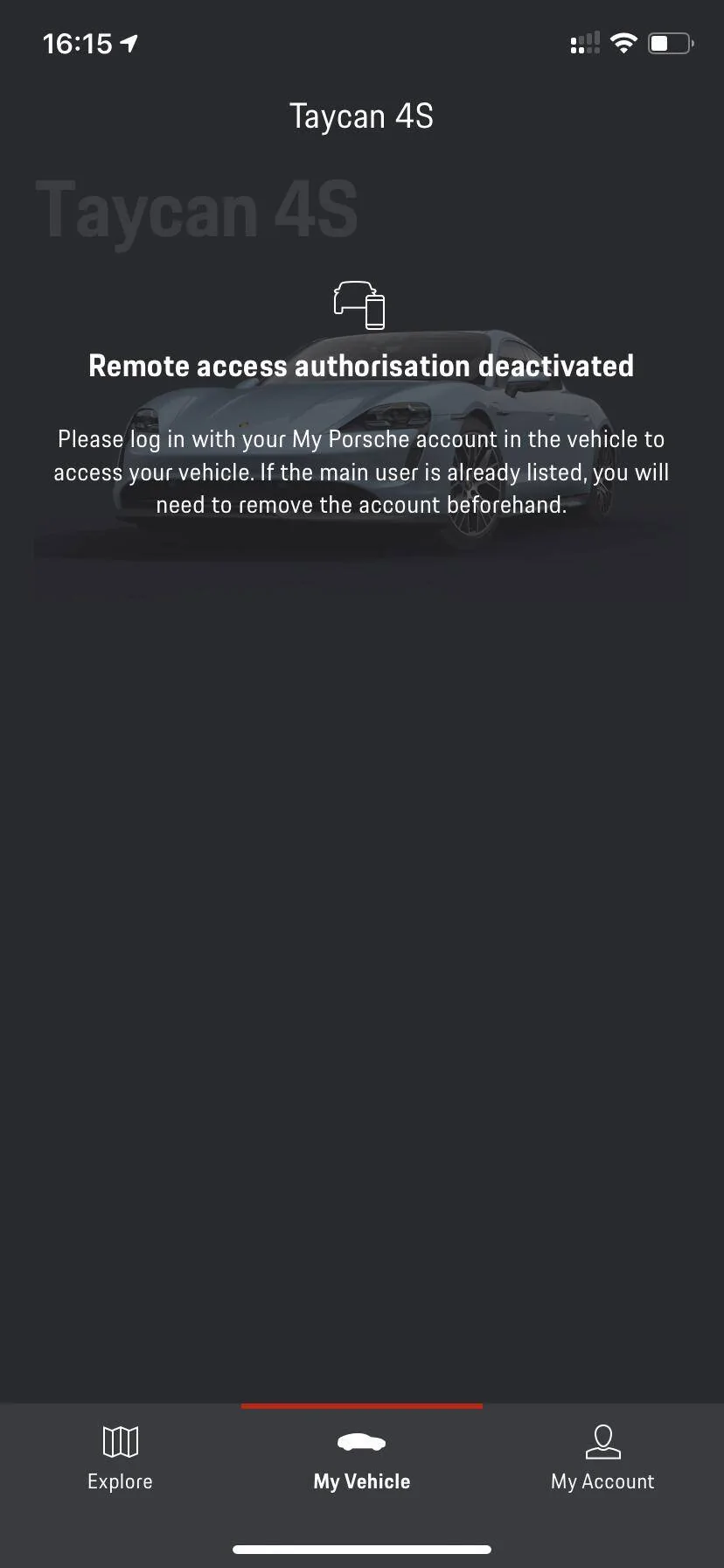

Hi All, new member from Ireland got my Taycan 4S last Thursday and loving it so far. Think it’s the second one to be delivered here
however suffering with a serious and odd bug ...
when I test drove the Taycan a few times each time I turned it on it prompted me to continue as guest (as I didn’t yet have a Porsche ID)
when I picked up my Taycan on Thursday PCM was down so I continued as a guest . The following day I got my email and registered but I can’t seem to enter my ID in the car.
When I start it it doesn’t show log in as anymore ?! The Porsche sales guy didn’t know how to fix it and have an appointment tomorrow but wondered if anyone on here might have an idea and be able to help me in the meantime
any help is greatly appreciated!
Best regards
Graham

COuple things:
1. Did your dealer tranfer the ownership to you? Until he does it on their side, it will not come over.
2. Patience. IT takes couple days for the system to be updated with your info.
If no luck by Monday, get your dealer to work on it.

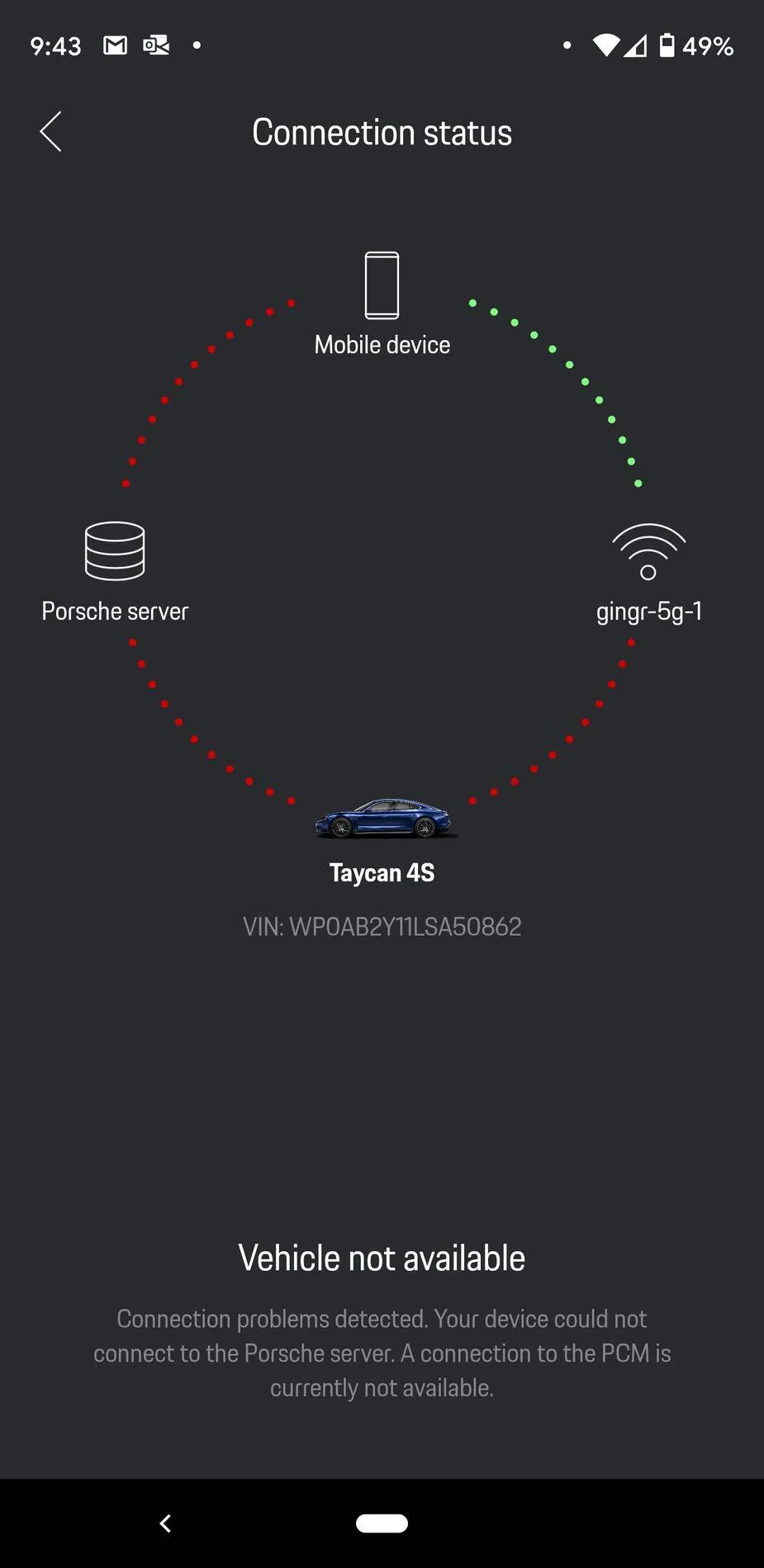

This whole area has been pretty unreliable since I got my car two weeks ago. It took me about 10 days to be able to log into my account in my car. Since then the Porsche Connect app often says the car cannot connect with Porsche servers. See attached screenshot. The car itself is amazing, but I do hope Porsche can figure this part out. It is very hard to manage charging if the car cannot connect to the Porsche mothership and in turn to the Porsche Connect app.
BTW, my dealership called Porsche while I was there and Porsche said they were very aware of the issues with their servers. There didn't seem to be much the dealership could do.
