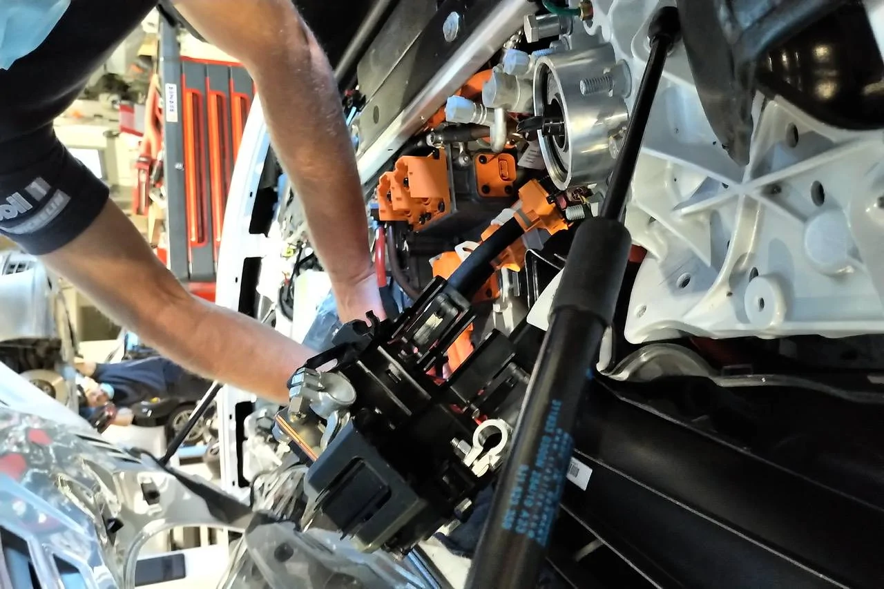

My car went in for the Update yesterday and was not finished today. They hope to be ready tomorrow.
Updates
WLD0 replacement of high voltage cable between the high voltage distributor and the electrical box
WLE3 replacing the onboard power supply battery 12 volt
WLG2 Software update of various ECU’s
WHL5 check connection of water drain hose and correct if necessary.
Much bigger job than they had planned for and here is a picture of the status this evening after two days in the workshop. Some great power cable alright!
