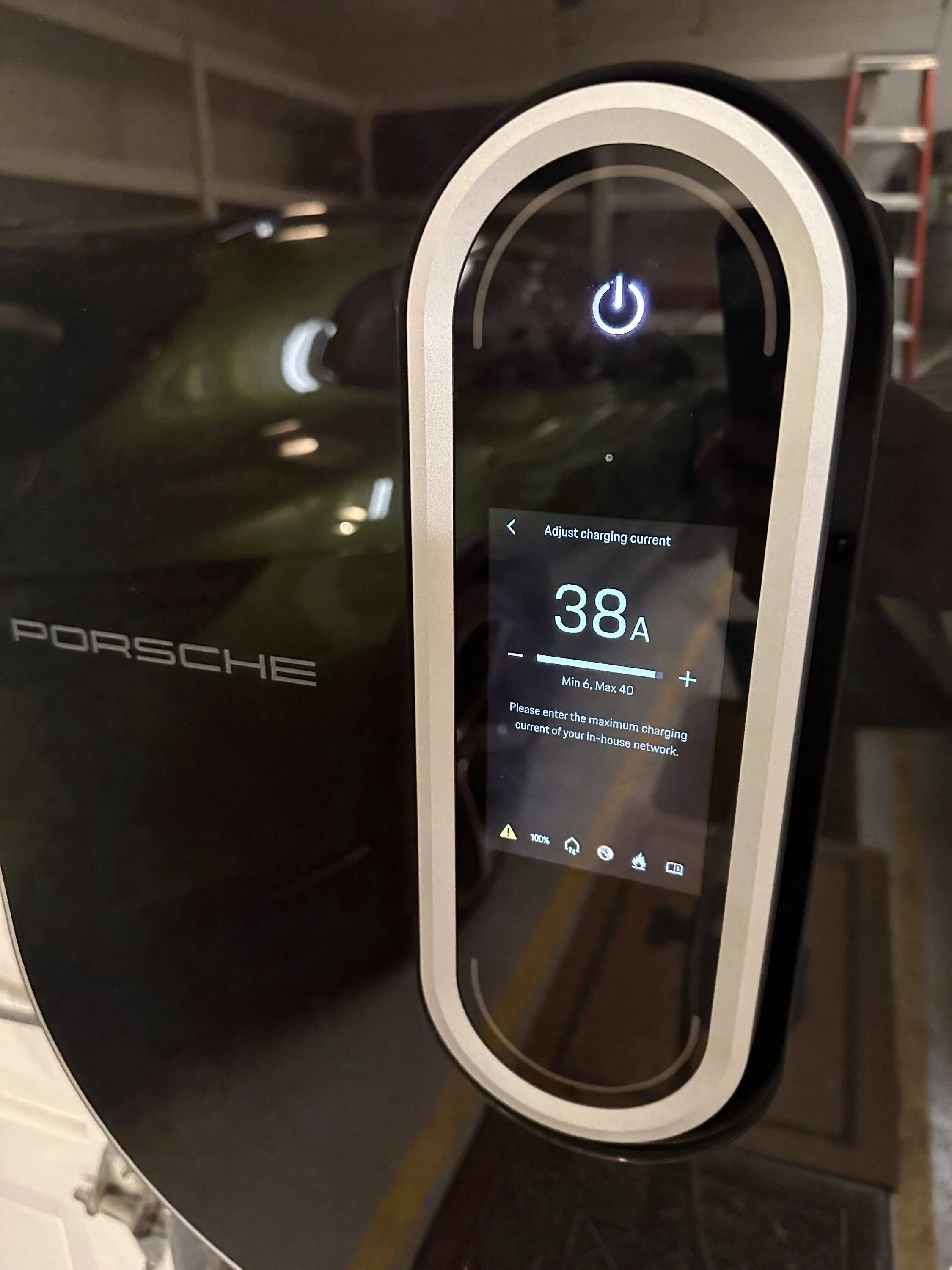

Thank-you for the clarification. My Porsche Mobile Charger Connect is connected to a service that is 100% to specification. I initially set the PMCC to 40 AMPS and it worked for 18 months without issue, until Porsche remotely updated the software. The software now forces the unit to 20 AMPs on each startup. When I manually set it to 40 AMPS (an unnecessary requirement), I now get errors during charging (that I never received prior to the software update). There is no excuse for this except that Porsche is trying to avoid liability by down rating their product below specification.
I don’t doubt everyone’s claims here about the software reset back to 20A, but I do not have that problem. Now, when I do get an update, it resets down to 20A, but all I have to do is adjust it back up and it stays there (for months) presumably until the next upgrade.
I did learn one “trick.” When I first got it, I set it at 40A and it would frequently error out and stop charging. Then I noticed that when it was set to 40A, it actually charged at a rate of 42A, which I assumed was the cause of the errors. When I set it to 38A, it charges at 40A and I have never received an error again.
