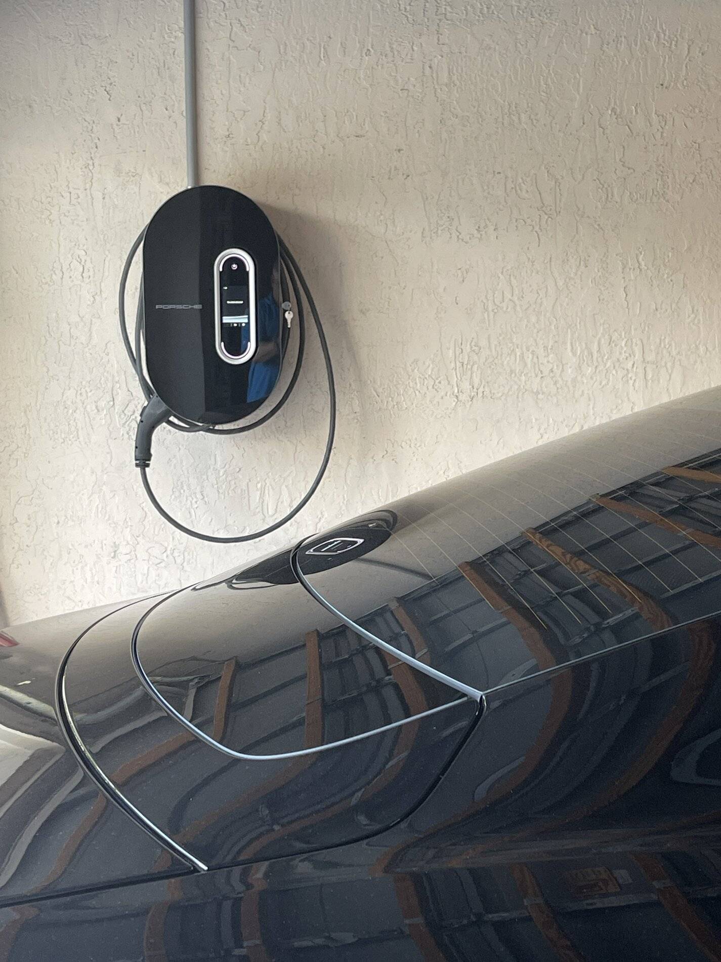

my Taycan in my home in the evening reports 8.96 kW when charging from the PMCC - and I can see the 9.6 kW draw on my power meter…
What difference do you see between your grid meter and your Porsche charger?

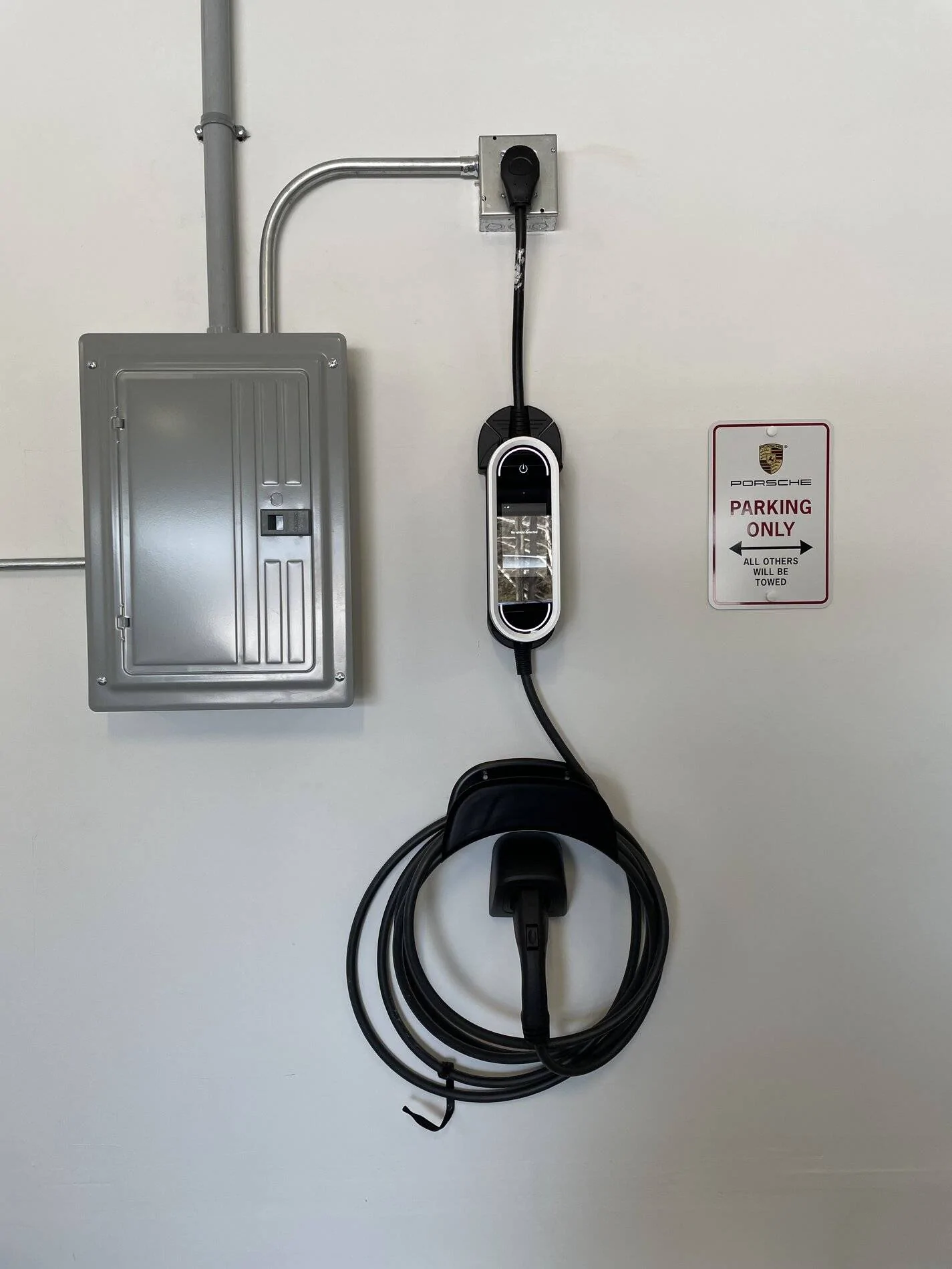

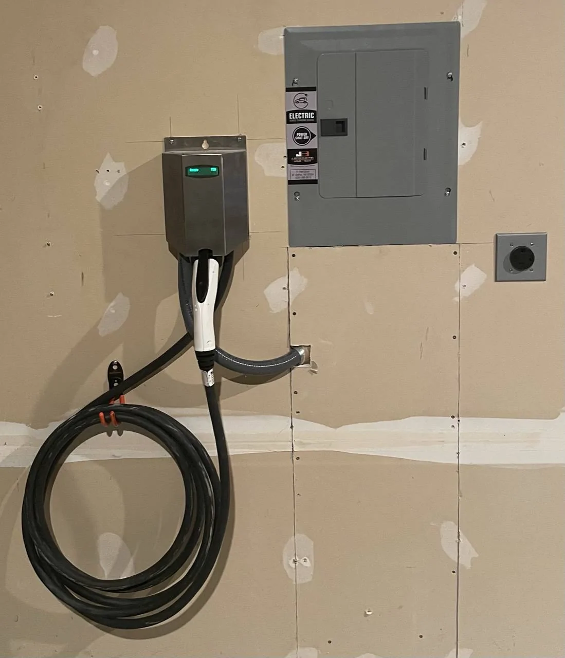

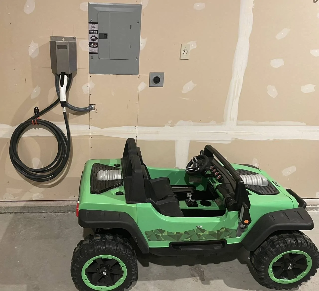

Added 125A subpanel to the garage.

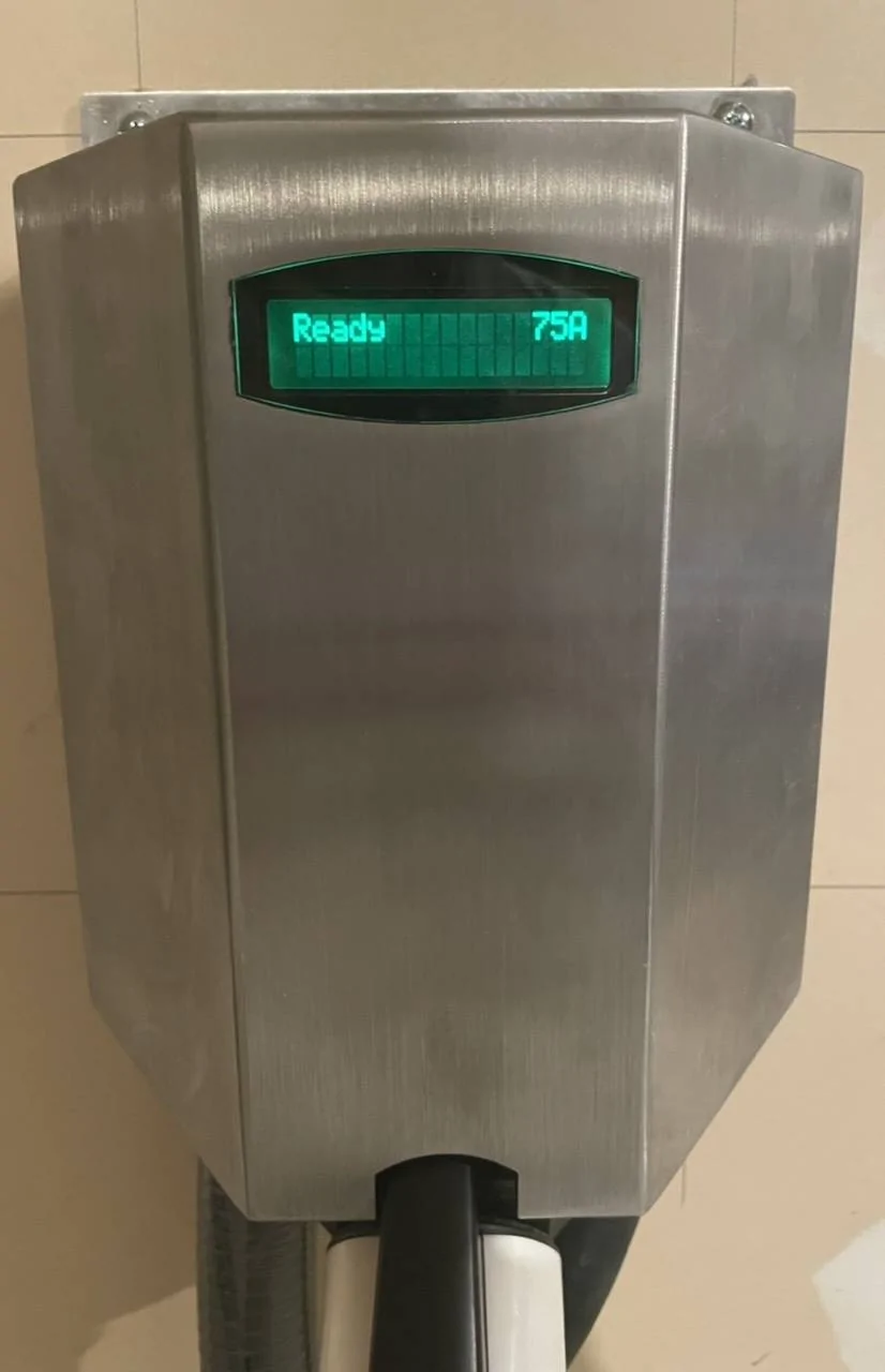

18kW Wall Wattz
75A 240VAC single phase
Plus a 14-30 receplacle
The receptacle is a backup for the main charger. I’m ordering a 14-30 supply cable for the PMC+.
If we get a second EV, I’ll also get a 24 amp EVSE to put on the 14-30 for a total charging capacity of 99 amps or 23.76kW which just about maxes out that 125A circuit.

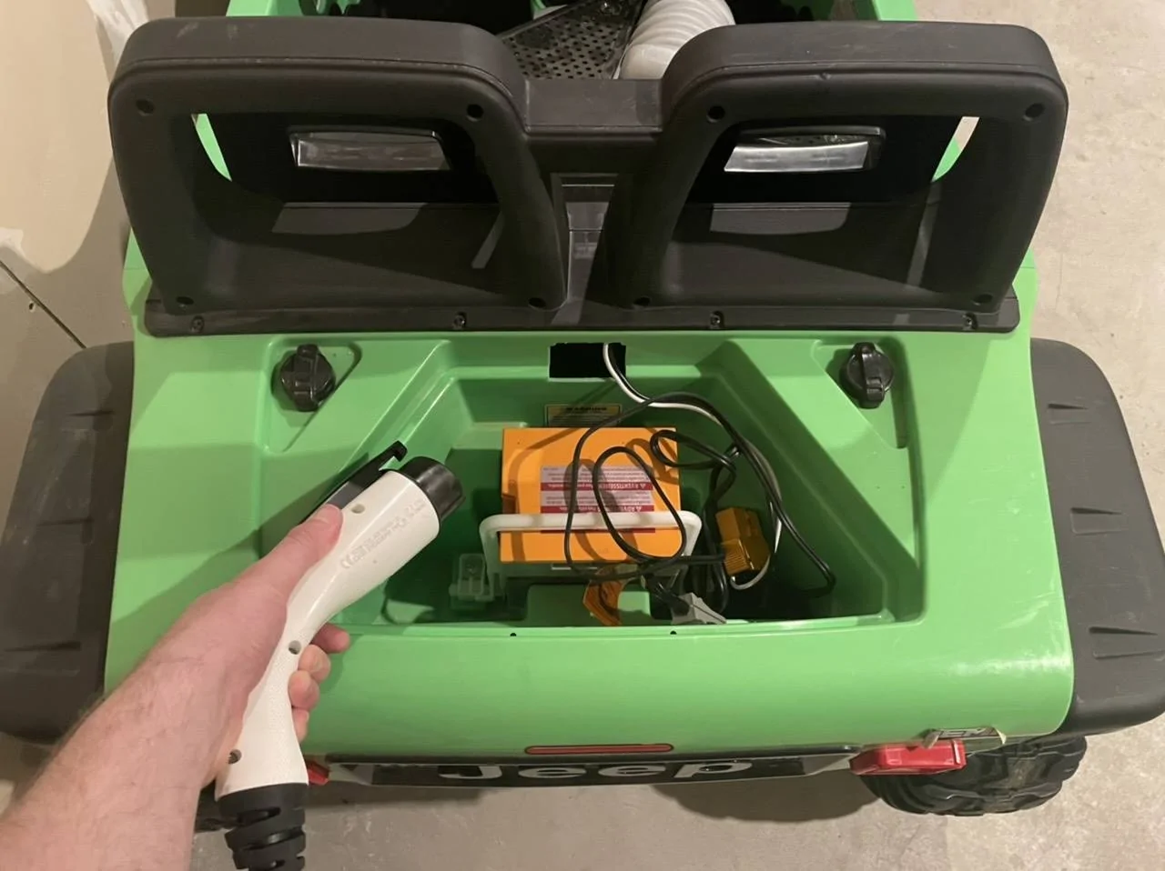

Now I just need a car...
My only other BEV uses some kind of proprietary connection. The J1772 wouldn’t fit. ?‍♂

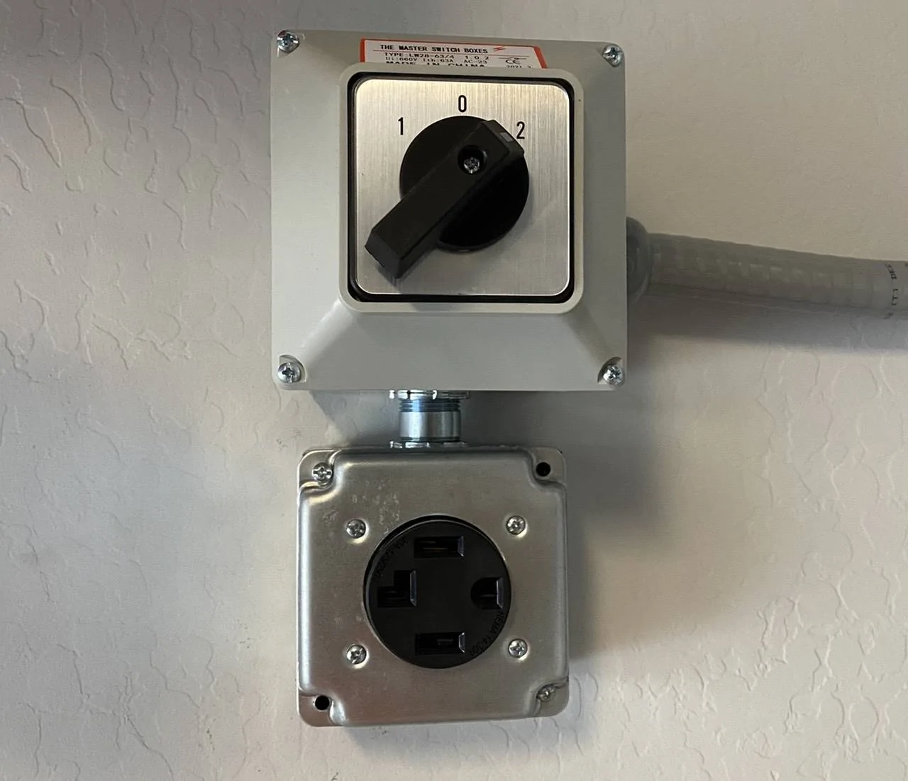

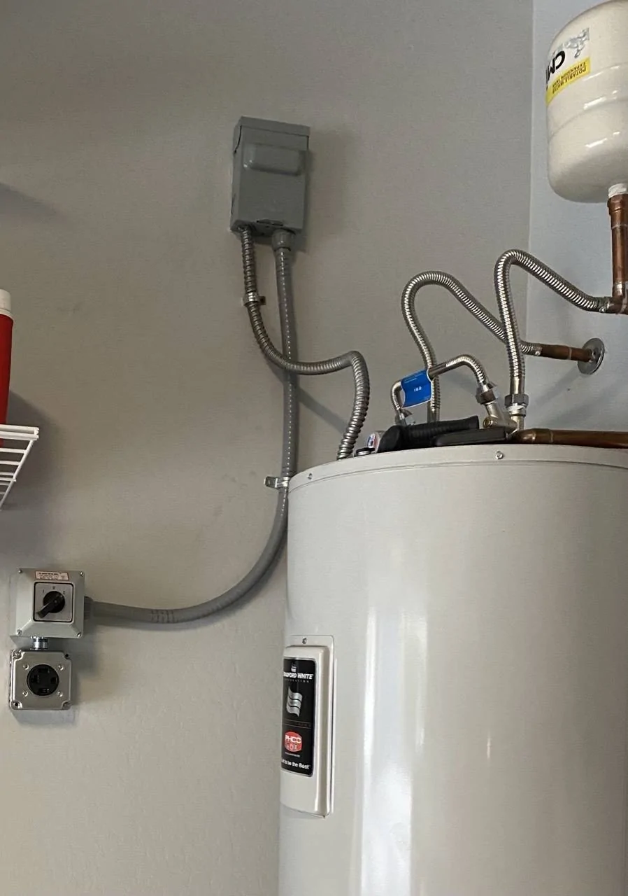

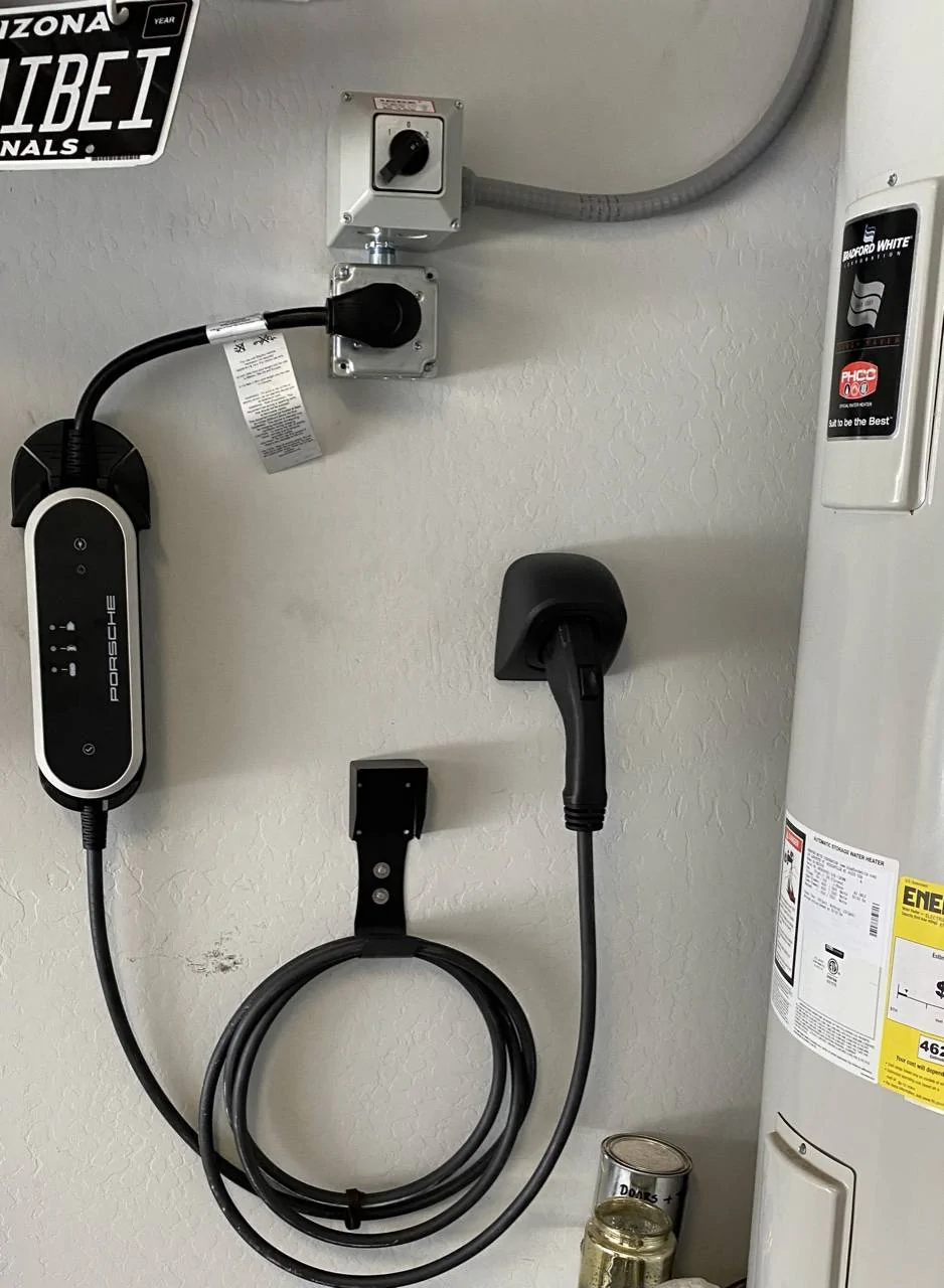

I explored running a dedicated line on a 50 or 60 amp breaker to my garage which of course would have been optimal, however it would have been a royal pain and expensive due to the location of my panel relative to the garage (extensive trenching.) My electrician buddy and I came up with a safe, shared solution with my sole existing 240V, 30 amp line running to my water heater as follows:
The live load is run through the AC disconnect box down through the conduit to the switch which then determines if position 1 is active to power up the 14-30 socket and charge the vehicle , or position 2 is active to send the load back up to the conduit and into the AC disconnect box to run the electric water heater. The design of the switch prevents both the charger and the water heater from ever running simultaneously.
I did consider the ramifications of powering off my water heater for a few hours at night, and it has been a non issue with an old school tank unit. We rarely use hot water after 8 PM on almost any given day, the water heater is able to recover spent hot water within an hour, and once the water is hot the tank can keep it hot for 2-3 days...especially in the hot desert AZ summers. The most economical time to charge per my electric company EV plan is from 11 PM-6 AM, so the water heater is just off every night. Basically, just need to switch it back to the water heater every morning which is already part of the routine. For $150 in materials, and pizza for me and my buddy, I’m content with the set up.
The 5.8 KW charging rate (5.2 KW is actually the best the car registers after losses) may not be as fast as it could go, getting my 20-50% worth of charging to get back up to 85% while we sleep has been sufficient. With a new EA station powering up close by, I’m covered for the occasions when I need to replenish the battery more quickly.

Innovative solution! Any chance of converting your electric water heater to gas? Not now of course since you have solved your problem, but down the road when your hot water heater needs to be replaced?

You might consider a slight change to your setup by adding a Dryer Buddy:
https://www.bsaelectronics.com/collections/dryer-buddy-plus-auto
It would remove the manual switch and add an automatic switch. This would allow you to use profile/timer settings in your car and make the process “touch less”.
In your config you would plug the EV EVSE into the “dryer” plug, and the hot water heater in the “EV” plug, this way your EV has priority.
Sadly, I don’t have gas running to my house, but a good idea!
I actually looked into the Dryer Buddy right from the get go, however my water heater has no plug to begin with and is connected directly into the AC disconnect box as required by code. I suppose I could have spliced the water heater into a plug and explored further, but it would have complicated the setup.
Correct. The dryer buddy is for dryers that have a plug and it is not meeting code requirements for an A/C or Water heater 30amp line that must be hardwired into a disconnect.
If you don't drive a lot you can also get a 120v charger (or use your PMCC) on a regular garage outlet. You can get 30miles or so overnight with 120v 15ams and even more if f you keep plugged during the day. Then you would only need to switch when you need more. If you do that make sure your 120v circuit is grounded and no other big loads run on the same line
Once derated down to 12 amps continuous and crunching the numbers, the 5-15 outlet option just seemed like it wasn’t a long term solution, although I could see how it could help with constant plugging.
At one point I considered upgrading one of my 5-15 120V outlets to a 6-20 outlet for the extra amperage as it would be super easy, cheap, and garage outlets are often already on a 20 amp breaker. The included Porsche charger can’t make use of that plug type along with the extra amperage however.
