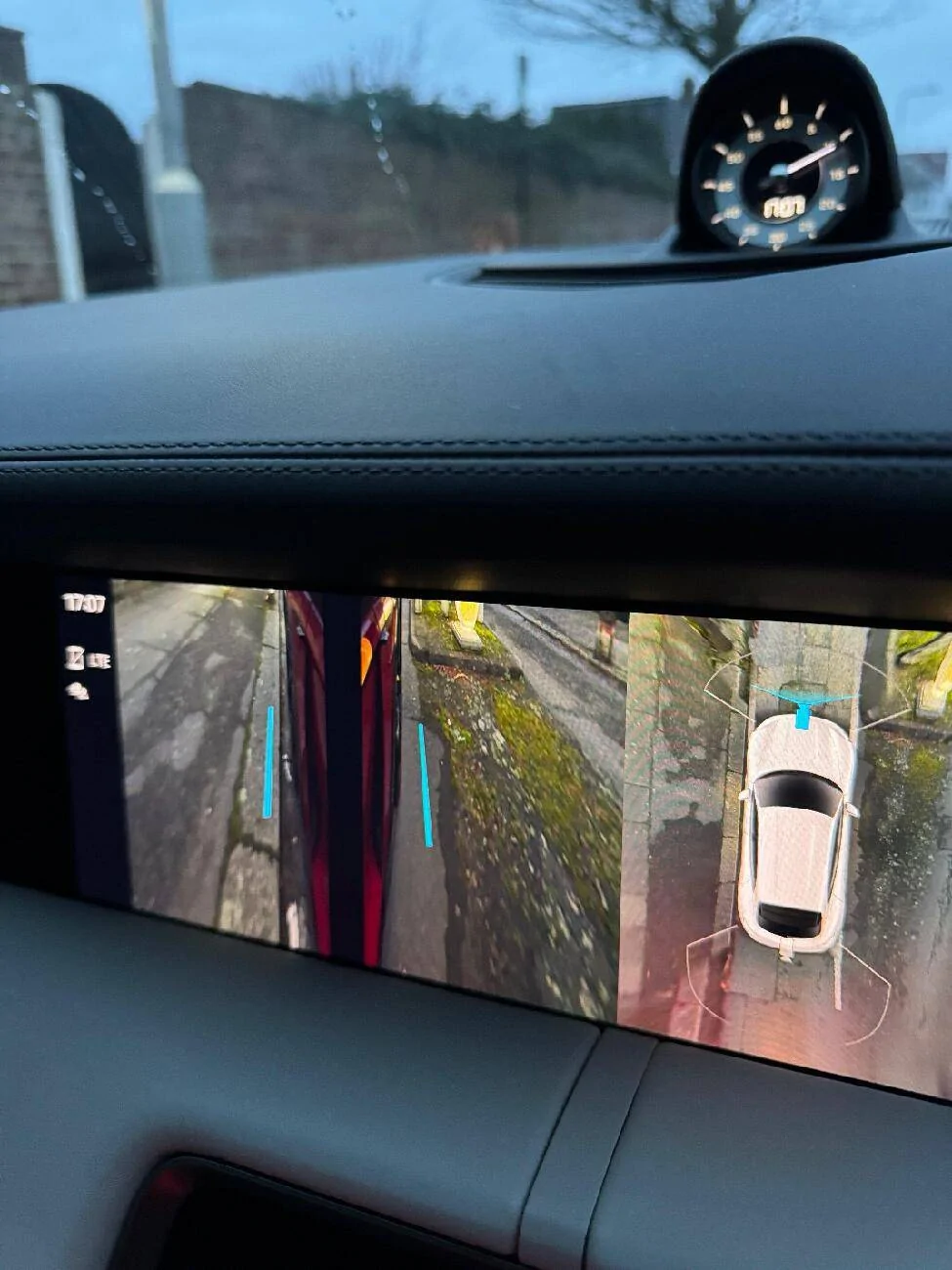

This is how the camer looks if you are one of the lucky ones that have it:
Porsche Taycan Sideview cameras view missing WhatsApp Image 2024-03-02 at 15.54.21_8ea125c0
Porsche Taycan Sideview cameras view missing WhatsApp Image 2024-03-02 at 15.54.20_2c268690

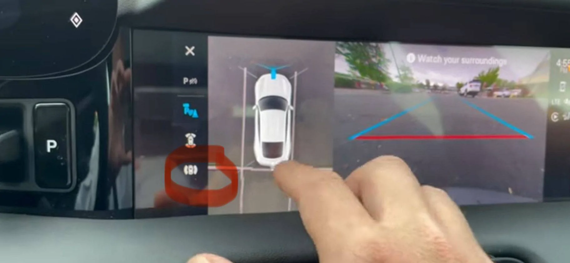

MY2020 cars that was specified with Surround View (without Automatic parking assist) receive additional sensors (see attached photo where I've marked those sensors with red). All cars having those additional sensors got the 3d surround view with additional camera views in the PCM.
Those two sensors was removed for MY2021+ cars speced without Automatic Park feature and hence does not have the 3d surround view feature either.
This should however for sure be a software thing since cars with Surround view have the necessary hardware. Porsche however decided to enable the 3d view software feature only for MY2020 cars where those sensors came with all Surround view cars.
