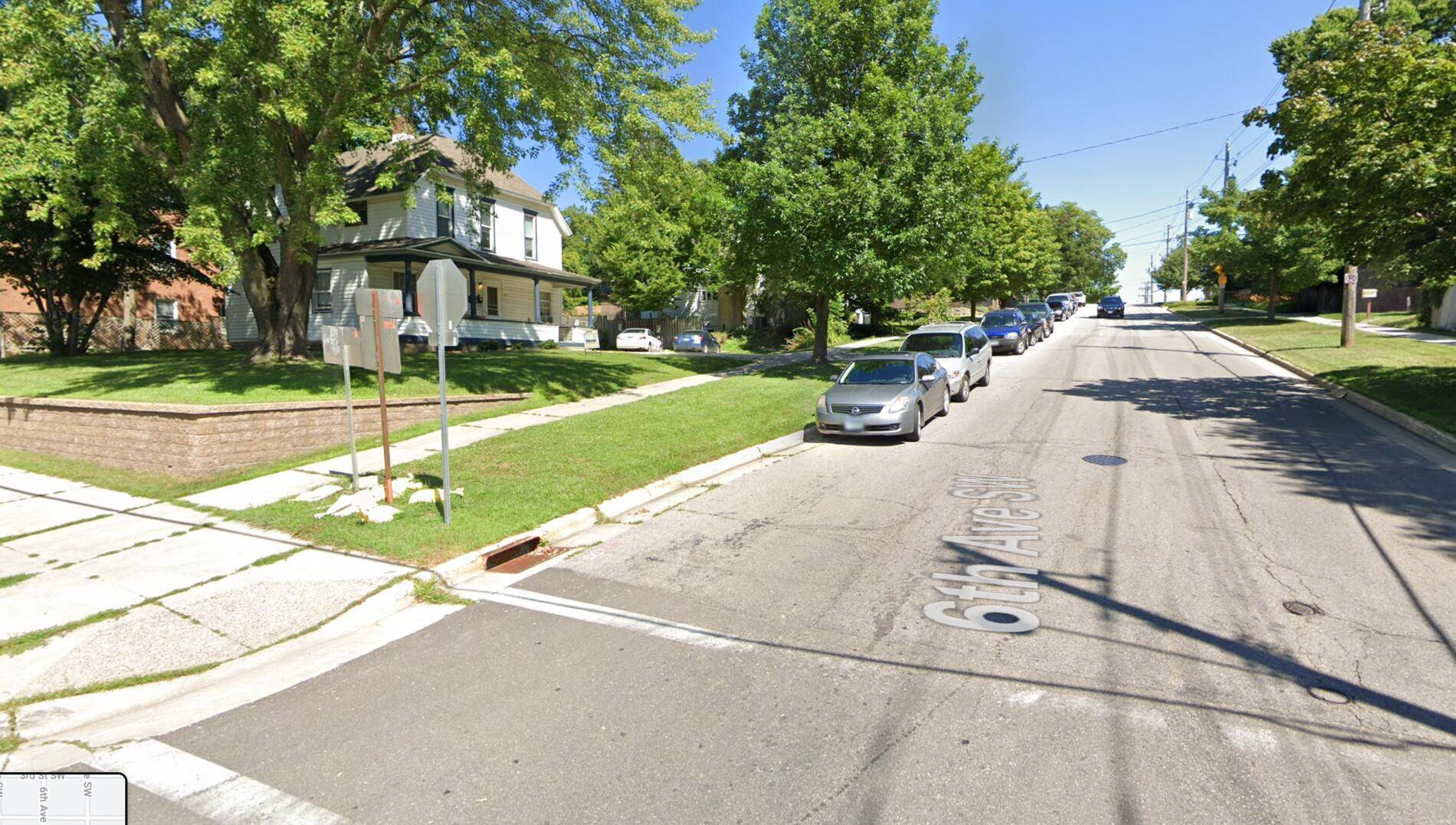

On my drive to work there is an area with a small incline - nothing fancy, see the picture. In a particularly cold winter stretch when no amount of salt could melt the ice, my winter-tire equipped AWD Tesla P85D refused to come to full stop, and continued to slide until I got into the crossroad on flat surface..... My take home message was that a very heavy car + slippery surface are no match for any AWD and winter tires - I guess that's why on "Ice-road truckers" they get chains..... I can only imagine what summer tires would do to you.

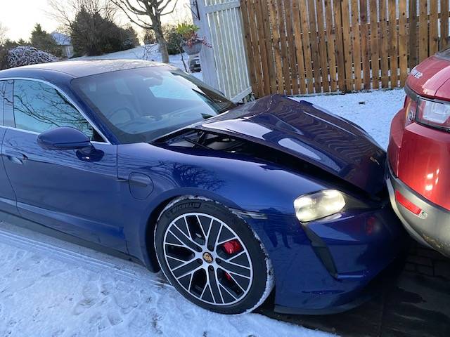

Parked Taycan slipped down the drive and into the back of my Mother's car.

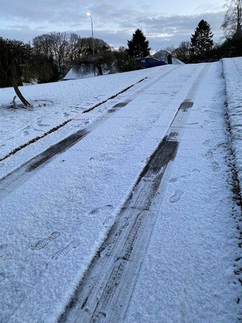

This photo shows where the Taycan was parked.
So it moved from that parking spot all the way down the drive.

Car at Porsche Glasgow. Call in to Porsche UK.

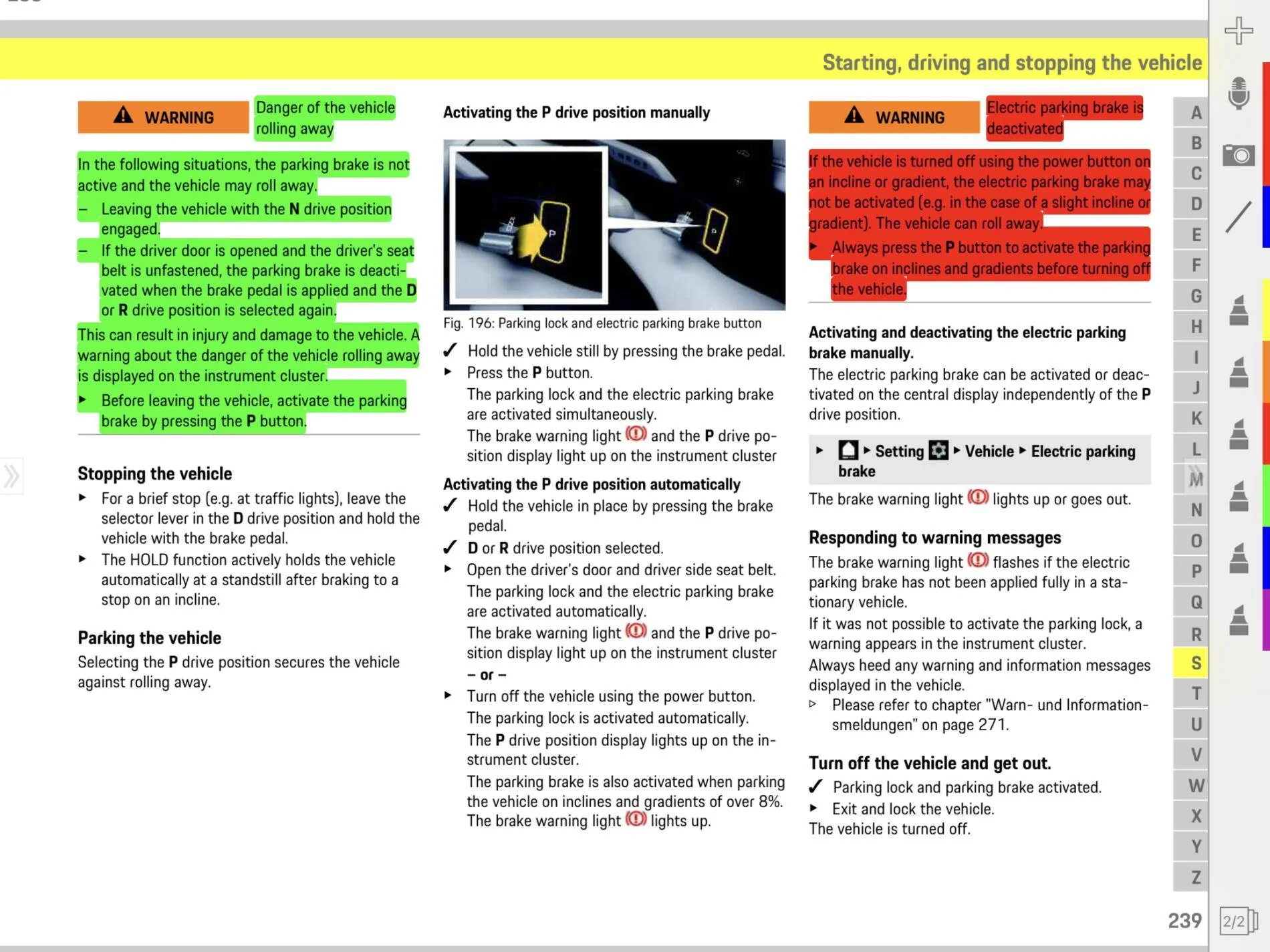

Reading the US manual page 239 highlighted green Danger of vehicle rolling away. Highlighted red Electric parking brake deactivated.
So far these are the only two warnings or mentions of gradient or hill parking scenarios with possible failures.

What I gather from reading the manual is that there are differences between the “Parking Lock” and the ”Electric Parking Brake.” My understanding is that the Parking Lock is with the electric motor, which is susceptible to rolling. And the “Parking Brake” which is only activated by pressing the “P” is the mechanical brake on the rotor.
Thus, if you go from “D” to “Power Button” then exit vehicle, the “Parking Lock” is activated, but the “Electric Parking Brake“ is not.
If you go from “D” to “P” to “Power Button” then exit vehicle, the “Parking Lock and Parking Brake“ are activated.
That’s how I’m reading the text.
Then there are exceptions like gradient greater than 8 degrees, seat belts, and door position when in “D” etc etc.

Thanks. That was my understanding and I do engage P before switching the car off.

Wow! Based on the tracks and damage, I would conclude the car rolled down, ergo breaking failure.

So Porsche UK confirmed today no brake failure. I have asked for diagnosis from time before crash. I now have to discuss with OPC Glasgow. Porsche not taking it seriously despite me confirming we have had all types of cars on that incline over decades without slipping and crashing

I wouldn't jump to conclusions. Sliding tires can create clean verticle lines.
Not with horizontal tread bars "printed" between them (as it appears)...
From the picture it really does look like the car rolled. It’s almost like it started sliding, and the ABS kicked in and the tires started turning a little bit.
...and ABS isn't "a thing" when parked....
