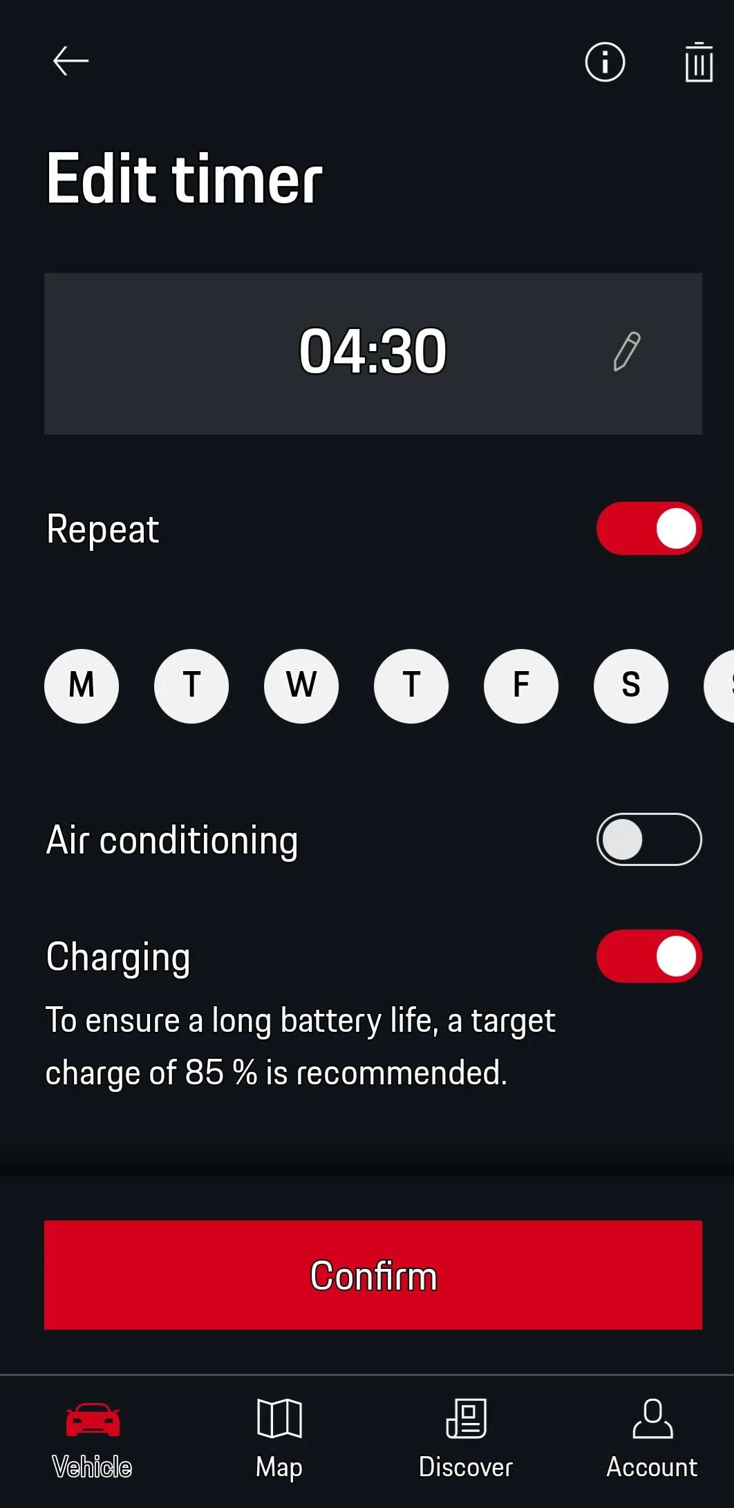

I am going to stick to what The Porsche app now says - 85%.
I have more trust in the Porsche Mothership than any dealer - as I have found car sales people in general have lower knowledge than us 'enthusiasts' on forums.
I also question the above post that Says its important to run it down to say 20% and not keep topping it up regularly?
Porsche Taycan So apparently, always charging to 100% is OK (?) Screenshot_20221201_080131_My Porsche
