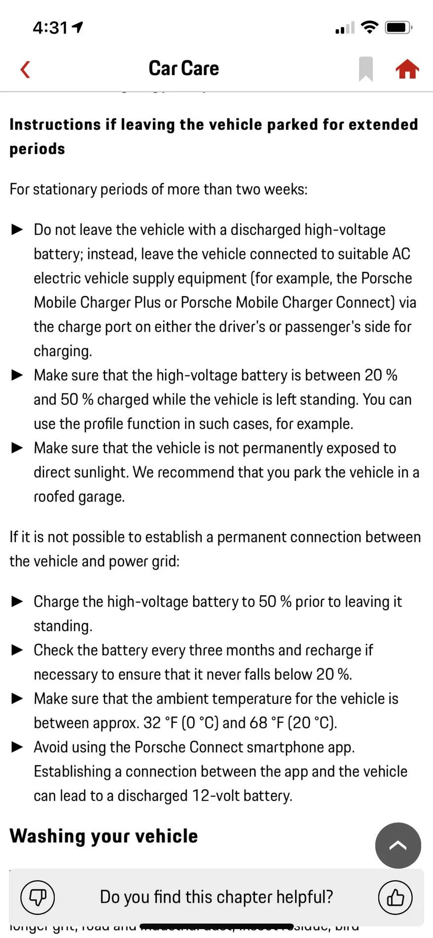

There is a TSB by Porsche for long term parking. If I remember correctly it says use a general profile set to 85%, no timers, plugged into a charger and over-inflate the tires to 51 - 58 psi to make sure they don't get permanently bent because the car is heavy.
https://www.taycanforum.com/forum/t...rsche-on-long-term-storage-with-a-bonus.2973/
The "connected to charger" part is questionable. I am not going to do that.
Also the recommended tire pressure exceeds the max pressure on the tire label so I am not going more than the max.

This depends on how long you will leave the car in place. The recommended charge level for up to 3 months is 50%, which I think is the same for most EV’s. Not Taycan specific. And the overinflating of tyres is, as you say, to avoid the tyre getting out of shape. (flat “”spot””).
Since the car has Very low battery drain when stored, I would avoid having it plugged in for other reasons.

I typically store at SoC between 40% and 60%. You typically only lose 1% SoC per month. My tires are always at 38-40 psi anyway, so that helps avoiding flat spots.
160
5,810
8,646
others have answered this sufficiently - just don't store it "full" - 80% or less is ideal from what I understand - Porsche Good to Know app has a section for long term storage I believe.

55-65% I would say. It’s in that space where the battery feels most comfortable. No charger attached.
Deleted member 1697
Guest
SOC is relevant. around 50%. 30 to 50...
but beware of not exceed external temperatures !
underground parking is ideal
