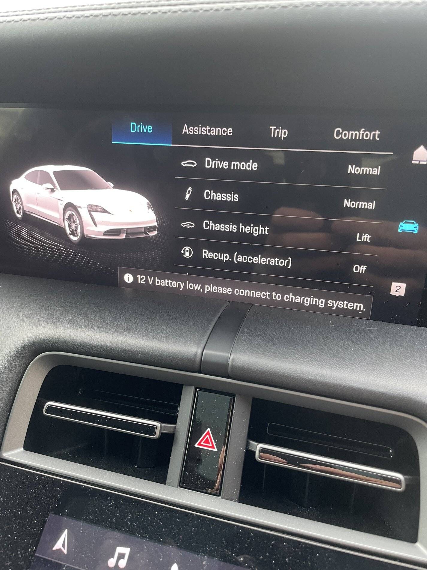

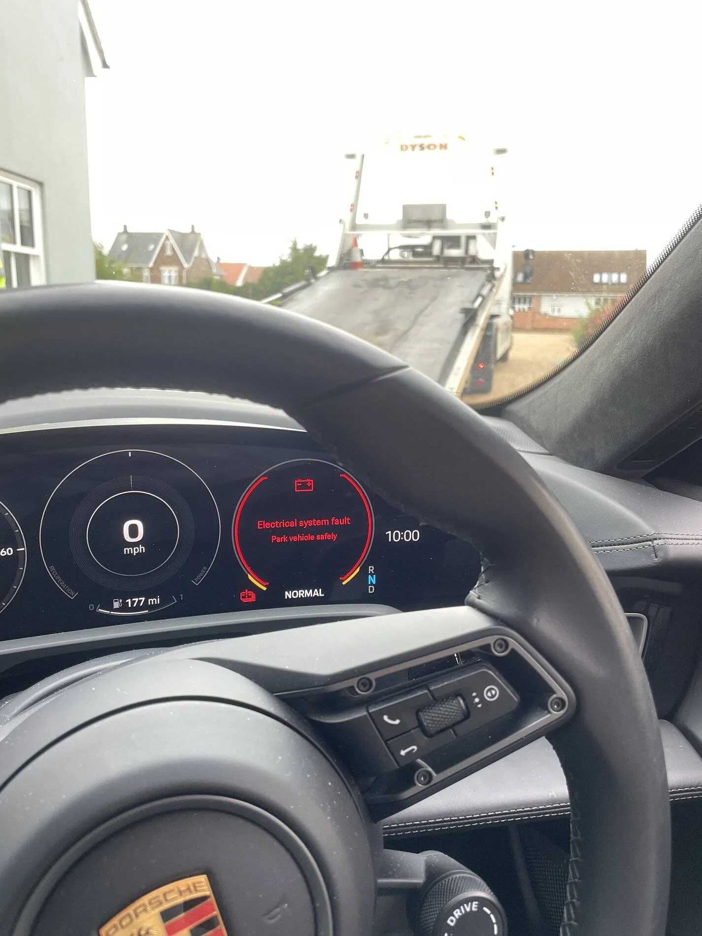

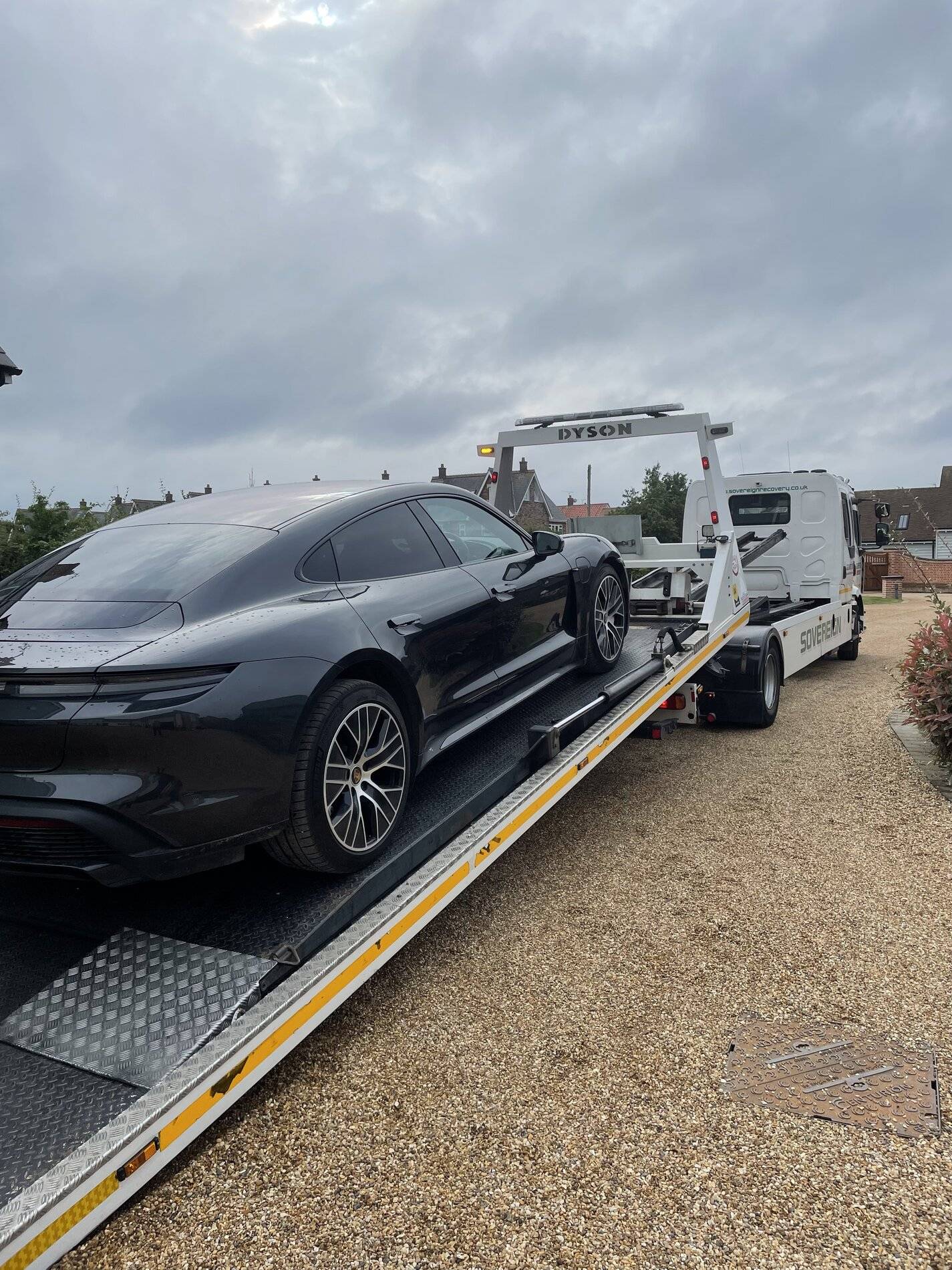

Sorry if this has been posted before but my car has just been collected by recovery as it’s bricked and it looks like the 12v battery issue. The AA guy said he has done several in the last few days.
I haven’t used the app, the Porsche charger and the keys are kept well away from the car.
Lets see what Porsche say….

Nightmare - I'm guessing that any attempt to charge didn't address the 12V message in your last picture or leaving the car for several hours and re-trying?
Hi. Neither of those things worked. I left the car for hours and it didnt sort itself

sadness and sympathies for your situation and I hope this gets resolved ASAP
the fact that your vehicle is “alive” makes this NOT the 12V issue that porsche claimed to resolve with the last round of software updates - the 12V issues porsche addressed were the vehicle depleting the “small” 12V battery while it was plugged in and charging, waiting to charge, or had finished charging - under these circumstances the vehicle would be completely dead upon returning to it with no-life what so ever (the fact that you have a display showing a fault in vehicle means this is a separate issue and not the same as the known 12V death issue).
also while Porsche claimed to fix certain issues with the latest round of software, they did not claim to make the vehicle invunerable to future issues or actual vehicle faults.
Even with the latest software all of our Taycan‘s can encounter errors that will require diagnosis and service by Porsche. These vehicles can still encounter problems, and will report those problems via various codes and errors displayed to the vehicle driver/owner.
The last round of software addressed a plethoria of “false” errors that should not occur and in some cases rendered the vehicle in-operable. But the software updates do not make your vehicle immune to actual and legitimate faults. Just because your vehicle has a fault doesn’t mean Porsche didn’t fix some underlying issues.
