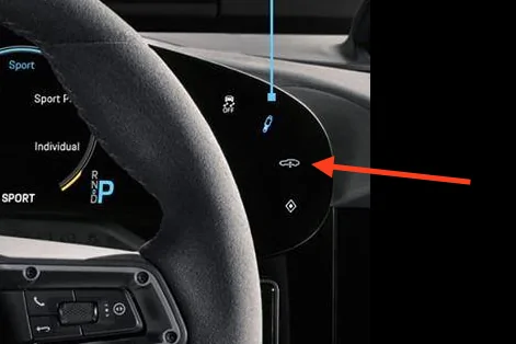

Initially I didn't tick off the Sport Chrono Package since my thinking was that my 4S was not going to be a track day car but a grand tourer. However, I'm glad my sales representative talked me into adding it, since I cannot imaging having to go through the computer screens in order to quickly switch modes. I use it all the time!
I don't think you can change much of the settings in Normal, Sport or Sport Plus modes, as they seem to be set the way Porsche defines those (you can switch on and off regen in all modes). The Individual mode is where you can define your own settings, including raised height I would guess.
However, realize that the raised height is disabled over 30 km/h - so only really useful going in & out of elevated driveways, garages and speed bumps. Some people complain about not being able to find the "elevate" function, but there's a button for it right there in the main display:
