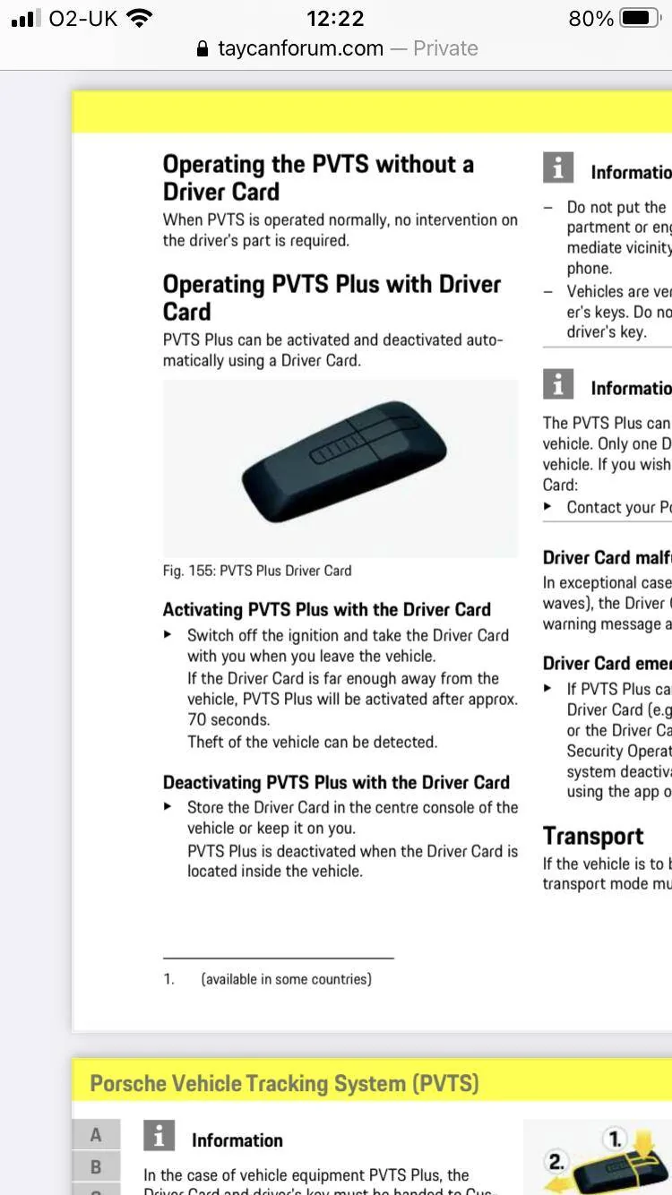

Porsche Taycan Standard tracker vs category 7 aftermarket 939DC263-1554-4EEC-89EA-06CBC4FE4FFB
i I think it depends in whether you have PVTS or PVTS+
The above is from the manual posted on the forum earlier in the year and would suggest that the standard system is operational without intervention.
I haven't lookedI to it yet and take delivery in 2 weeks, so no expedience yet, but my insurer who are part of LV= just specified having a tracker, not any specified type.
Perhaps actual owners in the UK could enlighten us?

Is the "driver card" that you need to keep with you like a credit card, or something bulkier? The picture from the GTK guide above makes it appear almost like another key fob. I guess I'm asking - will it fit into a wallet like a credit card or it is more of a thing that goes on a keychain?
4SJB
Jonathan
Aug 24, 2020
145
128
Taycan 4SCT Mini Cooper S Audi A4 3.0 TDI
It’s got a battery in it so will not be as thin as a credit card.
