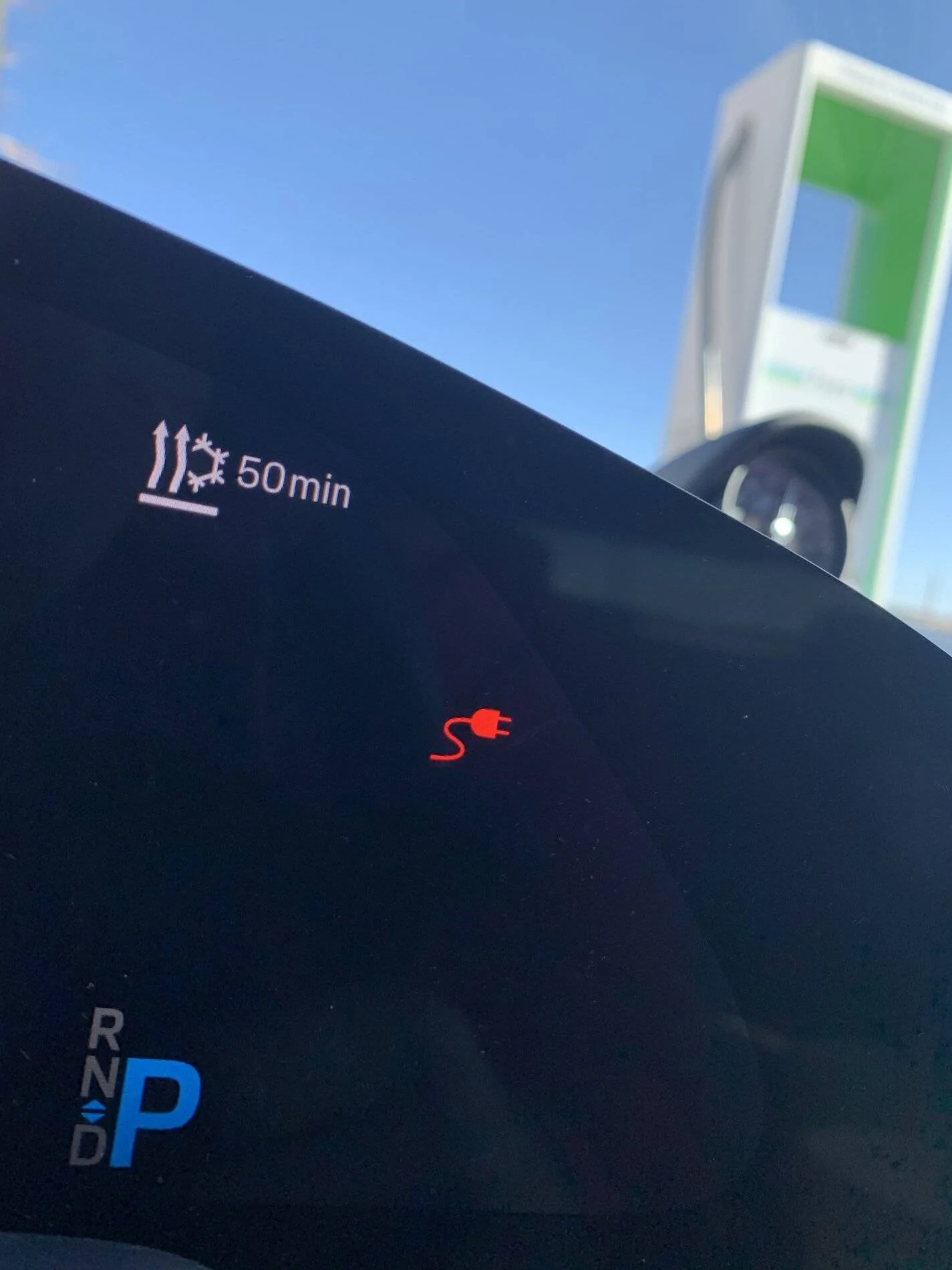

Strange charging Icon on dash

What is this 50 min icon? Sorry

I think it’s the preconditioning timer.

You must have interior heating set to a certain level and it's saying 50mins to get to that level.

Yep - preheat / precooling symbol (in the Porsche Good to Know App....). If you don't want this function automatically enabled then ensure you disable in the PCM (and check behaviour when you unlock a door as that will trigger it too). Whatever the last climate control temperature you had set then when the preheat / precooling is triggered will default to that setting.
Nothing to do with the battery pre-conditioning or charging process.

I noticed that when I unlock the car, it blows hot air . My climate control was set to 26 C . So this is climate control preheating feature ? And what does the minute indicate ? Can it cool it as well ?
Yes - preheat / precool.
There is an option to automatically perform this task when you unlock the car and it uses the last temperature you had the climate control set to (activates heated seats and heated steering wheel where fitted). Can be disabled in PCM.
Can also be set via a timer / profile on the Porsche Connect App.
