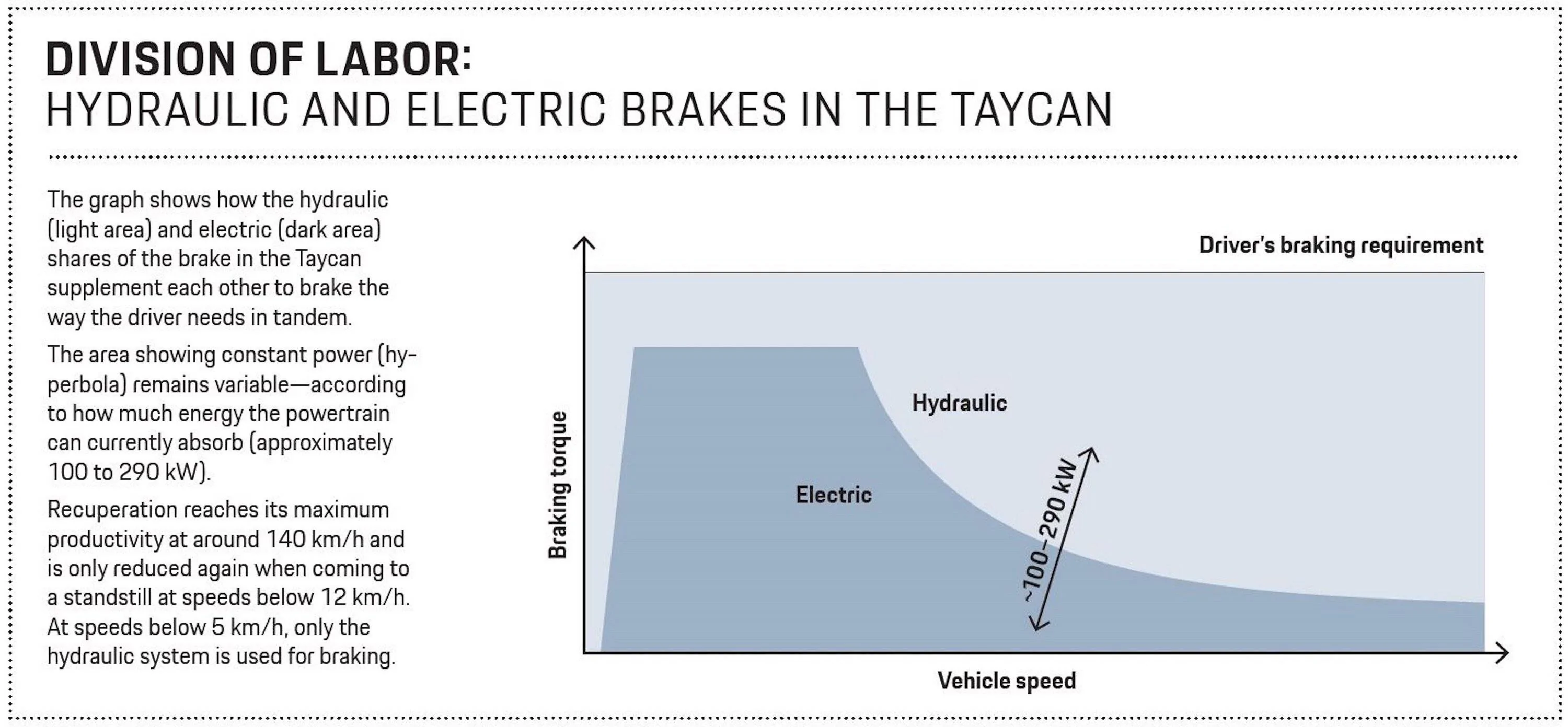

Hi, I know how to switch it on. It’s very very light IMHO with limits functionality. However, when regenerating the green bar shows on the speedo. All simple up to now
What I don’t fully understand is the relationship between disc braking and regeneration. On active cruise when the car slows and green bar shows. Does that mean it’s fully using regen?
when I depress the brake, the green bar shows. Is that regen braking or disc?
is there a way to know what system is being used to slow the car?

This graphic should explain. Basically you'll use full recuperation between 12kph to about 140kph unless you need more than 290kW of regen power. Hydraulic brakes get blended in starting from 12kph to 5kph, below which is fully hydraulic. Above 140kph, you're still able to get 290kW of regen braking power but because power=mass*accel*velocity, the hydraulic brakes need to assist at higher speeds to maintain the same braking torque (torque being proportional to acceleration).
Porsche Taycan Struggling to understand Taycan regen brakes S.16_Brakes_in_the_Taycan_EN
source: https://newsroom.porsche.com/en/202...ke-force-distribution-recuperation-30953.html

Very helpful. Thanks. So the green bar = recouperattion and not disc braking?

If you see a green bar at all it means recuperation is active and occuring (the display graphic has this written on it).
Brake recuperation is always available after a few short miles (conditions dependent).
The button on the wheel relates to overrun recuperation and only occurs when you take your foot off the accelerator and you will feel the car slow down. This has a manual and an auto setting as denoted by the icon when the button is pressed. Auto mode relies on tracking the car on front (I would avoid it).
Best recuperation is generated from braking and not overrun.
Coasting (no overrun enabled) is arguably more efficient.
Brake recuperation uses the electric motors to do most of the braking under normal conditions. Emergency braking and on first start up will use the discs.
Also display the Trip data in the central PCM screen and will see a graphic of where the power goes as you drive
Don't expect much recuperation overall and don't rely on it it add much range. Coasting is king for that in my experience.

A good indication of how often the "physical" braking system gets called upon, is the notable quote in the article linked above by @bsclywilly-
"In the Taycan, 90 percent of all times the driver brakes in everyday situations, this can be done using electric power only"

Taycan has brake by wire technology .... even if you're pressing the brakes, the computer is able to determine which ones to use and 90% of the time, it will use the motor instead of the hydraulics brakes.
