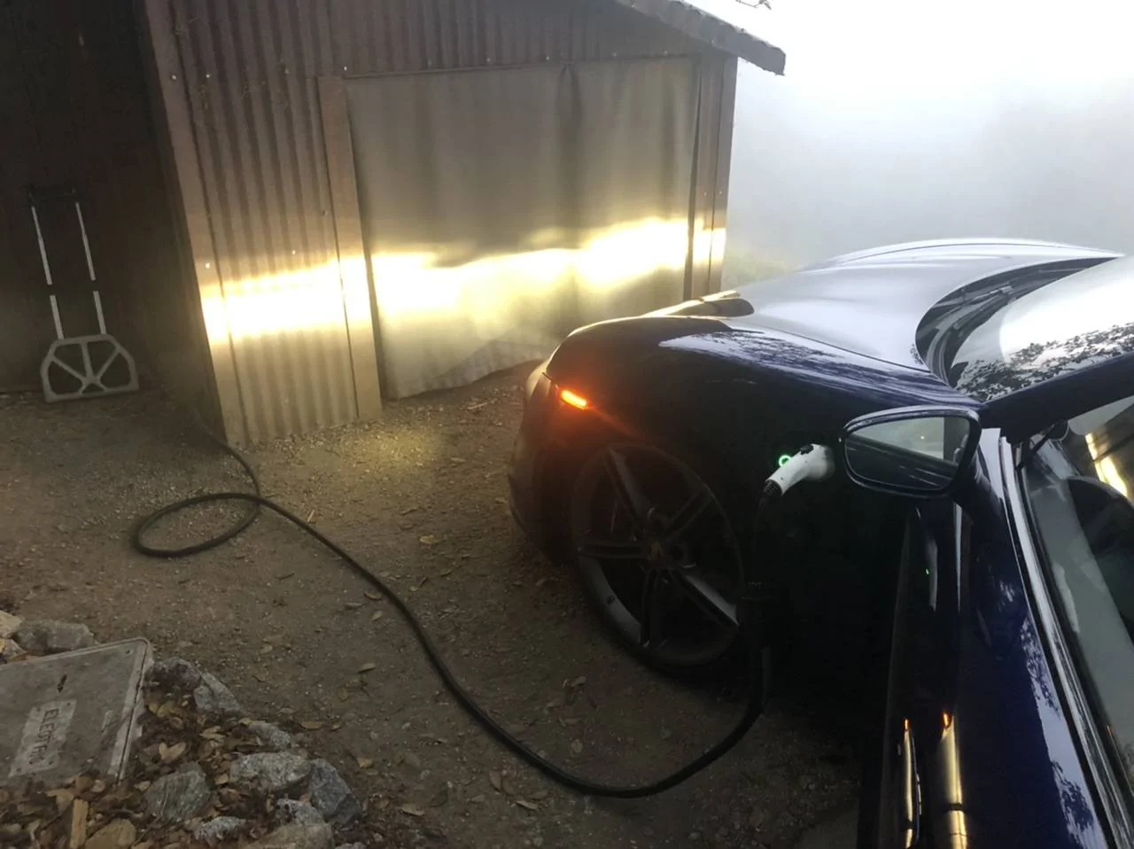

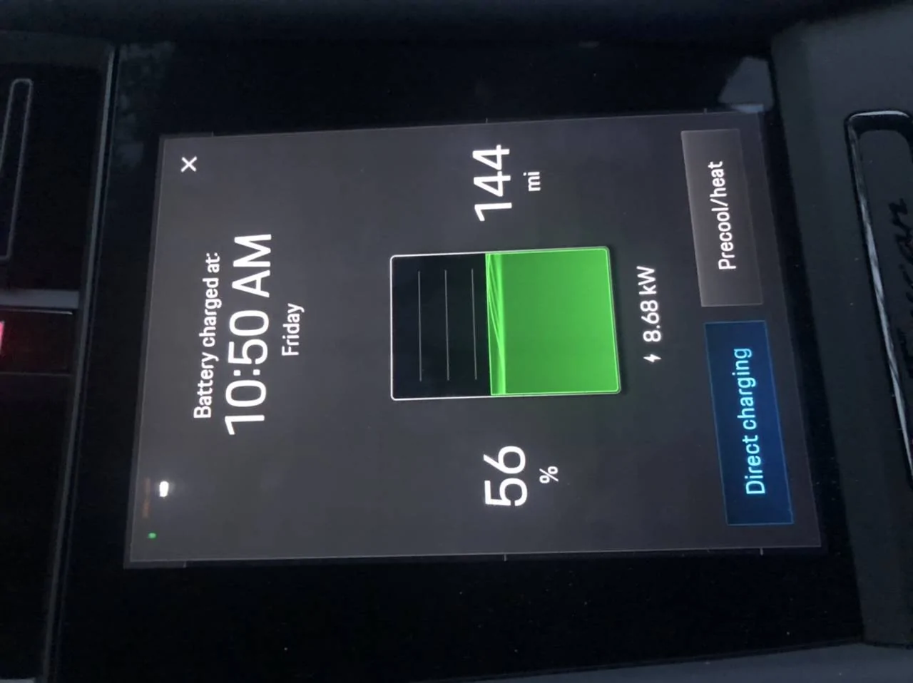

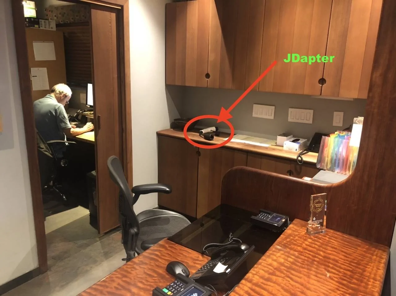

these picture were all taken this morning at the Post Ranch Inn - I Tested it all before I left the adapter
  • 8.68 kW charge rate = 40 amp charger - so we're good
  • chargers are next to the front desk
  • JDApter is the 40 amp version - which will do for now - cause the chargers all appears to be 40 amp charges - I recommend the 80 amp version for purchase in case one encounters a 48 amp Tesla charger - 48 amp would potentially overheat a 40 amp JDApter/TeslaTap…
  • the adapter fit was very very snug - and it was very difficult to pull apart - this is expected and it just takes hard work and pulling to remove the adapter
