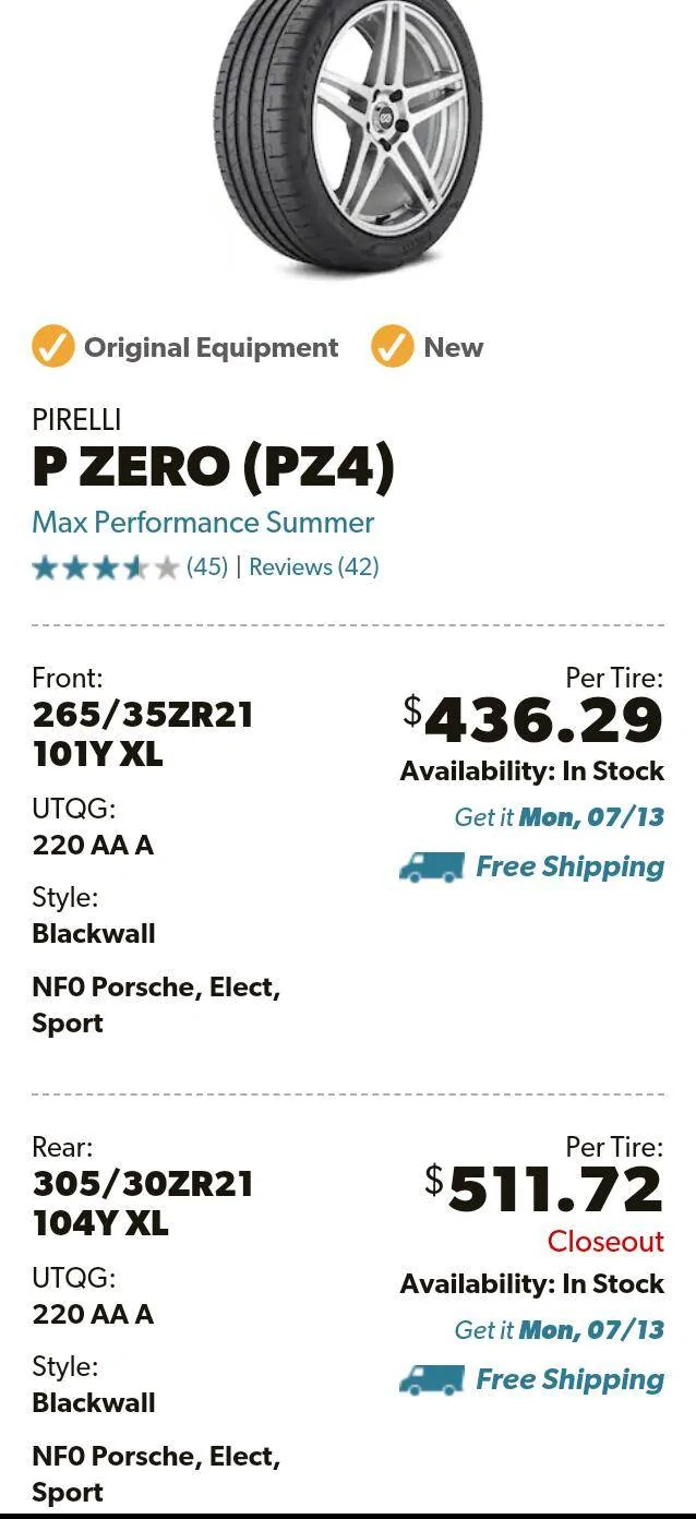

I am personally getting the 20" Aero Wheels but I saw so many comments about not being able to spec Summer for 21" wheels and I see in the latest "Good to Know" app for USA which is Nov 2019 it shows only All Season tires available the 21" wheels as well. Looking at TireRack.com I did find these for those that already got all season but looking for summer.
Porsche Taycan Summer Tires Screenshot_20200709-234438
Disclosure: I have no personal interest in Pirelli and am not recommending this tire.

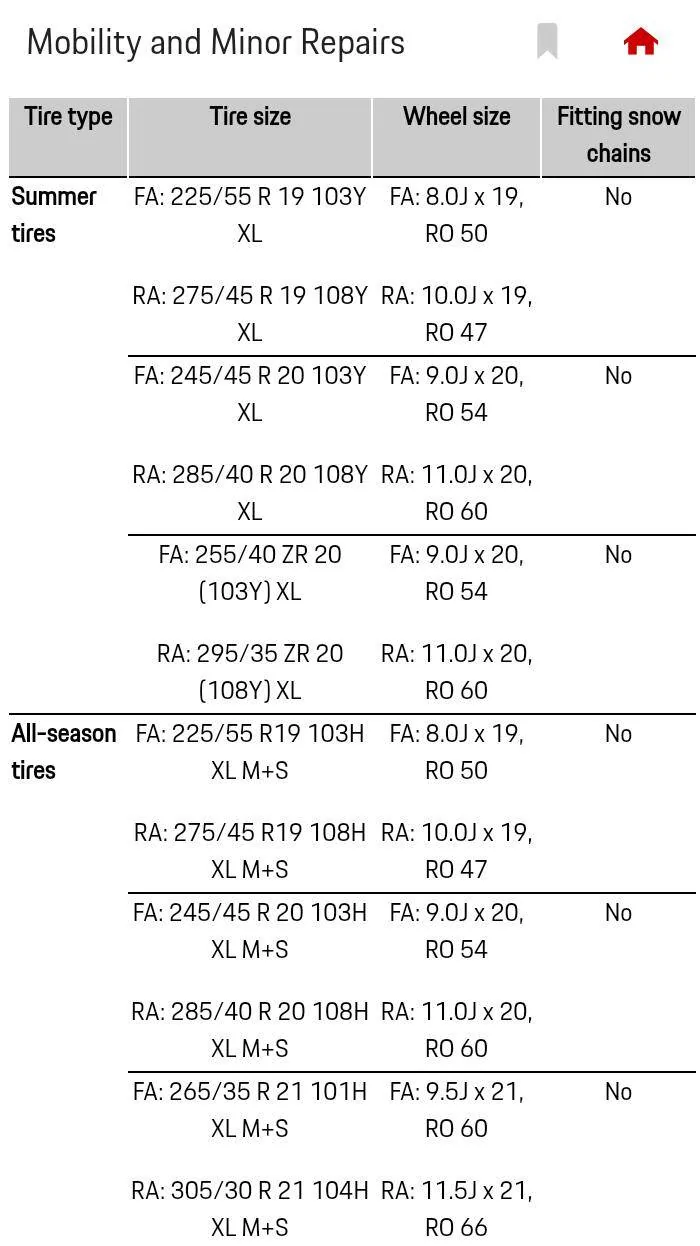

Another interesting thing I saw on the good to know app is that you can put larger tires on the 20 inch wheels.
I was only aware of the 245&285 combo, but you can also mount ZR rated:
FA: 255/40 ZR 20 (103Y) XL
RA: 295/35 ZR 20 (108Y) XL
Image from Good to Know:
