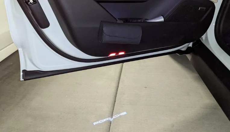

I also just put them in the storage space under the center screen. No case so they are easy to grab and no sliding around due to the grippy surface material of the storage area. It’s the only thing I keep down there so it’s not an issue to fish for it while driving. I agree this retrofit is a better alternative but there is no way I have the courage to attempt something like that… kudos to you all that can do this!
I initially stored mine here too, but I've since changed to storing it in the driver's side door compartment along with a couple other misc items. It became too annoying contorm my arm to reach into the storage area every time I wanted to get/put away my sunglasses.

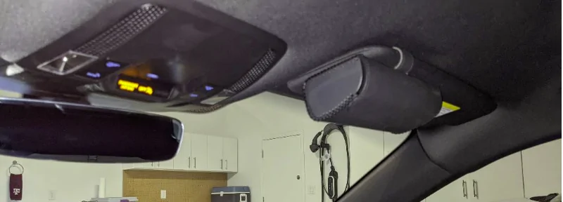

No courage necessary. All that is needed are two small screw drivers to release the metal clip (on each hinge) concealed behind the decorative plastic "plug" on the grab handle hinge. If you get one of the Sunglass holders made for Japanese cars it's a simple pop-in installation. Only the Volvo case with its weird hinge design requires extra imagination to adapt to the Taycan grab handle mounting locations.

The second holder, which clips on to the driver's door, is for small essentials like an eyeglass cleaning cloth (to wipe off raindrops), a comb, a pencil, and a mini LED flashlight because it's challenging to take these out from the armrest storage bin. I put a self-opening/closing umbrella in the door storage space, BTW - you can see its silver handle in the photo.
Porsche Taycan Sunglasses holder in place of grab handle 1655656666210

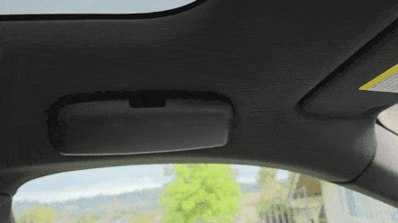

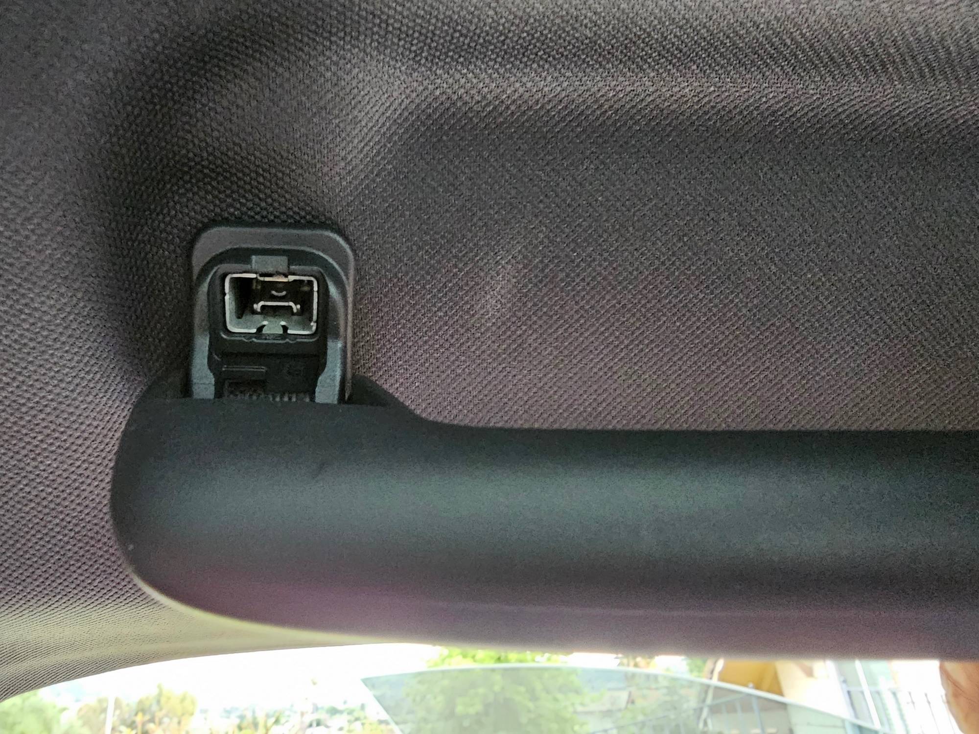

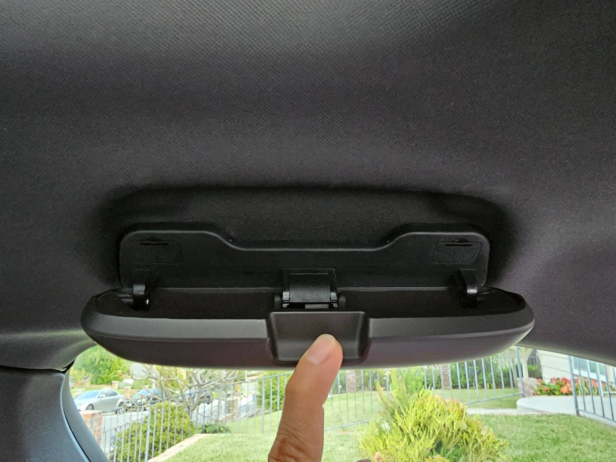

Installed this today. Got the Audi version from Amazon:
https://www.amazon.com/dp/B07T1ZTCMR
Porsche Taycan Sunglasses holder in place of grab handle Holder
Porsche Taycan Sunglasses holder in place of grab handle handle closed
It didn't require any modification to the grab handle or hinge. Simply remove the tab with the included angled tool, press down on the metal clip inside and the whole grab handle comes off. It's pretty shallow so won't fit bulky sunglasses.
Didn't see pictures of the installation so hopefully these pictures will help some of you.

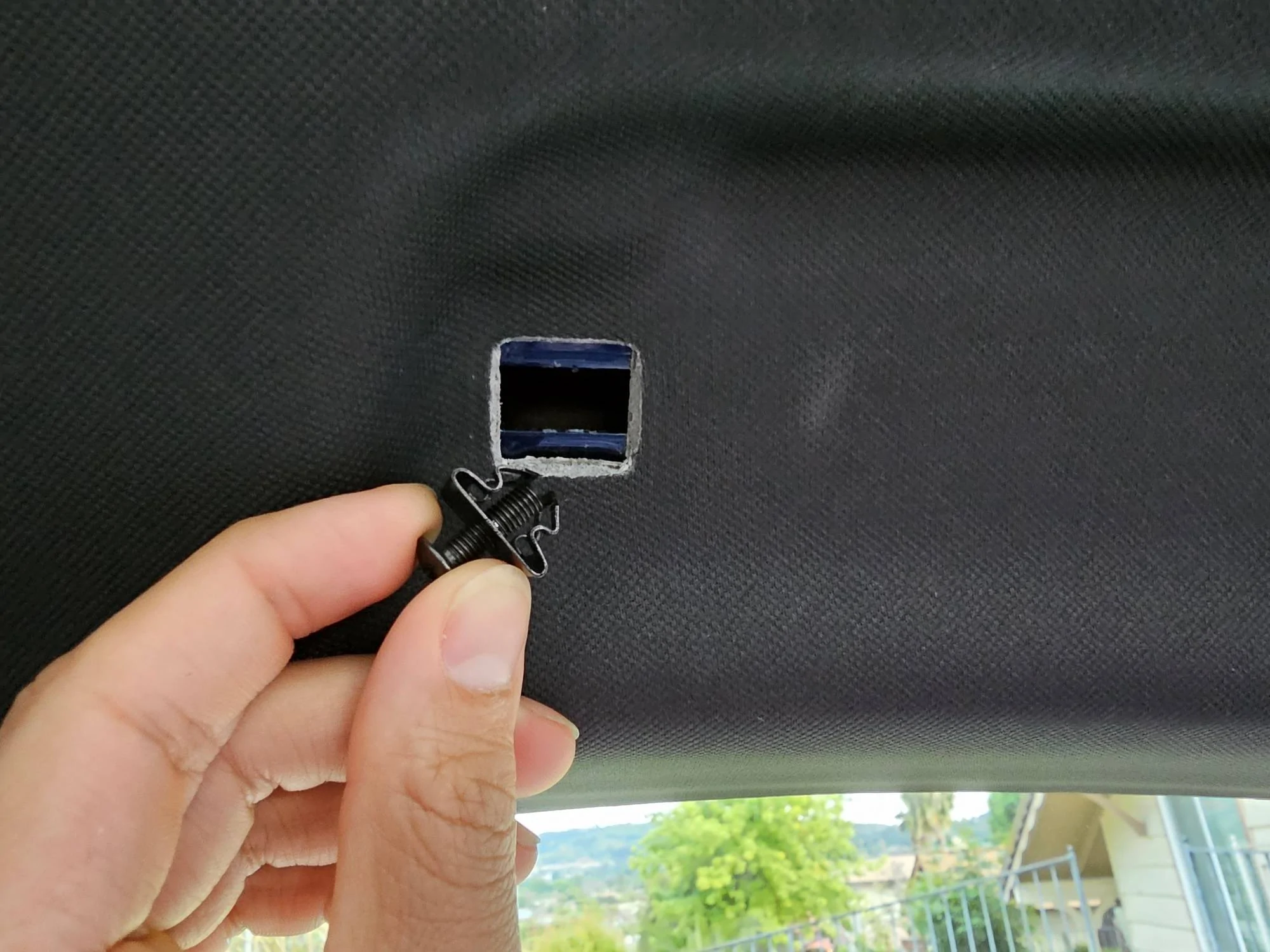

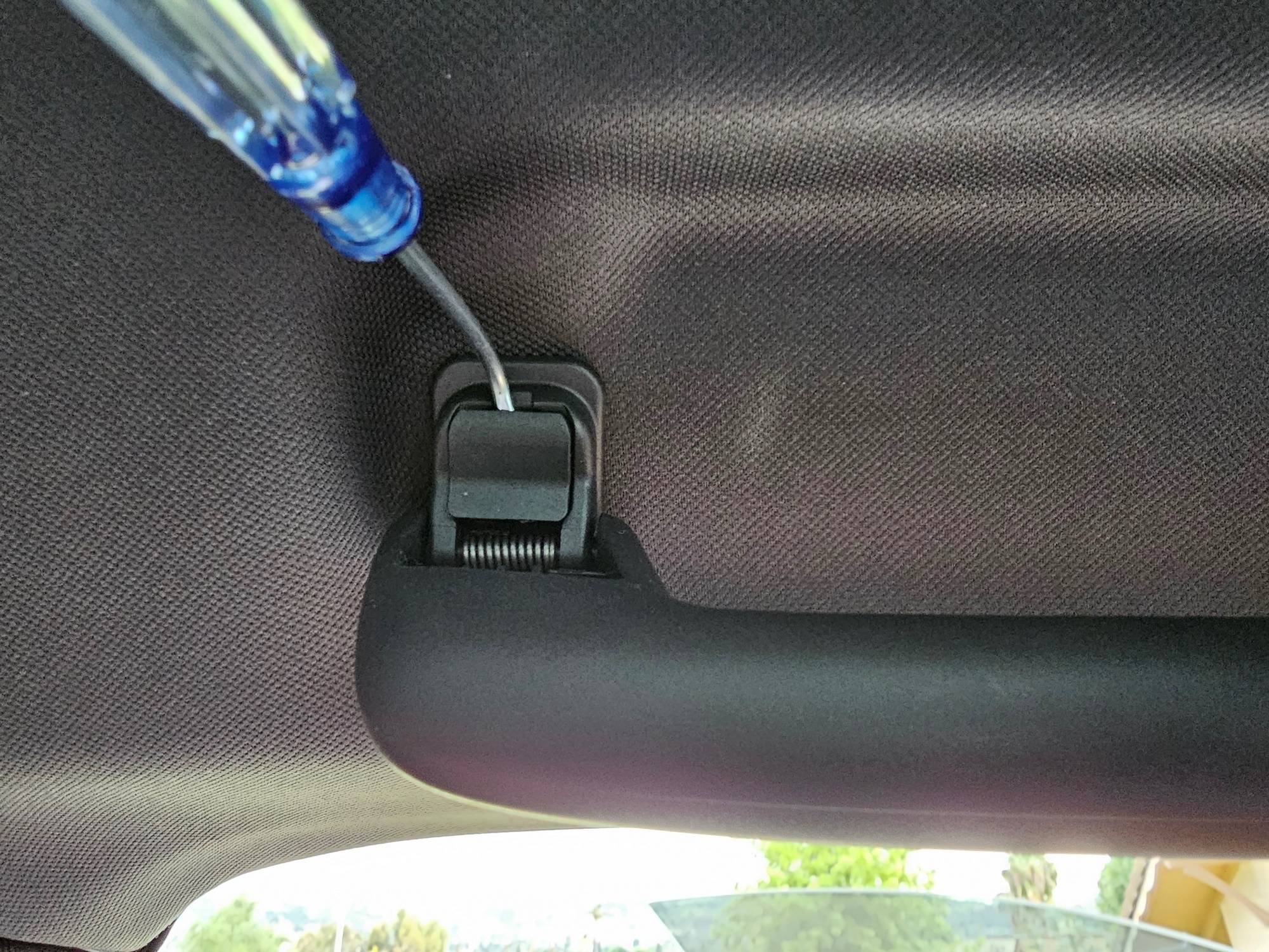

Remove tabs with the included angled tool. Just insert it from the top slot all the way down. With a gentle tug and it will come off.
Porsche Taycan Sunglasses holder in place of grab handle handle2
Porsche Taycan Sunglasses holder in place of grab handle handle3

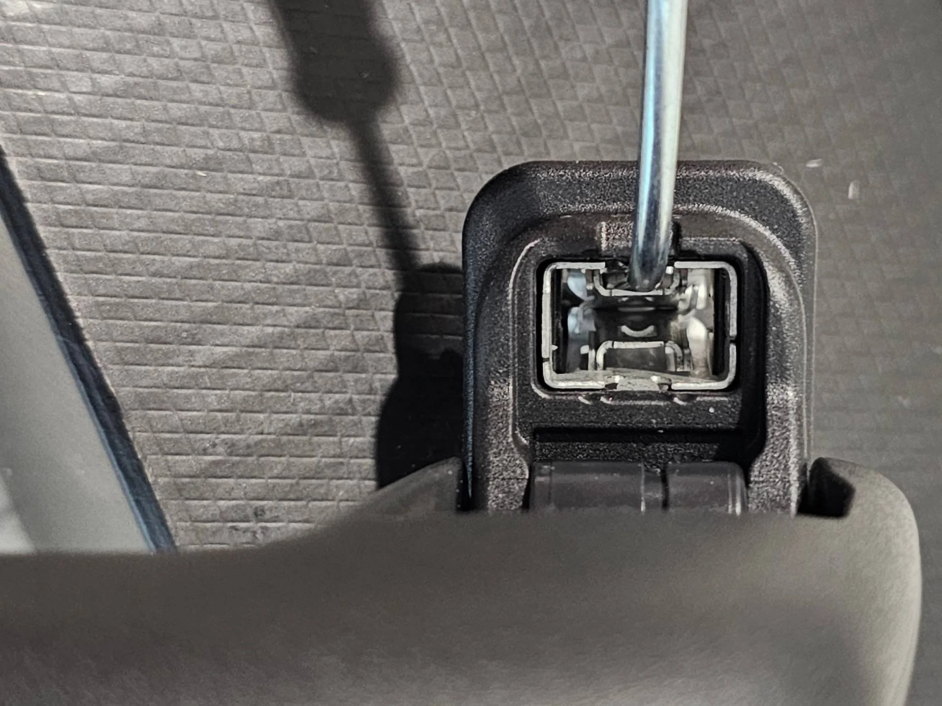

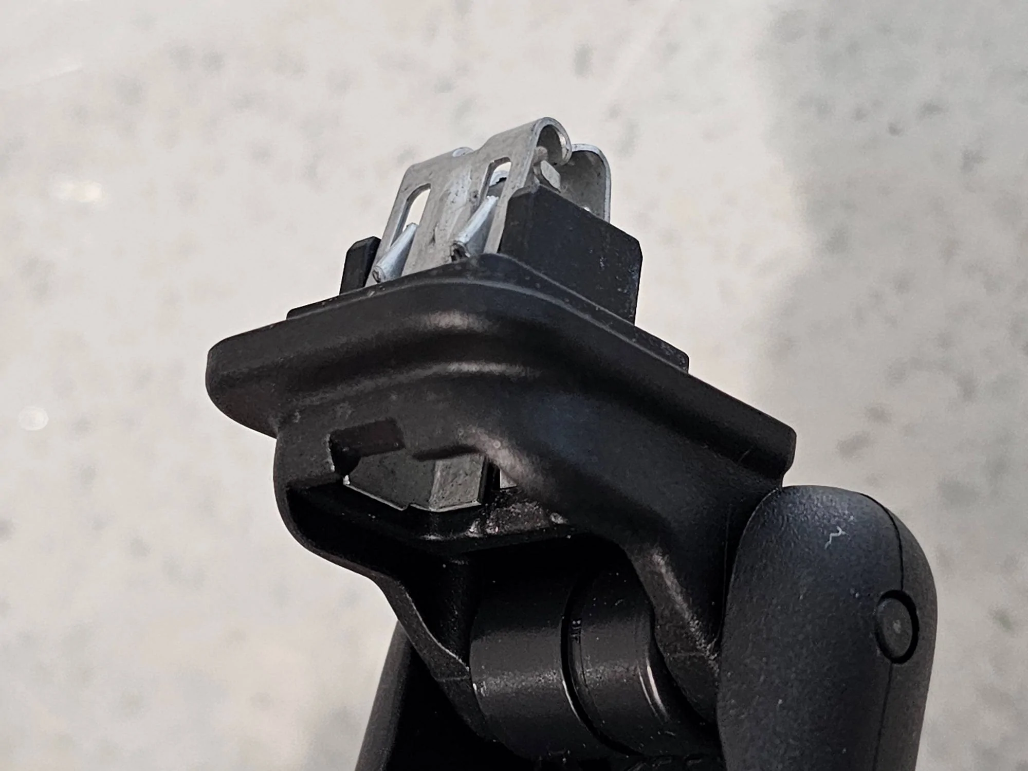

Use the same tool and push down on the metal clip inside to release the clip's teeth from the opening. Do it to both sides and with a firm pull, the handle will come off.

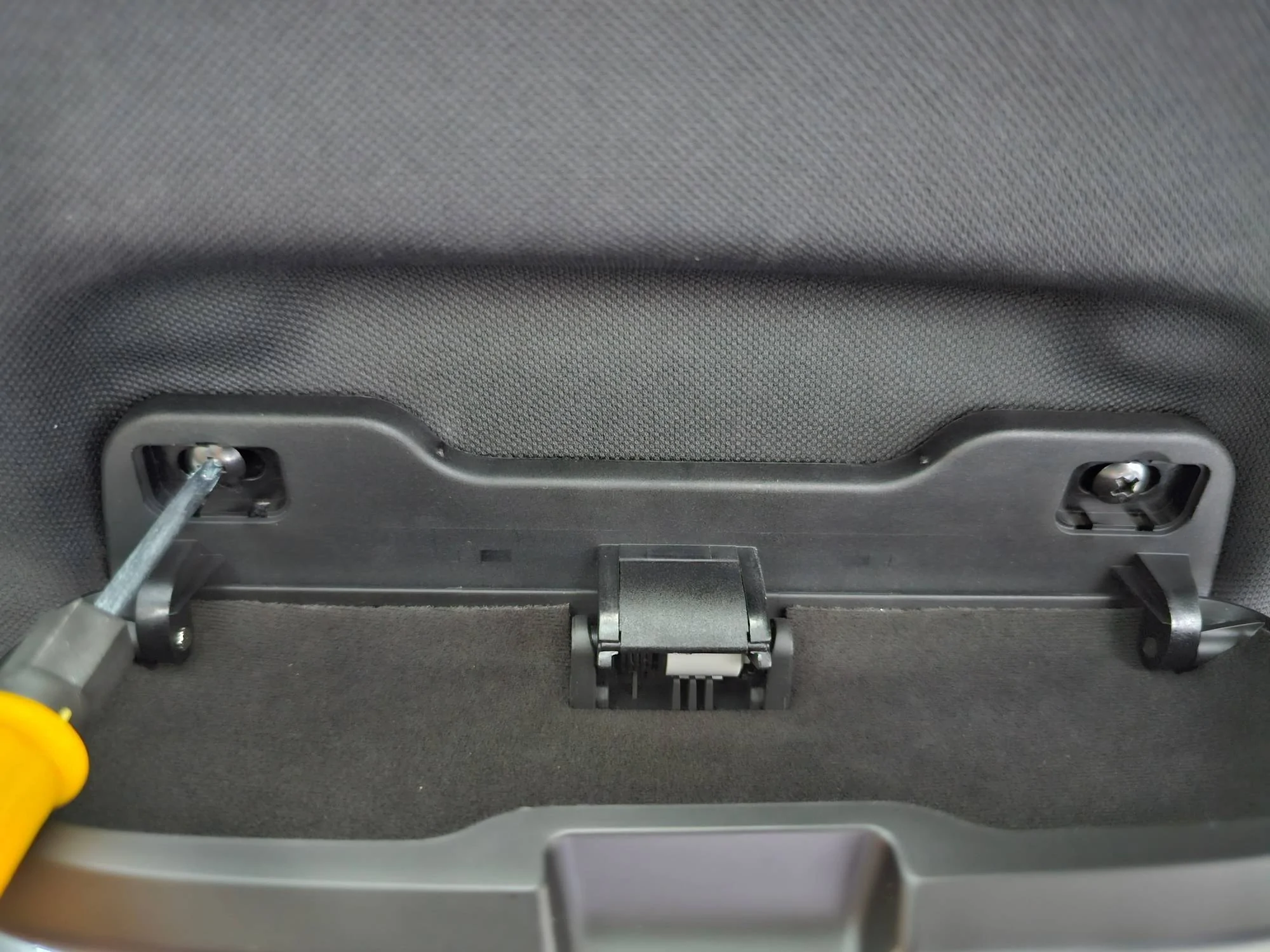

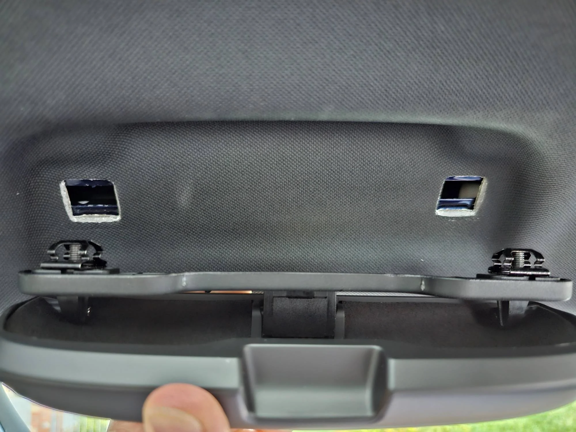

Pre-insert the included screw into each metal tab onto the sunglasses holder. This screw will expand the metal clip inside the hole and holds it in place.
Porsche Taycan Sunglasses holder in place of grab handle handle4
Porsche Taycan Sunglasses holder in place of grab handle handle5

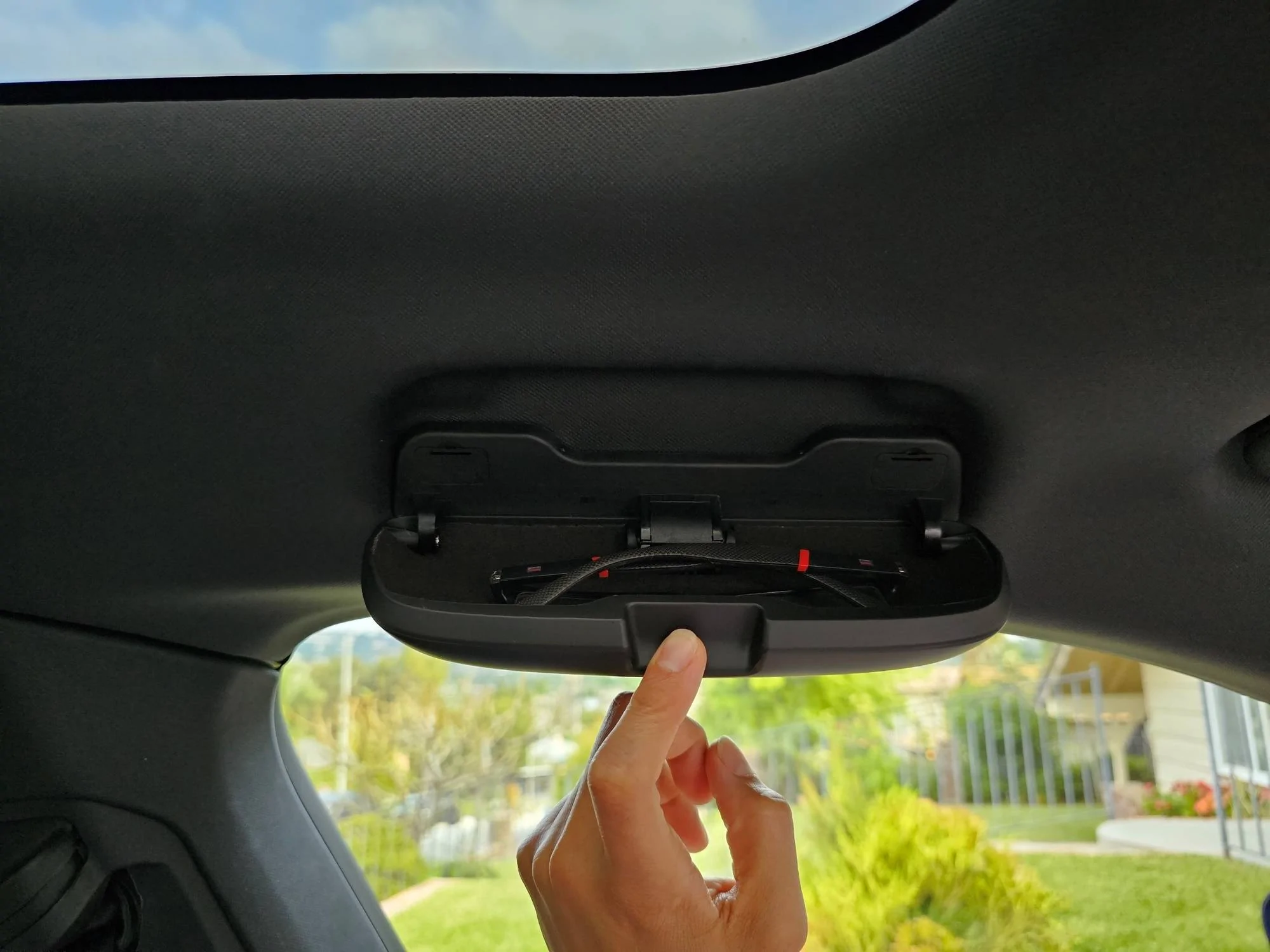

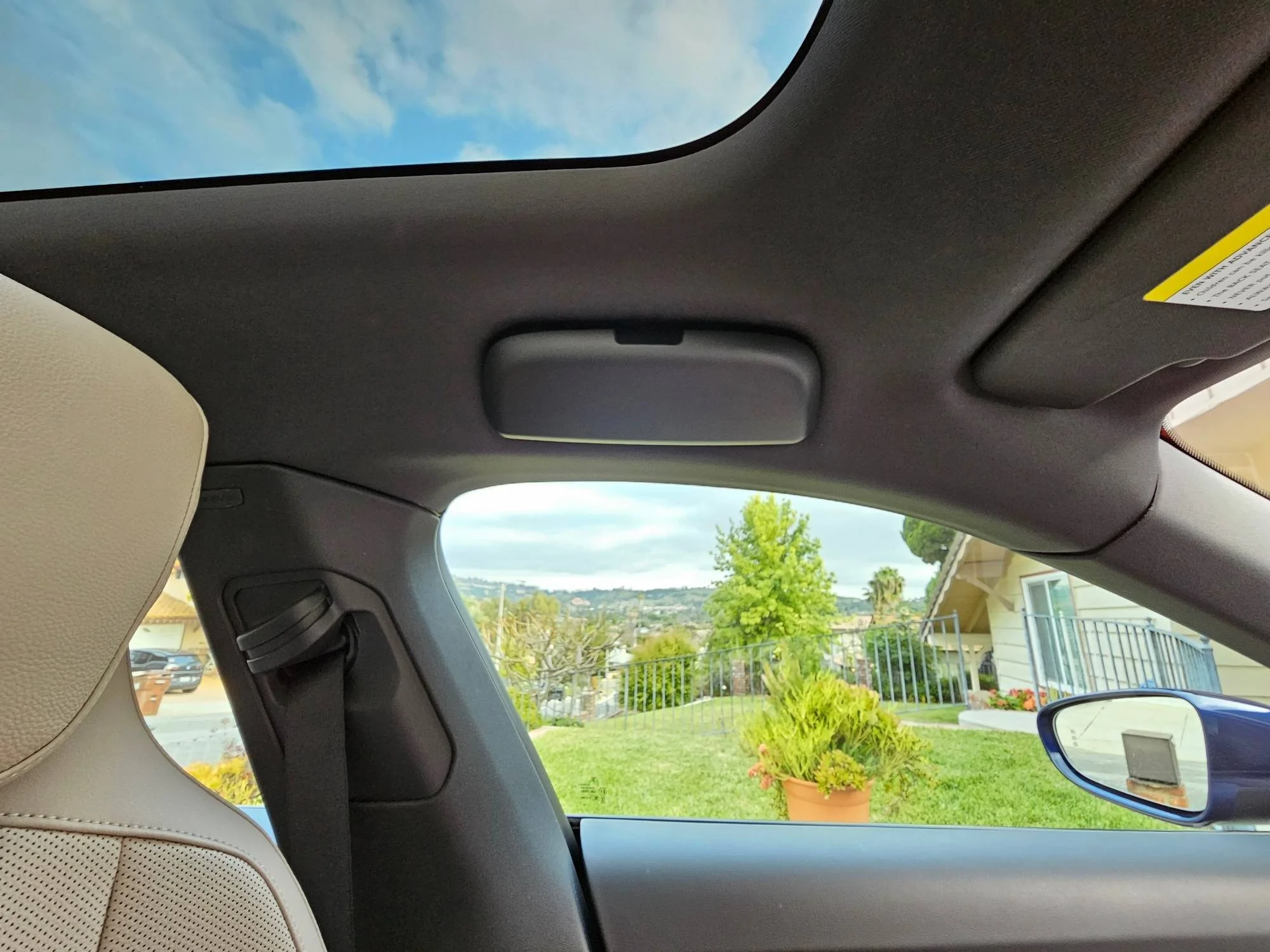

Tighten the two screws, put the included tab covers and you're done!
Porsche Taycan Sunglasses holder in place of grab handle handle6
Porsche Taycan Sunglasses holder in place of grab handle handle complete
Porsche Taycan Sunglasses holder in place of grab handle handle use
Now I can use the center storage for other things.

I’d like to thank tomato for refreshing this thread.
I’ve just picked up my new sport turismo and the thought of having to hack the door handle to pieces to get at the spring and pin mechanism again wasn’t something I was relishing.
Then along came tomato with his pictorial reply and, importantly, a link to purchasing the part.
A much easier way of achieving the same result and 15 minutes later I have it installed.
This is what this forum is for. Help advice and further suggestions.
