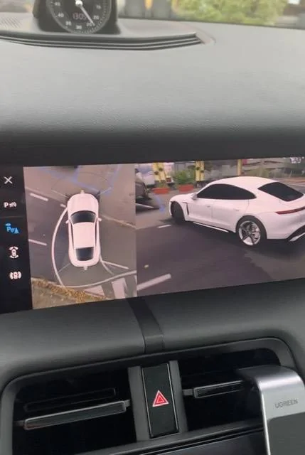

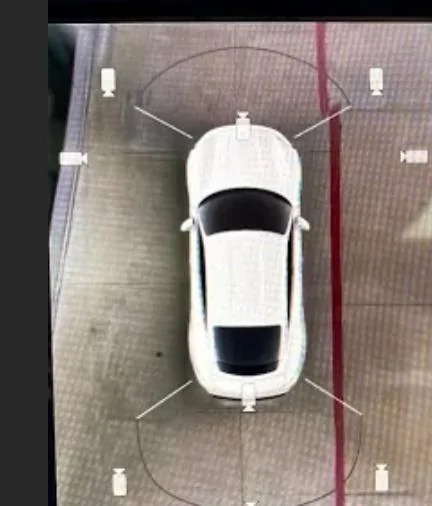

Hi guys
I need help
I’d like to know if I have to learn something about surround view parking system
i have some problems to activate the 360 view and move the car with finger
I have done it but casually
i noted that in some pics on web there are 8 camera icon on the screen...I have only 2 camera icons (front and back)
why this?
I attach mine and another taycan found in the web
Porsche Taycan Surround view DD7B19B5-462D-4BB3-BD03-3779C96B42C5
Porsche Taycan Surround view 5DDD8DAD-2097-466F-801C-736AE40A13CF

Mine also looks like yours. I was expecting the “8 camera” view like the one you reference to. I bought 360° and everything.

if I click on the very lowest camera icon with arrows I can do anything except see the laterals of the car...
if I click on second camera icon as in the attached pic and after I click on trackpad display I can activate (not always) the 360 view.
See attachment
See attachment
I see what you're saying now.
I believe it is because you just have the parking sensor icon pressed on the left side of the screen.
Try pressing one of the other two icons there on the side of your screen to see if the other views pop back up.

no solution.
I asked help to my dealer...
they have never seen that
in my surround view doesn’t appear the classic view as in other Taycan...I have only 2 camera icon and not 6.
they have opened a request to Stuttgart Germany because we have to know how can fix it
