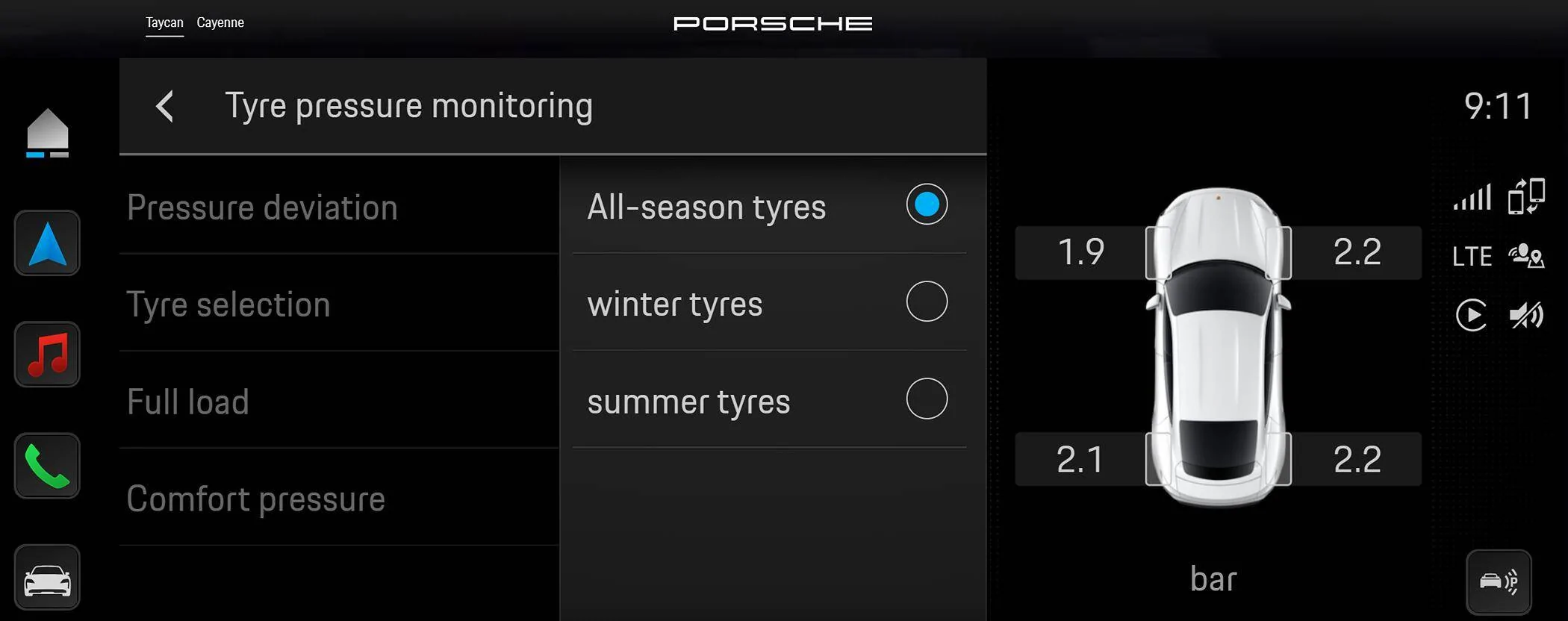

Is this the menu where you see it? I only get the following settings, (there is no scrolling available, I tried scrolling down, nothing moves). Or is there some other setting for me to set the the winter tires on?

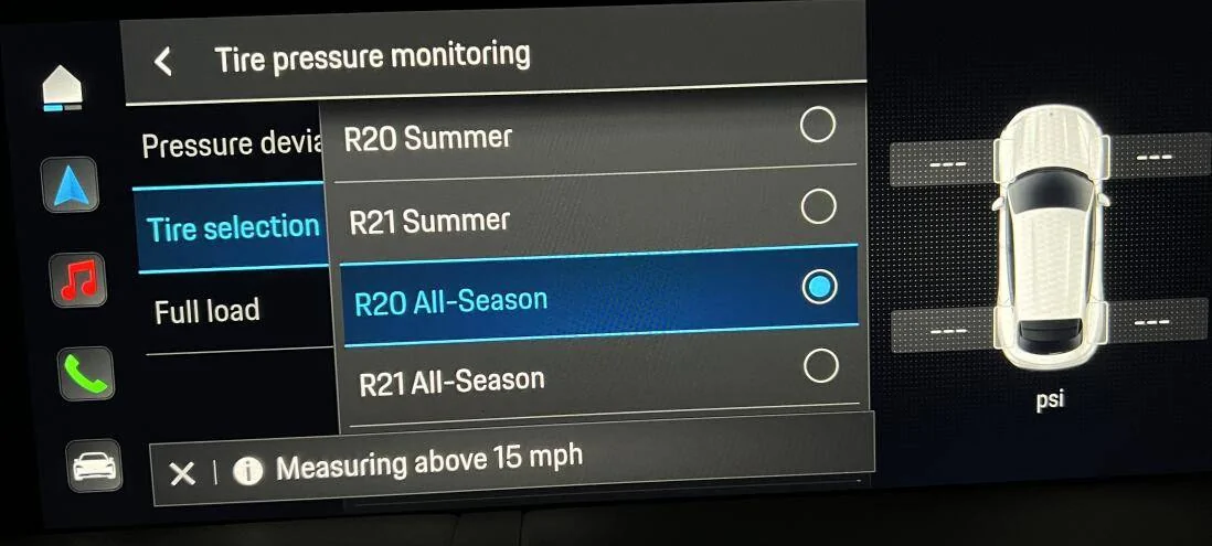

EDIT: Nevermind. I just realized I have to kill the "Measuring above 15mph" message by hitting the X to see the last option, which is "R20 Winter".
