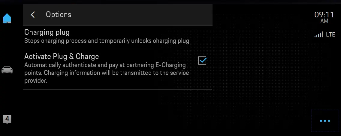

I was just wondering the same thing. There’s all sorts of handshaking going on between the charger and the car when it’s plugged in, right?
Certainly not. The Porsche Charger should be able to recognize the car and charge it automatically even when the charger has a pass code set. Plug & Charge at home, so to speak.
My Porsche charger keeps asking me to type the pin every single time I connect the car.....my charger is in a shared underground car park hence the need for a pin
Yes, mine too, but the charger should be able to recognize the car to offer plug & charge. Next time I charge, I try to get this going.

Iben
Jean-Are
Jan 12, 2021
44
Norway
Porsche Taycan Turbo S (2020 mod.)
I`m experiencing the same (i need the pin for safety in shared garage).
I thought the car was able to sense the Porsche connect charger, making the charger only work on my car without the pin.
Maybe we need the new update (late feb.)?
