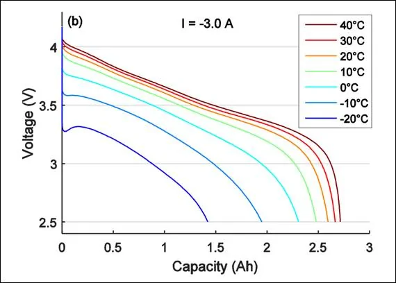

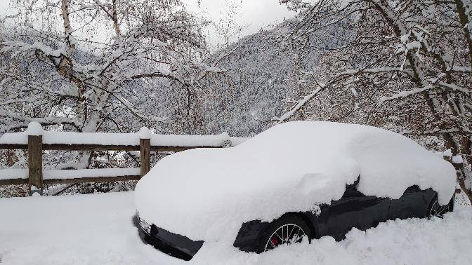

It was a total PITA to get the snow off this thing a couple of days ago and, like you say, as there's no excess heat from the engine any snow and ice you don't remove hangs around forever as you drive about .
Interestingly my GF said the car had 60% charge when she parked it and it was down to 46% after I had dug it out. Do I need to preheat the car? Unfortunately it has stopped talking to the connect app.
A cold battery have less capasity than at normal temperature. That might explain the loss from 60 to 46%.
