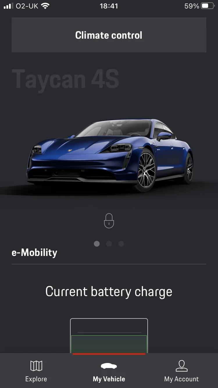

Yes
See pic, also my connect app only shows car locked and no parking brake...

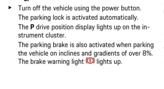

Looking at https://www.taycanforum.com/forum/t...on-snow-bad-day-at-the-office-pt2.3394/page-2 and examining the posted picture, it seems that they key could be here:
If the incline was less that 8%, still enough to cause a slide in a snow and no auto parking brake.
