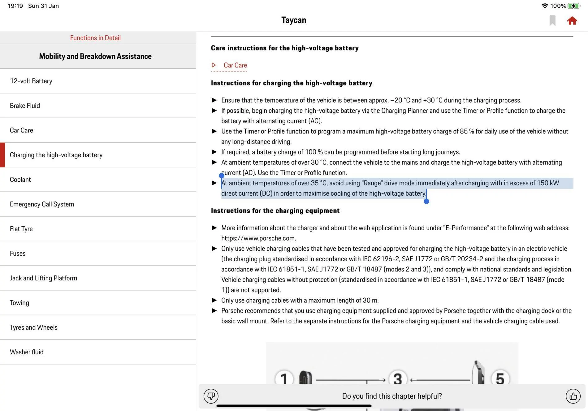

Can you see if you can locate that article? It sounds logically inconsistent. To recommend Range mode for long distance trips and then recommend a reduced battery charge which yields lower range sounds strange.

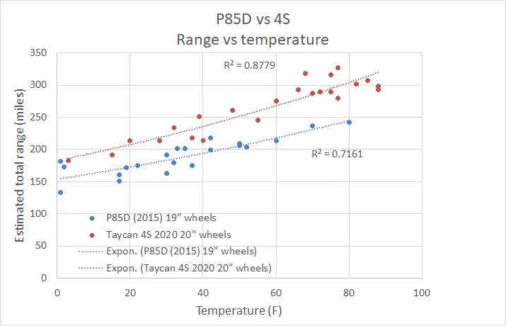

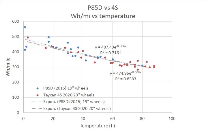

183 miles at 3F (-16C) starting with warm battery, 495 Wh/mi. Sunny, no wind, clean road.
All <45F data is on PZero winter tires at 42 PSI. All data from >90 mile highway trips at 73 mph in range mode, 72F interior. Consumption is identical to my previous 2015 Tesla P85D.
Importantly, the amount of energy extractable from the battery is much lower with a cold battery.
The estimated total battery at the 3F trip starting with a warm battery (70F) was 90.5 kWh, temp stayed above 60F on the entire road (except at the end when it started increasing to preconditiong for the charge stop I planned).
Same day in the afternoon starting with a cold battery (38F) on the return trip at 15F, the estimated capacity was 81.5 kWh. Temp stayed in the 40s throughout the trip, at the very end I hit 50F. The consumption was what I expected at the temperature (424 Wh/mi), but the total range was less than expected at 192 miles (if total battery was the same 90.5 kWh as in the morning, range would have been 213 miles).
So factors to consider when driving in winter: speed, outside conditions (wind, rain, snow), battery temperature at departure.

Can you see if you can locate that article? It sounds logically insistent. To recommend Range mode for long distance trips and then recommend a reduced battery charge which yields lower range sounds strange.
I absolutely agree that it sounds inconsistent! But look at the charge profile! Set a minimum charge that actually becomes the max charge etc!
I found the information that was in the back of my mind, but please it may not be relevant with a cold battery?
