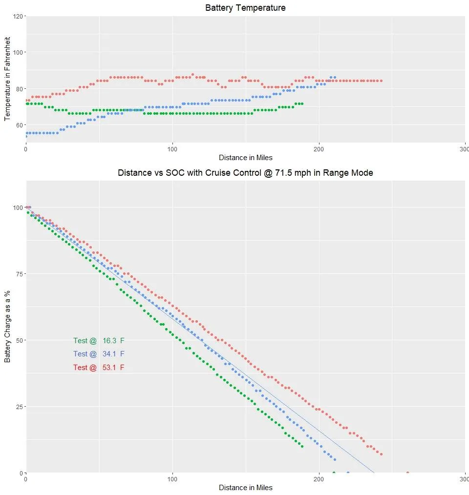

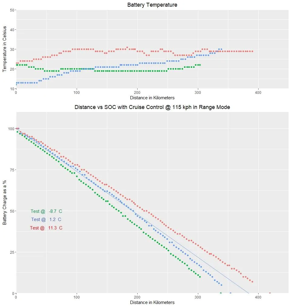

Charts 1 and 2 show a plot of the summary of results.

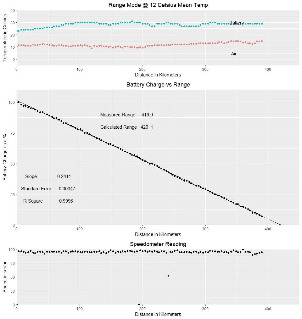

Chart 3 shows the results from this mornings run in metric.

There may have been a small wind effect on the results. The delta on the distance between the outbound and inbound legs was 9km/5.6 miles over a total distance of 379km/235.5m. Note this does not equal the total distance, just 90% of the distance travelled. The remaining 10% is my factor of safety which I burn off close to home.
Also the plot of speed is a little jagged as cruise control wasn't used, so reflects my fat foot.
The most interesting aspect was the battery temperature. It's hard to see on the plot but it looks like the BMS was trying to keep the battery temperature between 25C and 30C. There were periods when the air temperature was rising and the battery temperature was falling. The next run should provide additional incite as the temperatures will tend to push the battery above 30C. Unfortunately or fortunately depending on ones point of view, I will never see the kind of temperatures reached in the South West US, so I will probably never see the battery stressed at high temperatures.
Hopefully I will be able to hit the sweet spot where range is at maximum. There are tests around 290 miles out there and it would be interesting to see that in detail. Also how big the sweet spot for the best range is.
