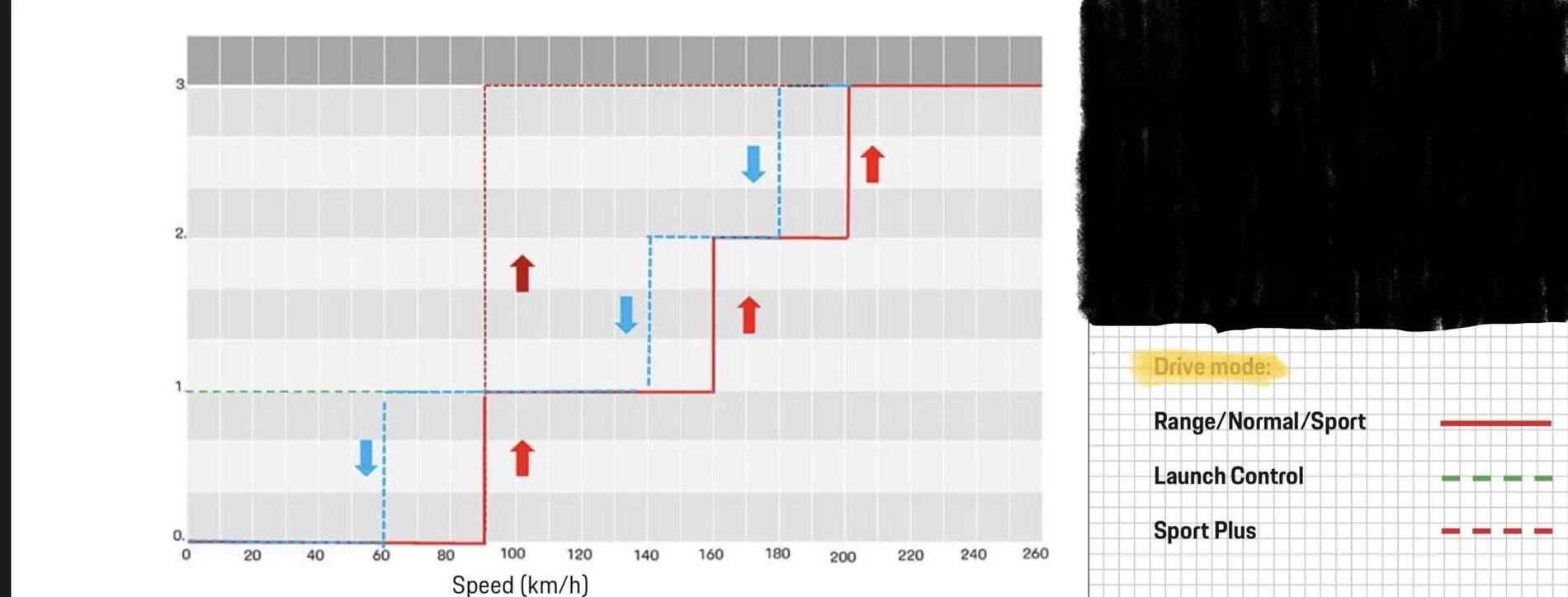

I have seen this before but it's not consistent with my observations of the indicator on the instrument panel:
1. I have never driven past 180km/h
2. I have only seen the indicator light up in cleaning mode / range mode and sport plus mode.
3. The indicator lights up whenever I reach 90km/h in range and sport mode.
Njsimons13
Jason
Mar 20, 2021
84
New York
Taycan GTS (on order), Taycan 4s, Q8, SQ5
It’s raised in sport and sport+ it shows on the instrument cluster when its raised right next to ride height icon. I’ve noticed that it doesn’t raise in normal or range mode. That’s raised about at 60mph.

Oink
Sep 8, 2020
364
257
Norway
Taycan 4S+, M3P
it doesn't in normal, but does in range (90kph).
