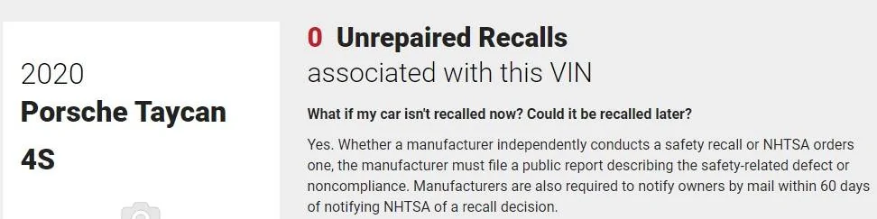

Just curious, if you search your VIN, does this recall show up on it or no? NHTSA site says 45 complaints and 12 recalls related to this. My VIN does not trip these recalls.
mikestyle
Jul 6, 2022
Canada
997.1 Turbo + Taycan
My car is Canadian, so I'm not sure its accurate. Is there a Canadian NHTSA equivalent?
