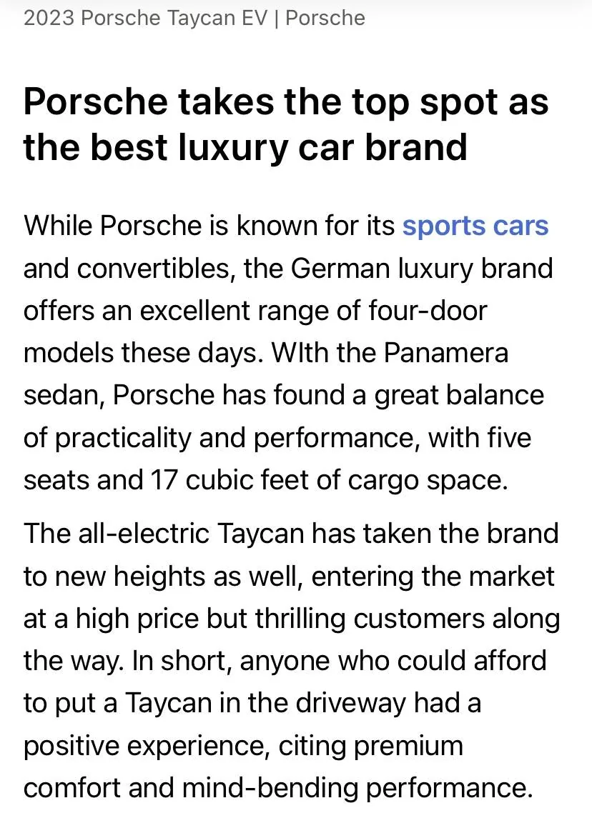

100,000+ Taycans on the road over the past three years. How many reports of accidents have there been due to those issues? Zero.
And based on the repeated polls on this site, what percentage of Taycan owners have had no significant issues whatsoever with their Taycans and would buy one again? IIRC, the last one was about 90%.
So please explain to us how Porsche is ‘marketing’ cars with serious problems. Overreact much?

I’ll end by leaving this tidbit from an article from US News and World Report today about Porsche taking top luxury brand honors…

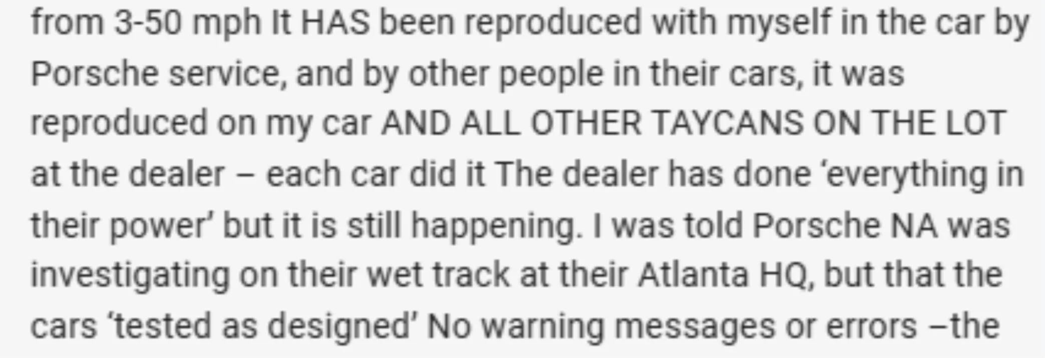

Couple of things of interest to me from the OP.
Firstly, the incident happened in Nov 2021.
Has the report only just been made?
Secondly, I find it really hard to believe that the dealer took all the Taycans on their lot out and they all did the same thing.
How many Taycans and name of dealer would be helpful. See if they agree.
Agreed - would love to know the dealer. If they were able to reproduce the problem on every Taycan, seems it should be doable for Porsche themselves too?
