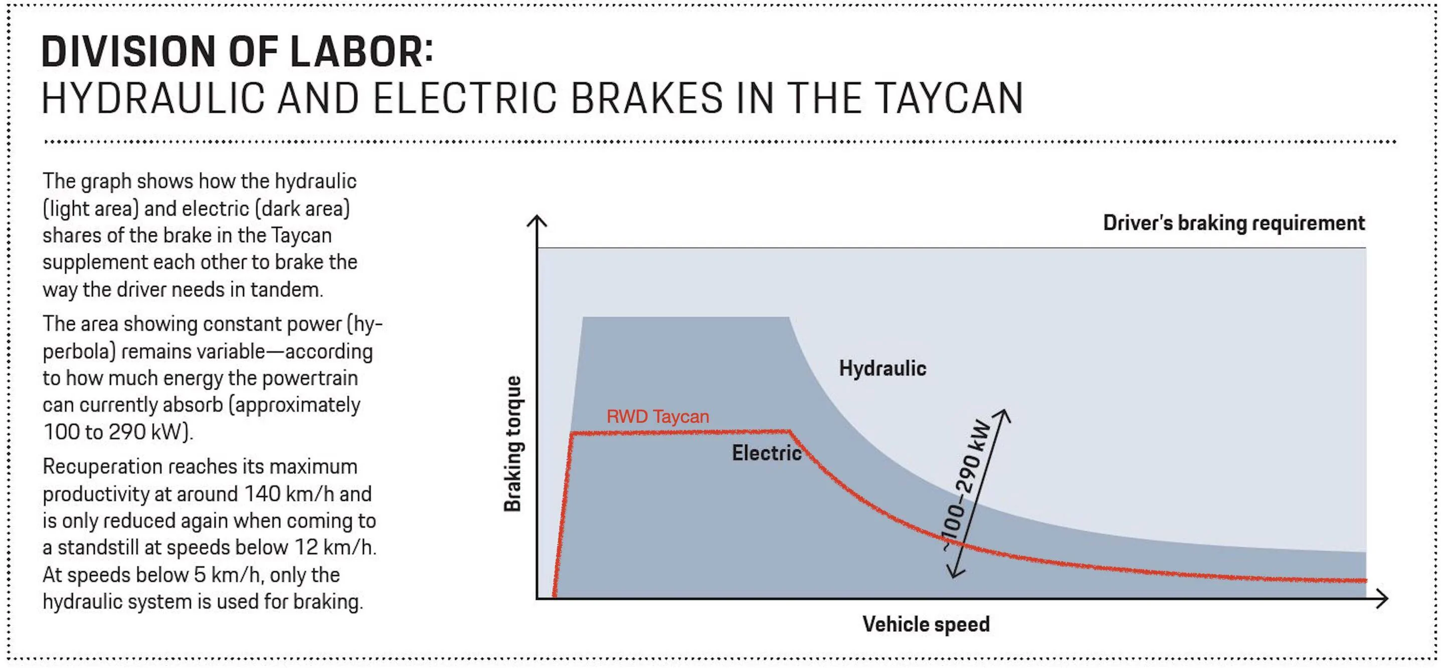

I am not surprised, what with weight transfer on a 50:50 weight distribution car it is natural to use front brakes more than rear, it could easily be more.
Usually bigger discs and calipers are used at the front on any car.
I have often noted that I haven’t felt 4WD necessary on any car until the EV and entirely because of this.
I don’t know how they deal with it on the RWD, maybe the system uses only braking at the rear as long as locking isn’t close, so only using the fronts for heavy braking but maybe it uses the discs and pads all the time.
I think what RWD blending strategy expressed in this chart would be something like this red curve. In other words, you'd have to brake with less input to recoup the same amount of kinetic energy. It'll be interesting to draw this chart whether the car is in 1st or 2nd gear. I suspect there should be a DC shift in the curve as a function of the gear ratio.

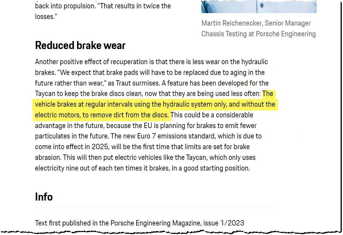

The cast iron discs will get rust on and that is why regenerative braking is off for the first mile or so of a journey, allowing the pads to clean up the discs.
Also, according to the OP linked article "The vehicle (Taycan) brakes at regular intervals using the hydraulic system only, and without the electric motors, to remove dirt from the discs. "
Where does it say all of the above ….just wondering? including the first mile bit 🧐
