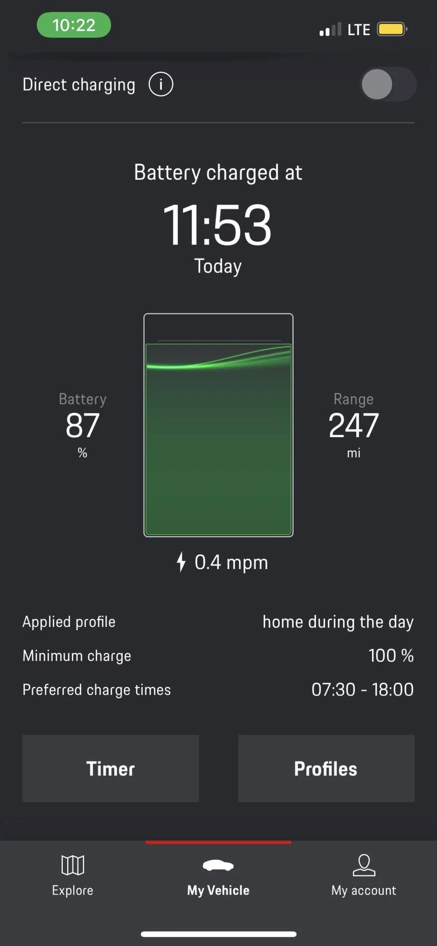

I have solar and want the car to be fully charged during the day. I created the attached profile.
the moment I plug in the charger it starts charging no matter what time of day. It seems to ignore the profile. What am I doing wrong? Thank you in advance
It charges to your profile min immediately. It charges to 100% during your preferred time. You need to set your min to 25%.

What is the trigger then to charge it full?
Thank you in advance!
ukleinschmidt
Uwe
Oct 1, 2021
93105
Taycan 4s
The preferred charge times.
Mine has been paused since I modified the minimum charge. It is not full and I have been in the preferred time window for 5 hours now. I would assume it charges full at the earliest during the time window. Not so. Thank you for your help.
actually clicking on pause tells me it is paused because of a programmed departure time. I never programmed any. More research needed. Not for 6 year old that is for sure
I don’t normally use the preferred charge times, but I did test everything to confirm my understanding of the manual.
During my testing, the car charged to the minimum and then waited until the preferred time to continue charging.
Maybe post more pics? That usually helps more because I can see what’s actually happening. ?
