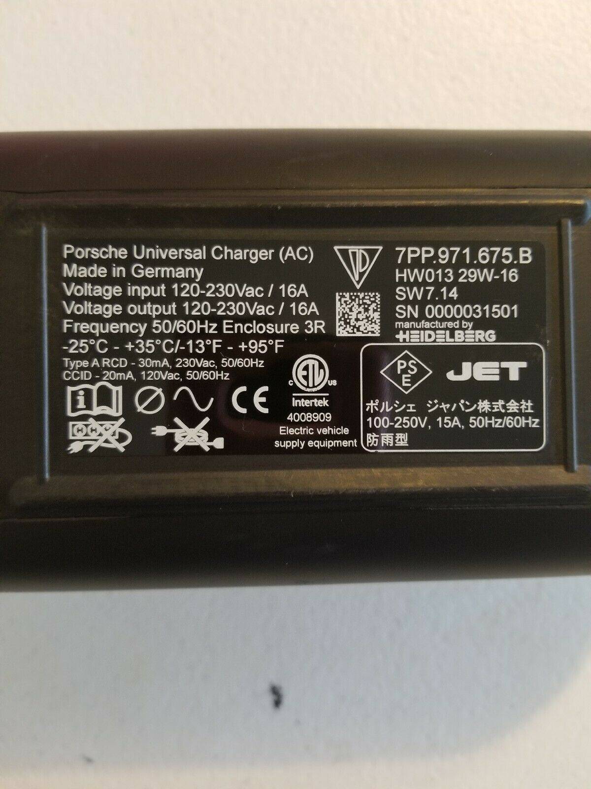

according to this -
Porsche Taycan Taycan charging with low-end plugs s-l1600
it can take 120v 16amp input, and i believe this is the same charging kit that comes with the Taycan, have you tested it on your car?
if you are looking for 16A 120v i have one in my garage and i'll be happy to host you for a quick test, i'm at San Jose as well.

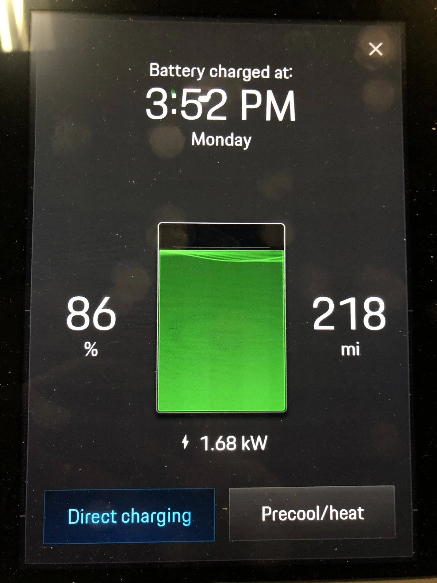

confirmed - Taycan will charge at 120volts/16 amps if you plug into an EVSE that supports 120 volt 16 amp charging…
the picture below shows a 1.68 kW charge rate while using my Tesla Gen1 UMC with a NEMA 5-20 plug adapter - theory on 120 volts at 16 amps (20 amp breaker) is 1.92 kW - charge rate below shows 1.68 kW charge rate - which is bigger than the maximum 1.44 kW charge rate from a normal household 12 amp circuit (15 amp breaker)…

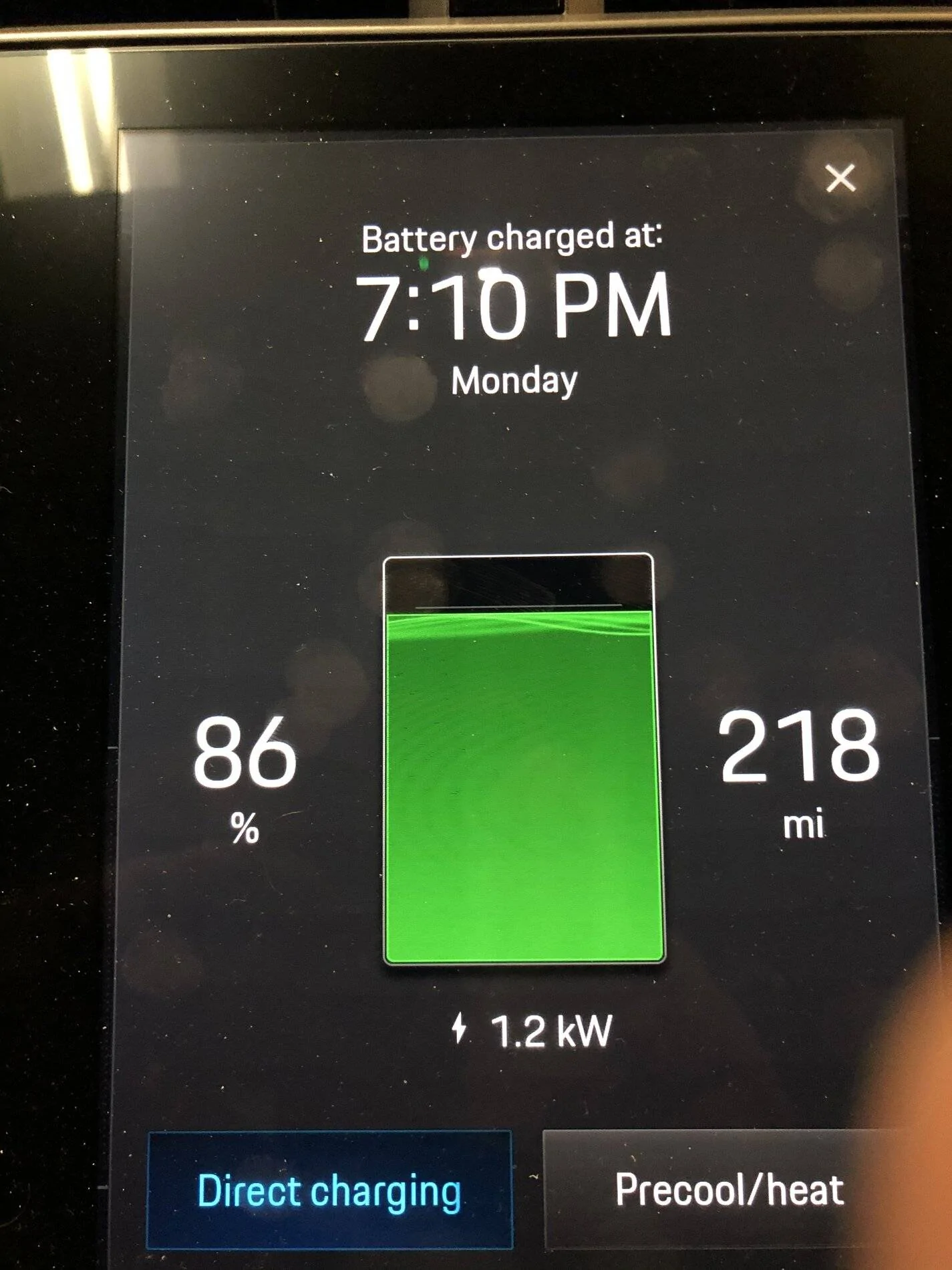

charge rate from a normal household outlet via the same Tesla UMC with a NEMA 5-15 plug adapter is 1.2 kW - or right in line with expectations for a 1.44 kW maximum circuit load.

why is this news? Well some EV manufactures (I'm looking at you CHEVY Bolt) limit their charging to 12 amps even when presented with a EVSE offering 16 amps or more on 120 volts…
is this life changing? NO! - but if you think about it 1.68 kW vs. 1.22 kW (observed behavior) is about 40% faster charge rate - and I've done it with my Tesla's over night trickle charging on a NEMA 5-20 plug I've found on outside walls on Hotels - you can get a surprising amount of power overnight for 8-10 hours at 1.68 kW (16.8 kWh for a 10 hour charge) which is 20% of the Taycan's useable capacity while you sleep…
also for those limited for their home charging scenarios a NEMA 5-20 plug offers at substantial improving in overnight charging capacity - or about 50 miles range for overnight 10 hour charge vs. 30 miles for same amount of time at NEMA 5-15 rates…
