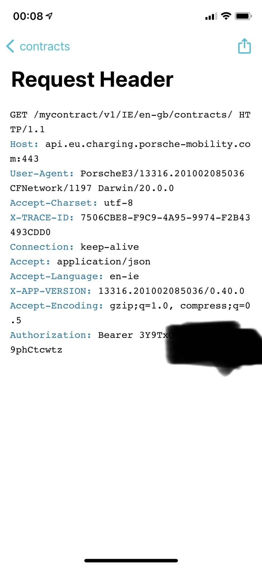

Okay, thx. That probably is a symptom of me not giving the library enough attention and Porsche changing some of their APIs since I last looked at them. On the list.That did indeed solve the issue!list-vehicles
responded with my type & vin#, however when i runshow-summary
orshow-capabilities
(giving the vin provided as the third argument) it responds withError: AuthFailure
