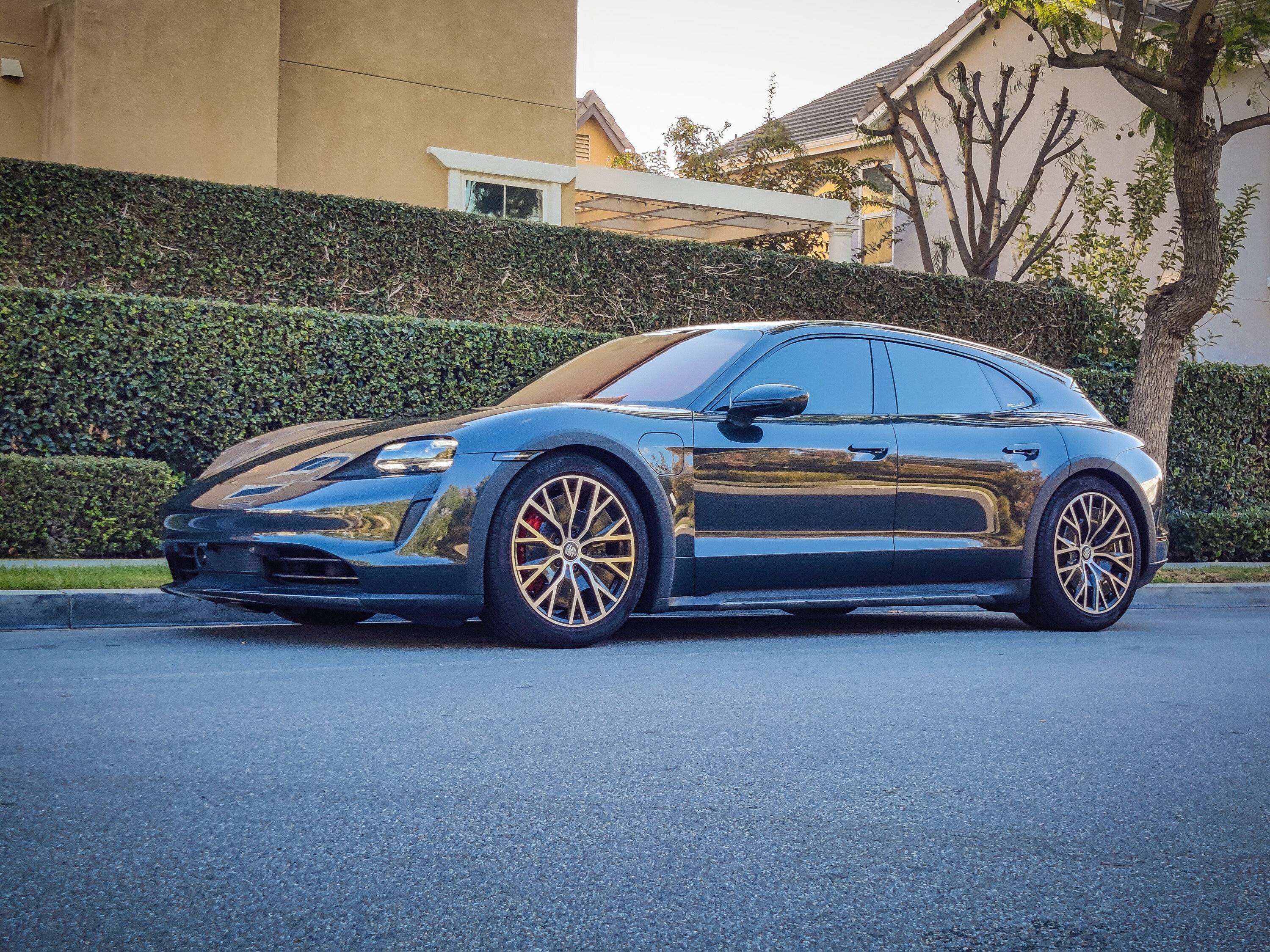

Got my VR air suspension lowering links installed by a local independent shop. Dialed in a conservative drop of 6mm or so just to bring the ride height more in line with the stock sedan ride height and not compromise ride quality at all height settings in any significant way.
https://www.vividracing.com/-p-1534...5sfdvnX70nlpVM_oIkXkxciF3BQK-tn4aAusgEALw_wcB
After getting the height adjustment fine tuned in all 4 corners and wheel alignment, loving both the ride and updated ride height, seen here in its lowest position:

It’s only 6mm more than standard?
I think he means the lowering links were adjusted 6mm. That equates to about 20mm in chassis ride height change.
Also the lowering links he linked to are the FVD brand links. VR (Vivid Racing) also has house branded links that are of lower quality and I wouldn't recommend them, having purchased them myself.
Car looks good @Kayone73!
Correct I had a mild drop dialed in on the lowering links to match the wagons rode height to the stock sedan ride height, I have no need for the slammed look or to ruin my ride quality

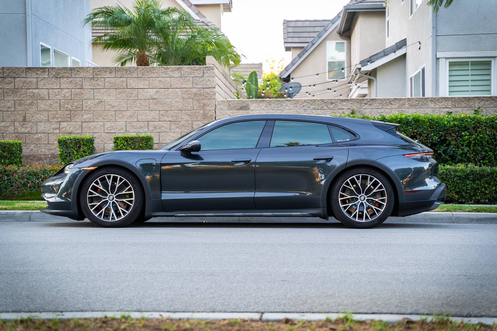

it looks in some of the photos like your wheels are gold/aurum. Suits the car really well!
