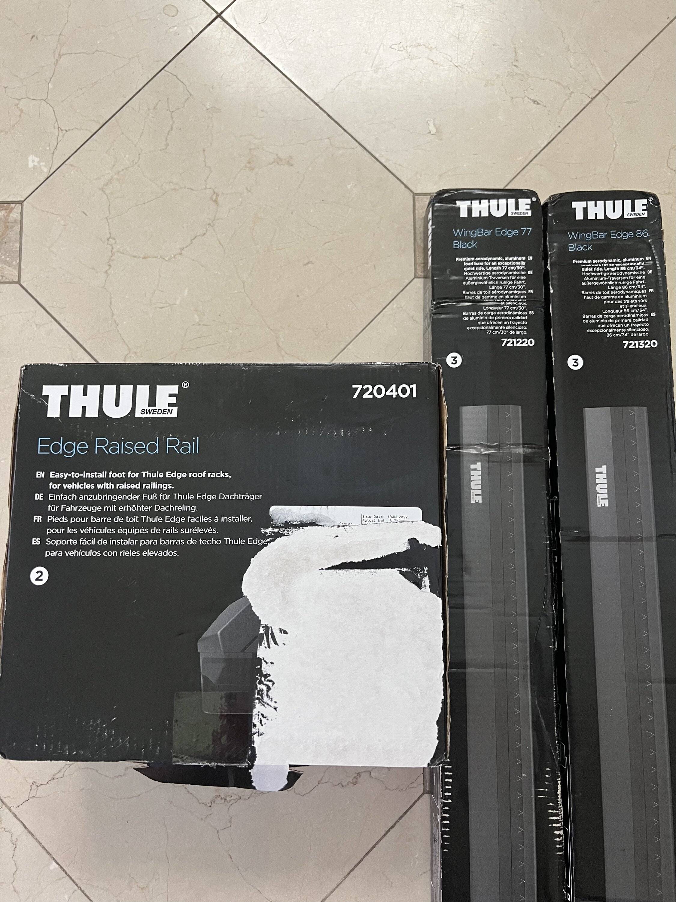

Looks great! Do you know which width is correct for the wing bars?
I just ordered a set from Thule, their site recommend 86cm and 77cm bars for the CT, will find out later this week when they arrive.

Interesting, I have a set for my Cayenne which I'm hoping will work with the level of width adjustment on my CT, when it arrives, but I fear I might have to buy the narrower one for the back.

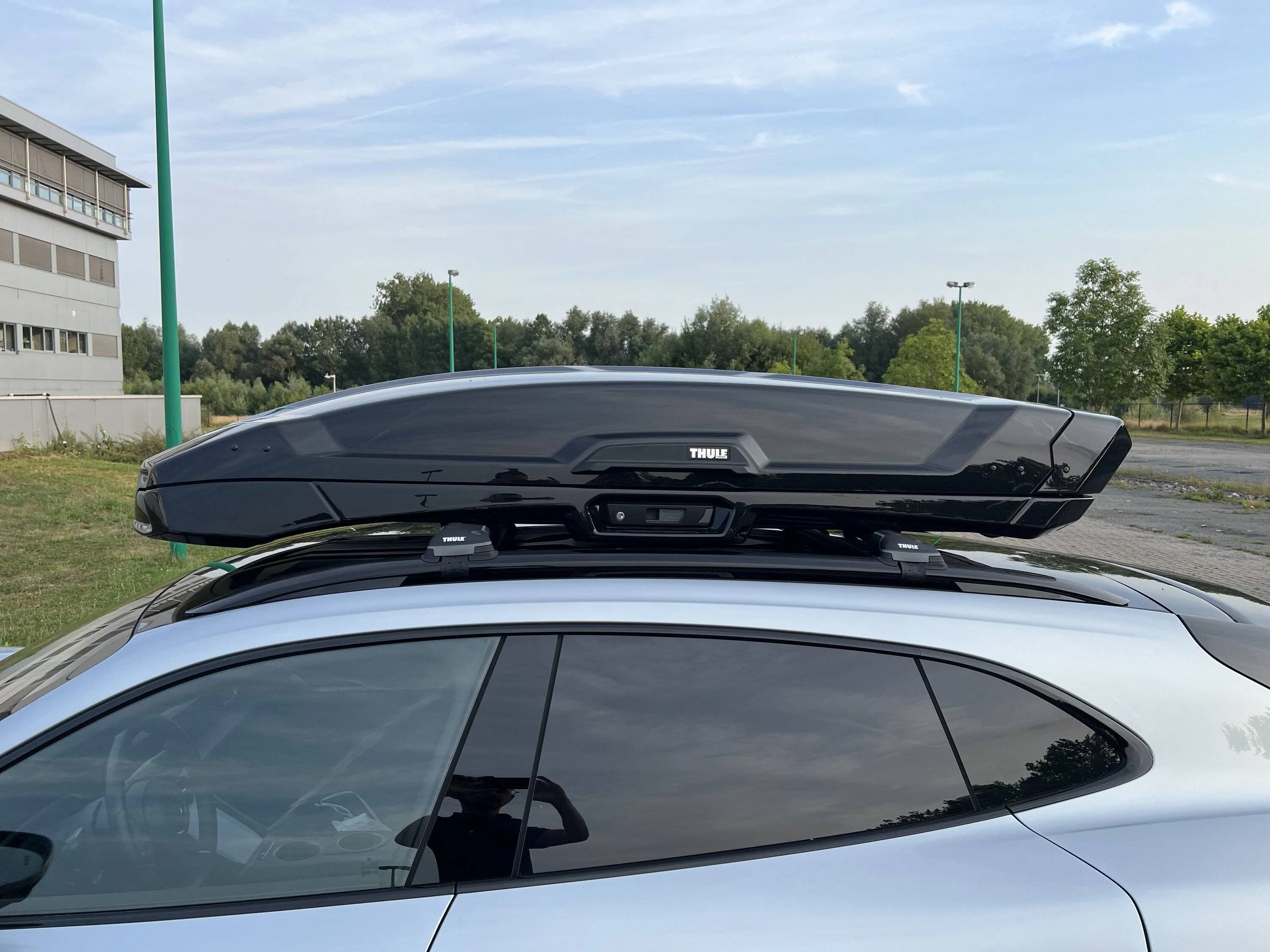

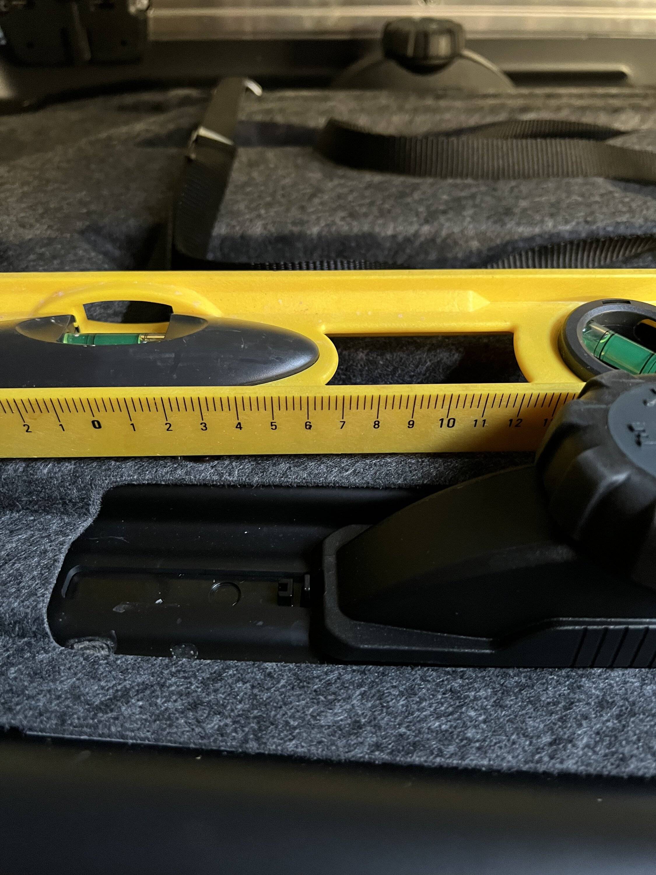

The box and bars have been on my roof for a couple of days now. Without anything in it.
Checked again and in the rear I can not get my finger between the glas roof and the clamp. It is maximal 1 cm now. I hope i doesn’t lower when loaded and hits the roof when driving.
I have seen others with the same Thule bars and Thule box / Porsche performance and don’t think anyone had an issue with the clamp hitting the roof.

Are you saying the box and bars moved further back?
No down. I had the impression that when I put them on I could put my index finger between the roof and the tip of the fixing claw if the box. and now I cant. I mesured and I could just fit a 1 cm thick book between the claw and the roof. It’s probably enough and I don’t know how much it will vibrate / move while driving on the highway.

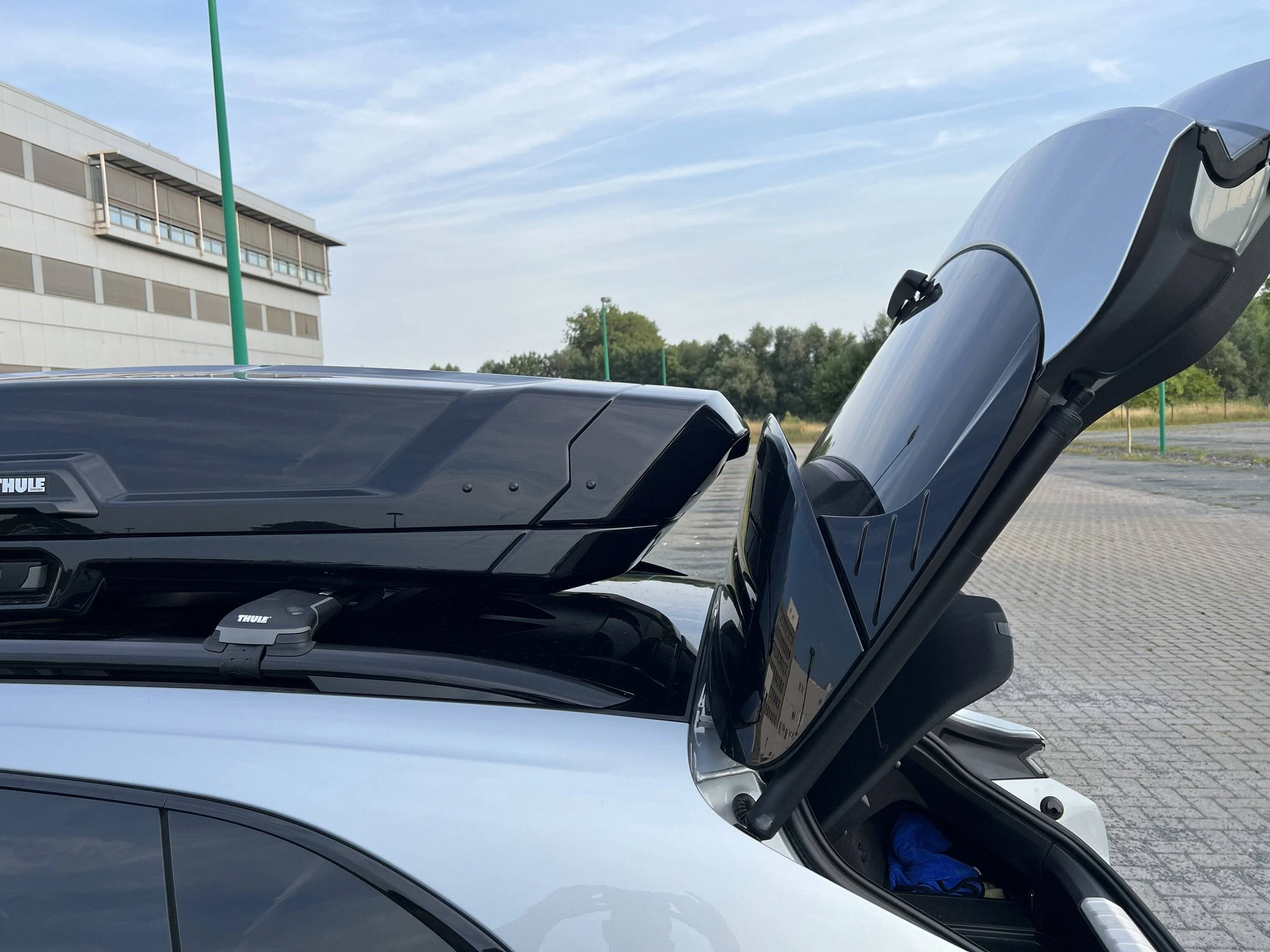

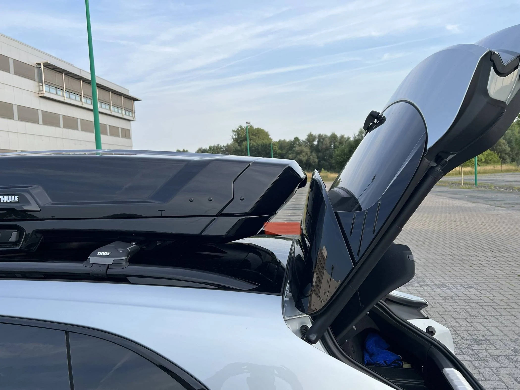

I've got the Wingbars as well and planning on getting the Vector Alpine which needs 6cm more clearance in the back when the trunk is open (compared to Vector M). Could you kindly measure whether there's enough space for the Alpine when the bars are installed as you have them now?
I just checked but my box is shifted nearly as much forward as possible. Just found out now, I put it like this for the trunk to fully open. If the Alpine comes 6 cm more distally than the M you will have a conflict. If you want I can measure the distance between the rear clamp and the back of the box.
I think the M fits perfectly to the length of the roof. Why do yoy want the Alpine. It just has the advantages to be able to put in longer skis. Most skis are not longer than 1m85 anyway. I first thought I wanted the Alpkne to but changed to the M. The L is higher.
You can also program the hatch to open less off course. But that won’t be very practical to acces the trunk.

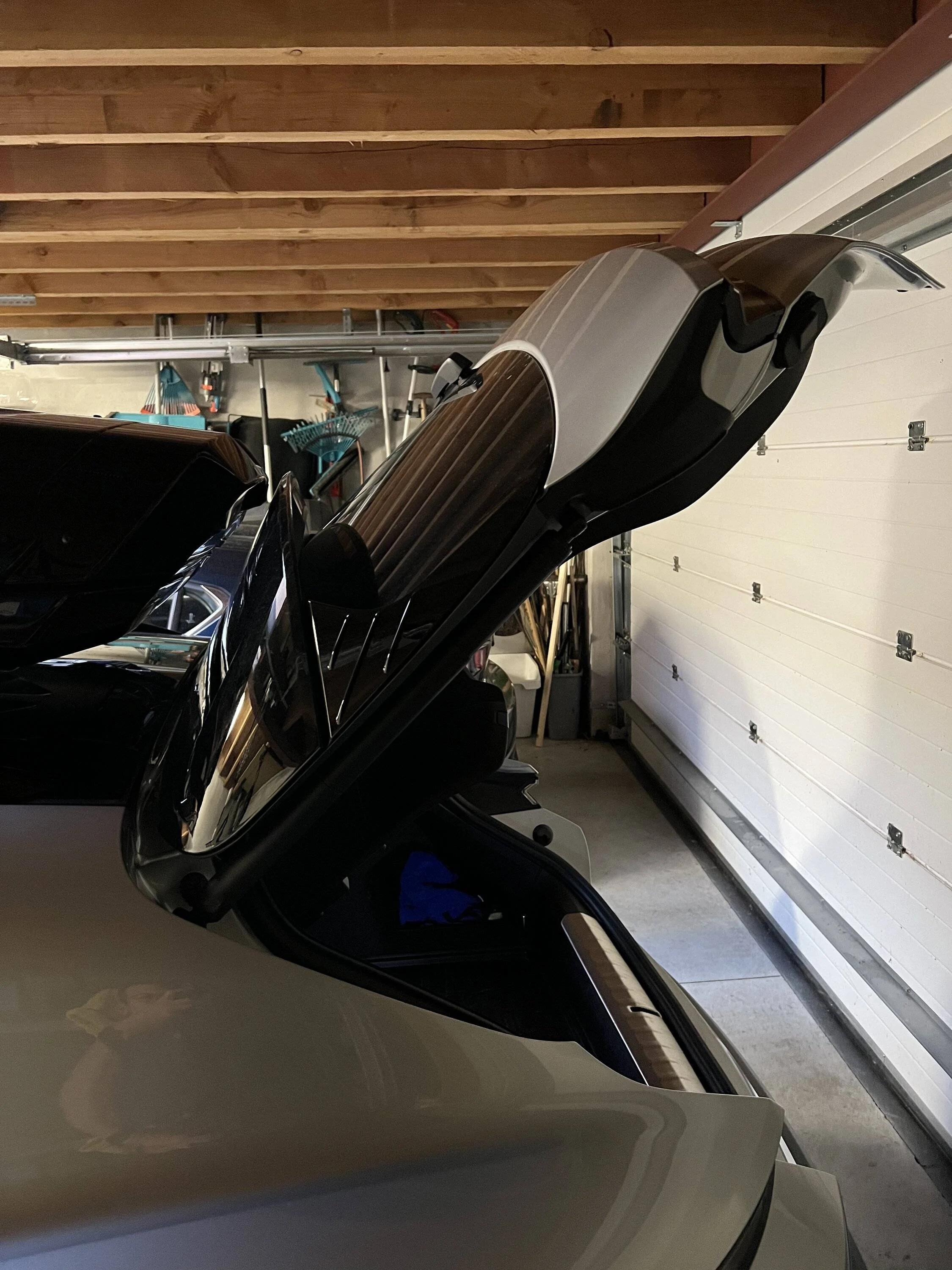

After reviewing the pictures I made I think it might be better to shift it a bit to the back to be more leveled. Thule also says in the instructions the more it is shifted backwards the better it is for wind noise.
So I shifted it back 7 cm and reprogrammed the tailgate (put it in desired position and hold close button for 3 seconds). With this opening it is still ok to acces the trunk, fully opened is easier, but it’s ok for the holidays.
