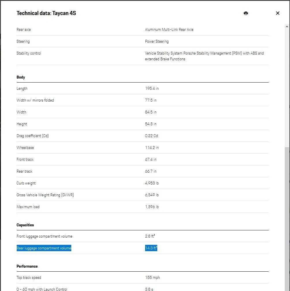

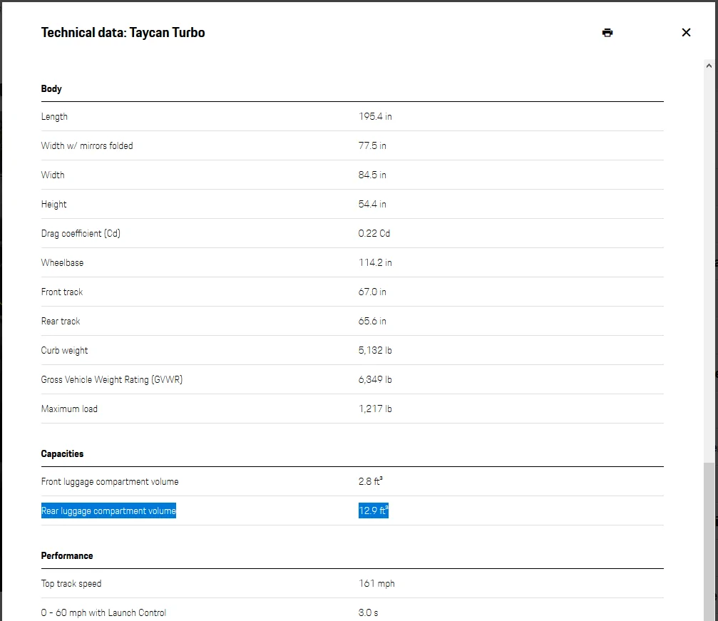

I think the rear motors on all models are the same and just modified by software and Porsche is just naming them differently. It would be cheaper to just built one type of motor and modify it’s software rather than built 2 different types. Just my 2 cents. We will find out when someone will take them apart.
The rear motors between 4S and Turbo/Turbo S have different hardware with different physical sizes.
This is the reason you find on the last page of the configurator for the technical data different "Rear luggage compartment volumes" for Taycan 4S on one side and Taycan Turbo/Turbo S on the other side.
EDIT: MAYBE MY STATEMENT HERE IS WRONG AND PERSUADER ON THE FOLLOWING PAGE IS CORRECT, THAT THE DIFFERENT REAR LUGGAGE VOLUME IS RELATED TO THE STANDARD/NON-STANDARD BOSE SOUND SYSTEM AND NOT TO DIFFERENT REAR MOTORS. THE REAR MOTORS ON TAYCAN 4S ARE 80mm (3.1") SHORTER IN LENGTH AND HAVE LESS WEIGHT COMPARED TO TURBO/TURBO S, BUT MAYBE ARE NOT THE REASON FOR MORE REAR LUGGAGE - I WILL TRY TO FIND OUT MORE DETAILS ABOUT THIS.
1. Taycan 4S with larger "Rear luggage compartment volume" of 14.3ft³
Porsche Taycan Taycan information direct from Zuffenhausen plant tour Technical_Data_4S
2. Taycan Turbo/Turbo S with slightly smaller "Rear luggage compartment volume" of 12.9ft³
Porsche Taycan Taycan information direct from Zuffenhausen plant tour Technical_Data_Turbo
Around 10% more rear luggage is one of the very few advantages (besides price and range) you will get for a Taycan 4S compared to Taycan Turbo/Turbo S!
