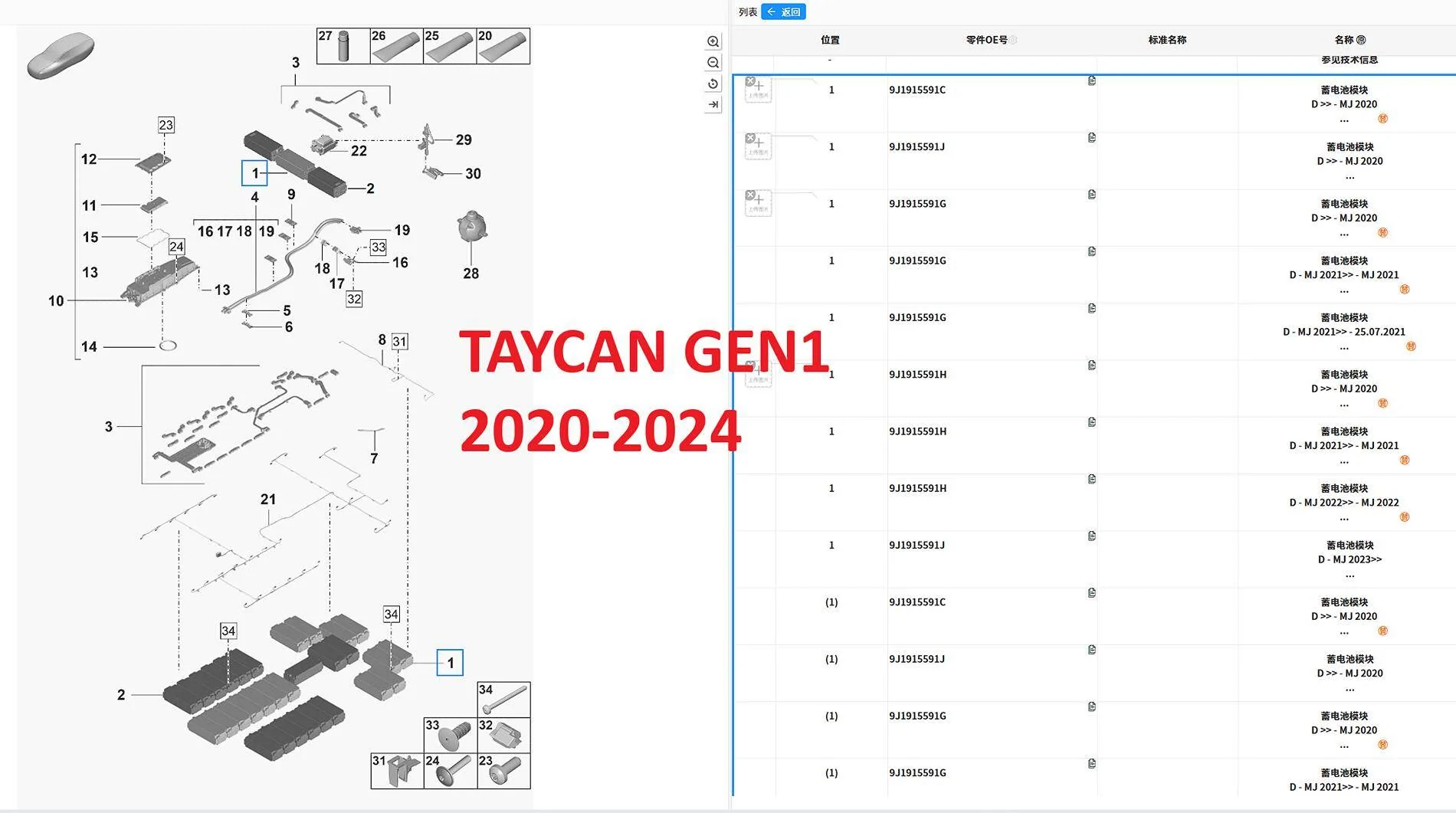

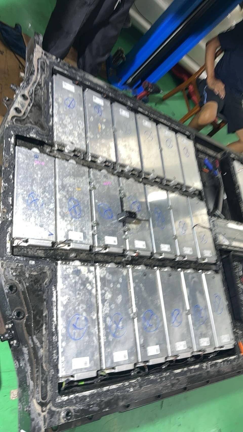

Porsche Taycan "Taycan lets you drive with shorted out battery modules" 1745345609001-d0
Porsche Taycan "Taycan lets you drive with shorted out battery modules" 1745345713068-2d

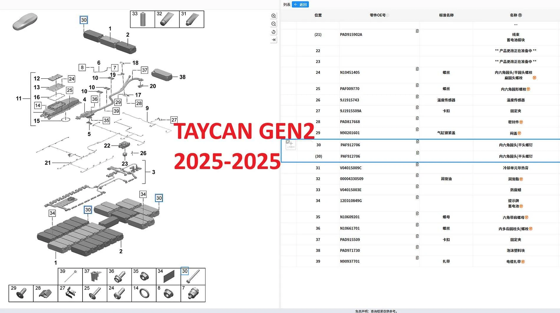

Modules for Gen1 Battery: 9J1915591C/G/H/J
Modules for Gen2 Battery: 9J1915602D/E/F
The new modules have an improved chemistry, but it's essentially the same format and same architecture.
The new battery has remarkable improvement tho:
Porsche Taycan "Taycan lets you drive with shorted out battery modules" 1745345991068-ho
This thing which looks like a module is not, it's there to absorb humidity.
Which in the previous battery humidity is absorbed under each module by the liquid thermal interface under each module. Makes the situation I'm reporting on this thread much much worse. So a good change by Porsche.
