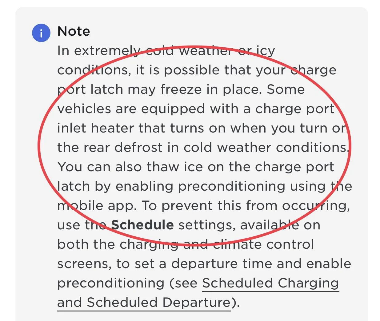

Whilst we’re on this topic, does anyone know if Porsche fit a heater around the charge port to stop the cable from freezing to the connector in ultra cold conditions?
simcity
Sean
May 22, 2022
1,348
1,146
Suffolk, UK
'23 Taycan Turbo, Eletre R (on order)
Be good to know if Porsche did similar….not that it’s necessarily Nordic here, but I do get frozen windows / can’t open close door on the X if don’t defrost car before.
Not to the best of my knowledge. What they did talk about is that if the electric door release is blocked by ice/snow – it will detect it and increase the "torque" on the door motors while causing the door to vibrate to break off the ice and allow the door to open.
