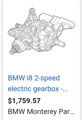

@ron_b I agree so much that I bought one ... my point is not a technical speech : from the customer point of view, promoters of Tesla are mad of this brand and promoters of Porsche are also passionate. listening to both of them, understanding what they love each, let's try a Taycan !
but we can't forget this part of history : tesla did first large quality EV production and it was appreciated (a little)
and BMW did the first 2 gears EV with the i8 from my memories
ron_b
Ron
Dec 30, 2019
978
776
SF Bay Area, USA
Bolt EV, Taycan 4S (Frozen Sched Oct)
Wow @2big2fioul I stand corrected, I was not aware the i8 had a 2 speed transmission also. ;) However, that was a hybrid vehicle, not a BEV.
