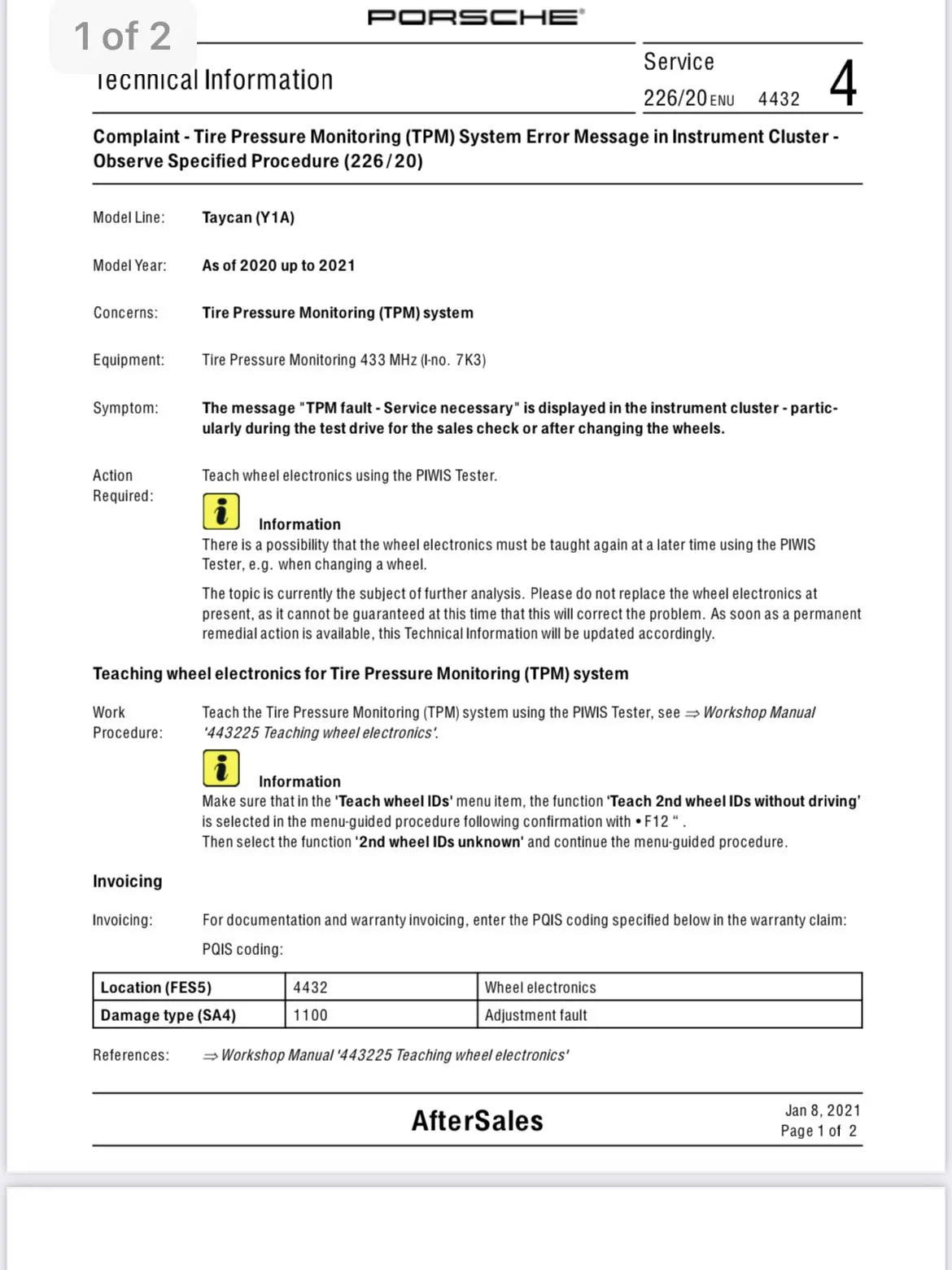

By accident I clicked a different set of wheels and straight away went back to the original summer 20inch. But the yellow light came up with a message that it will read above 25km. Unfortunately I have been driving and still no tyre is measuring pressure. What’s the best solution? Wait and keep on driving or get the TPMS checked?
How does Porsche reset the TPMS.? I saw someone’s post and he said they simply manual reset the sensors? What does that mean

Same problem for me today. How did you solve this issue ?

i had to take the car to a dealership where the connected it to the piwis and individually teach the tyre .
im attaching a Porsche technical report to solving this
hope this helps

Thank you Freakzilla9
I have an appointment tomorrow morning at my dealership.
