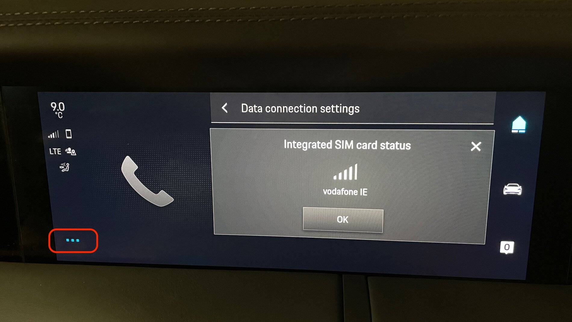

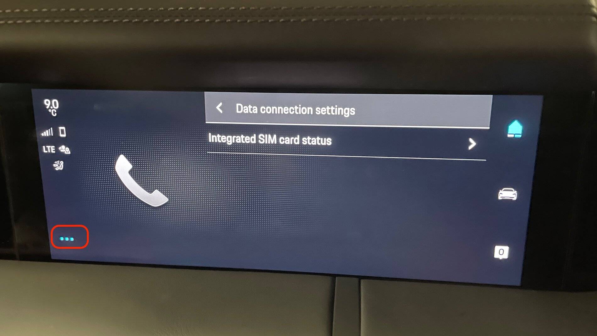

If you have a Vodafone SureSignal box then it might be worth trying to connect the ESIM from the car to it. You can confirm what network its using by going to:
Devices -> Clicking on the three dots (highlighted) -> Data Connection Settings -> integrated SIM card status.
Here is mine:
Porsche Taycan Taycan Turbo 2021 spec many issues similar to other posts. Do you think a joint effort may help get answers out of Porsche? IMG_0087
Porsche Taycan Taycan Turbo 2021 spec many issues similar to other posts. Do you think a joint effort may help get answers out of Porsche? IMG_0088
Confirming at least in Ireland - its using Vodafone.

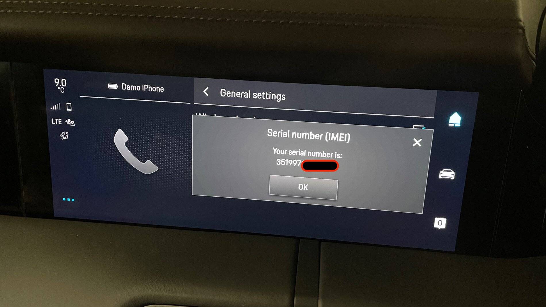

You can find out the IMEI number of the car from the same menu - which should help you register it on your SureSignal router:
Porsche Taycan Taycan Turbo 2021 spec many issues similar to other posts. Do you think a joint effort may help get answers out of Porsche? IMG_0086

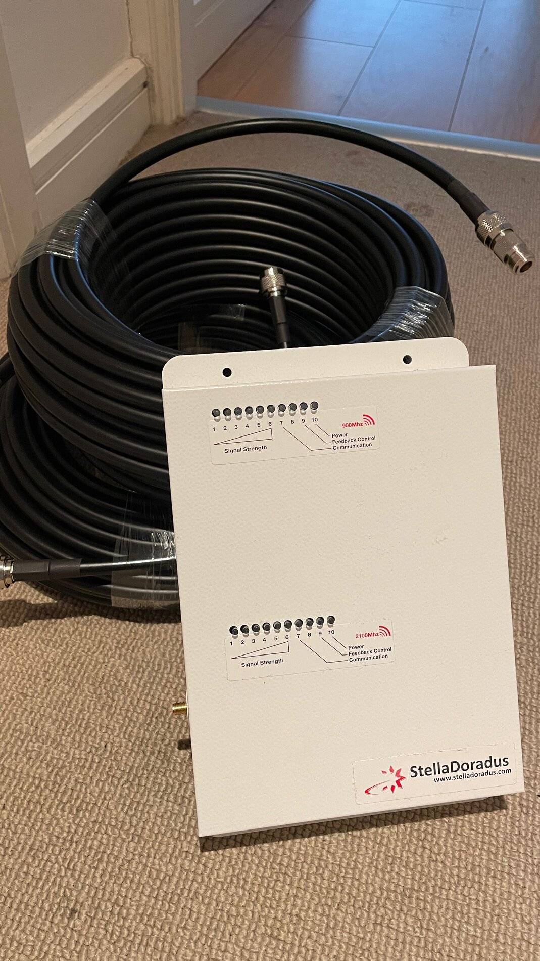

I have a similar issue in that my underground car park has no wifi or GSM/3G/4G signal - however, I am in the process of installing a repeater station – as I do have good signal up at ground level:
Porsche Taycan Taycan Turbo 2021 spec many issues similar to other posts. Do you think a joint effort may help get answers out of Porsche? IMG_0056
