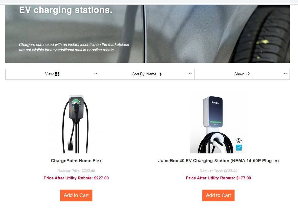

My utility gives a $.05 per kwh discount (approximately 25%) for charging from 11pm to 6am. The utility reads the power usage from the EVSE and currently they only support Chargepoint ($727.- retail) and Juicebox ($677.- retail).
So, while this Tesla EVSE is well priced, it would not allow me to get the utility discount.
Absolutely, different products are best suited for different applications. This particular charger is a very basic, no frills design charger, but with available load balancing (which is also a simple but reliable no-frills design). The benefit of such basic system is there isn't much to go wrong, but as you pointed out, doesn't offer the metering for your utility discount.
PS> Your break-even on the ChargePoint vs. this Tesla charger is about 6,240KWh, or 650 hours, or approx 18K miles range of charging between 11pm and 6am. Taxes and your driving style might change the math slightly. You start making $0.05 per KWh for any charging between 11pm and 6am after that.
Understood. But the utility is subsidizing (as they should to encourage EV adoption) the EVSE. This discount is good to the end of 2021. That said, I already have a Juicebox 40 from my previous EV so I don't need a new EVSE unless it has some great new features. The automatic load share might be the key feature for an upgrade.
There is a 30% tax back credit on the Homeflex up to Dec 2021 and includes 30% off any line/socket install if needed which is pretty decent and def brigs the ChargePoint (with many more features) back close to the price point of this basic Tesla unit - now maybe there is an equal tax credit on the Tesla? - have not checked.
