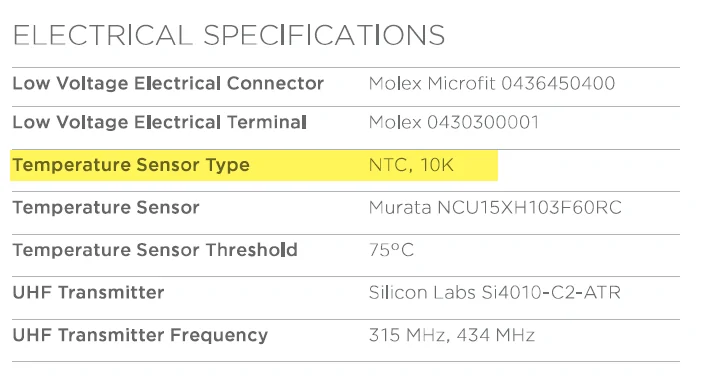

Related question, anyone digging through the specs (or other sources) found the beta parameter for the temperature sensor in the AC handle? The datasheet seems to be missing it.
ROFL - my PMCC power supply cable exceeded 75C in 65F ambient conditions 2 years ago - ROFL - if Porsche had the temperature sensor they would've shut down the charging session - viva PMCC w/10 gauge wire in a 40 amp supply cable.
but I digress…
@whitex has an excellent question.
