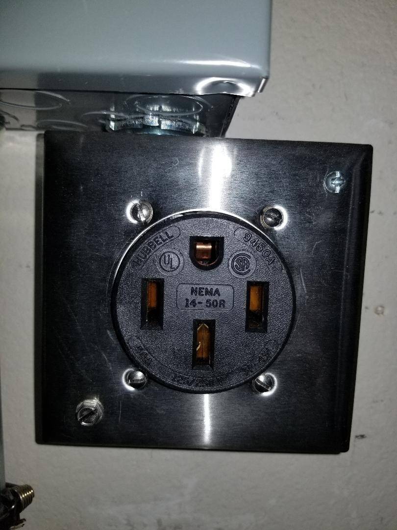

Follow-up questions having a 240v-60Amp breaker with NEMA 14-50 plug installed at the office. Can I use with Porsche Mobile charger connect with 60Amp breaker?

yes and no - nema 14-50 is 50 amps - the 50 in the name is plug/wire rating - so it will be fine but will only use 50 amps - so the 60 amp breaker is a waste in this circumstance - but it’s over-spec so it is safe
porsche charger is 9.6 kw only which is max power for 50 amp circuit

Thanks, really appreciate insight. I am trying to future proof as much as possible. Will probably add a Chargepoint Charger at office at some point (that is what I did at home) that will allow charging up to 50Amps.

if you are having the 60 amp breaker "installed" at the office- do the following:
1. install a 60 breaker
2. instruct electrician to install/pull/spec at least 60 amp wire
3. install a Hubble Industries NEMA 14-50 plug
this will future proof your install - such that when you upgrade to a ClipperCreek HCS 60 in the future it's a trivial swap to just remove the NEMA 14-50 plug and hard wire the ClipperCreek to the existing wiring inside the plug-box - no new breaker, no new wire - should take less than 2 hours - even maybe less than an hour.
60 amp breaker is the maximum power a standard Taycan can charge at - 48 amps charge rate off a 60 amp breaker is about 11.8 kW charge rate.
