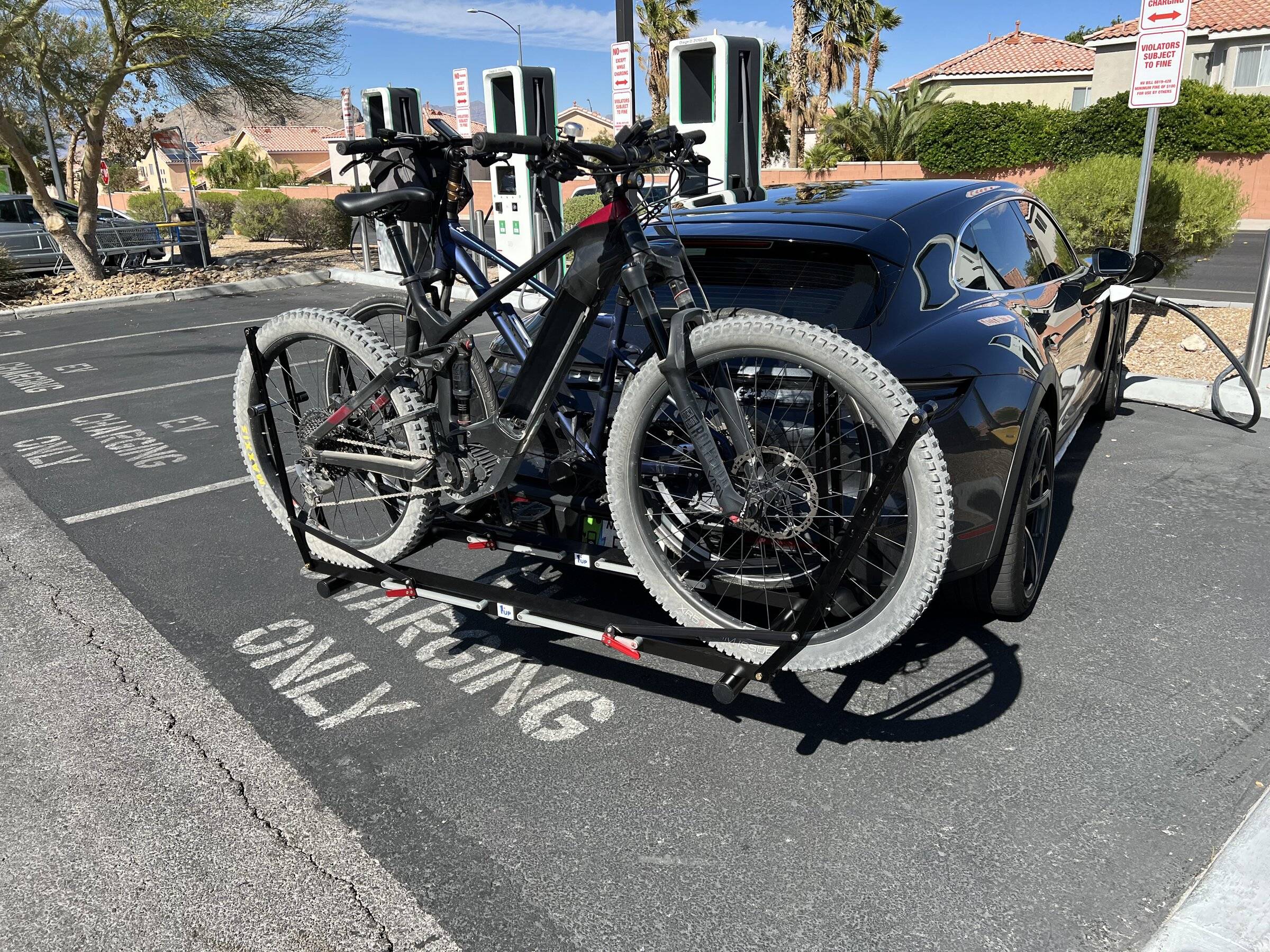

I just want to share the build of the bike rack. I took the design from bsclywilly and it was not too tricky but spent some time in the mill and CNC to make it right. I think the length Of the bars is 29 inches excluding insert after I shaved it.
This is a very simple design and the only issue it that the front wheel of the bike is oscillating while driving the car. I will attach the front wheel with a strap to the bike frame and it should stop the vibrating movement.
I also use the electric plug on the trailer connection and it works well as you can’t open the trunk by accident and scratch it on the bike’ pedal.
It is very simple to mount on the car. I time less than 4 minutes to unmount it once the bikes are unloaded. The beauty is that the design takes very little space in the trunk once I set one of the seats flat. The 1UP racks could have been lighter but not that bad. The single screw per side is very easy to tight from the bottom.
Actually, I’m happy that I never get the big and heavy bike rack from Porsche. I'm wondering how you can store it in the trunk as it may take all the volume of it.
Anyway, big thank you for your perfect and simple design.
It can be checked here: Custom Rear Bike Rack Installed with 1up Trays | TaycanForum -- Porsche Taycan Owners, News, Discussions, Forums

Awesome that it worked out for you! Nice work!!
You can push down on the wheel locking bars quite a bit to make the bikes more secure. I’ll usually have the tire compressed a fair bit, like 1/3rd of it’s height. That should reduce any wobbling. On skinny road bike tires I tend to see a bit more wobbling I think due to the smaller area in contact.

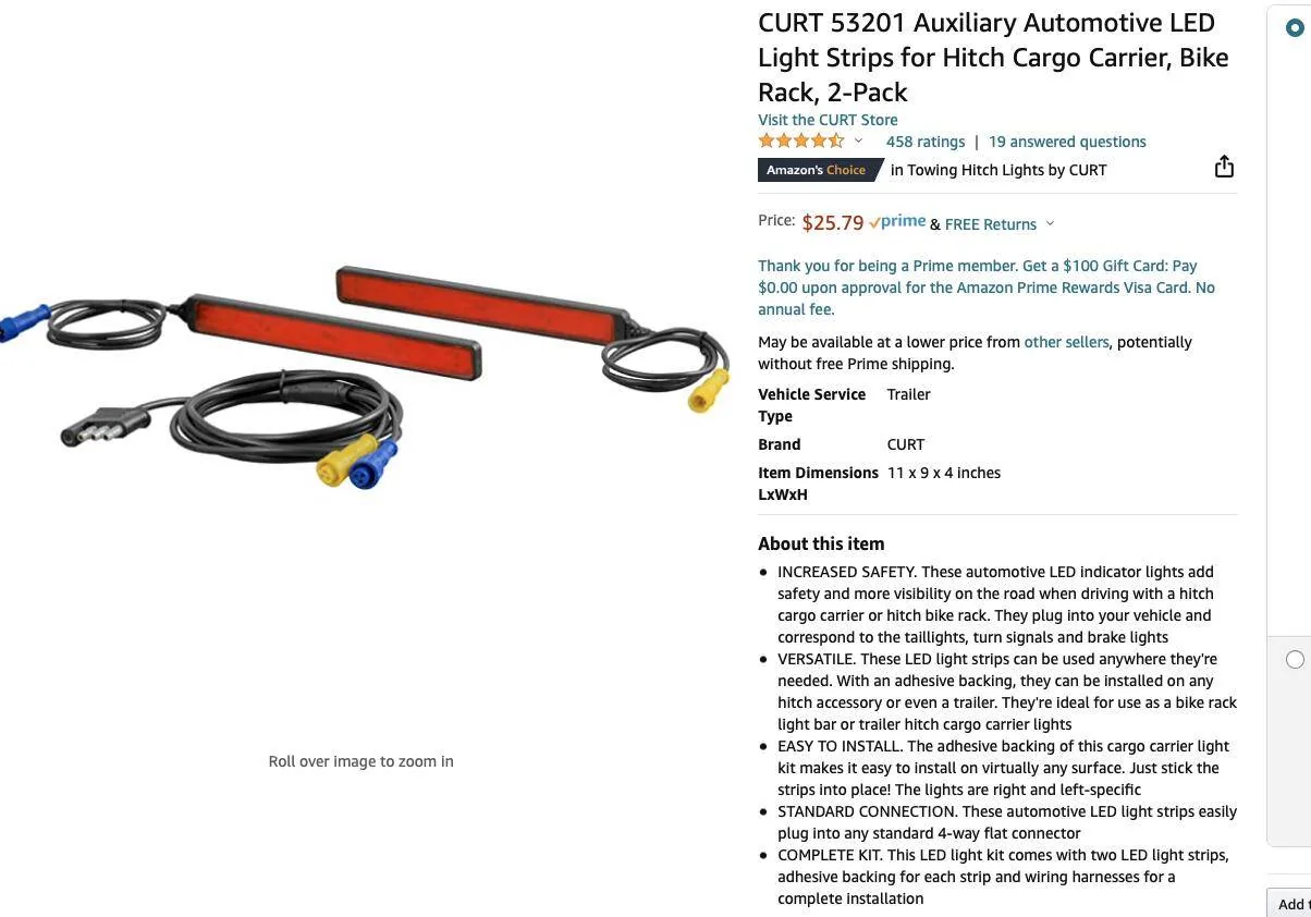

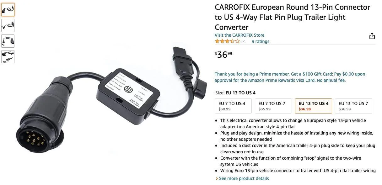

Whilst indeed not as onerous in the US (you can still see the main car lights albeit obviously partially obscured) I'm not entirely happy having no lights back there either and so I went ahead and bought this simple easily installed setup for the rack - has built in LED running, brake and indicator lights and use a std plug - have an extra reg plate too that I will add also.
HOWEVER I have yet to test if it actually works :), as car still in custom shop but will report back once I do - if fails then it would be a rel. simple pin to wiring fix that I would likely rely on others to solve (not my expertise) if it doesn't or look at a multitude of other cheap fixes!
